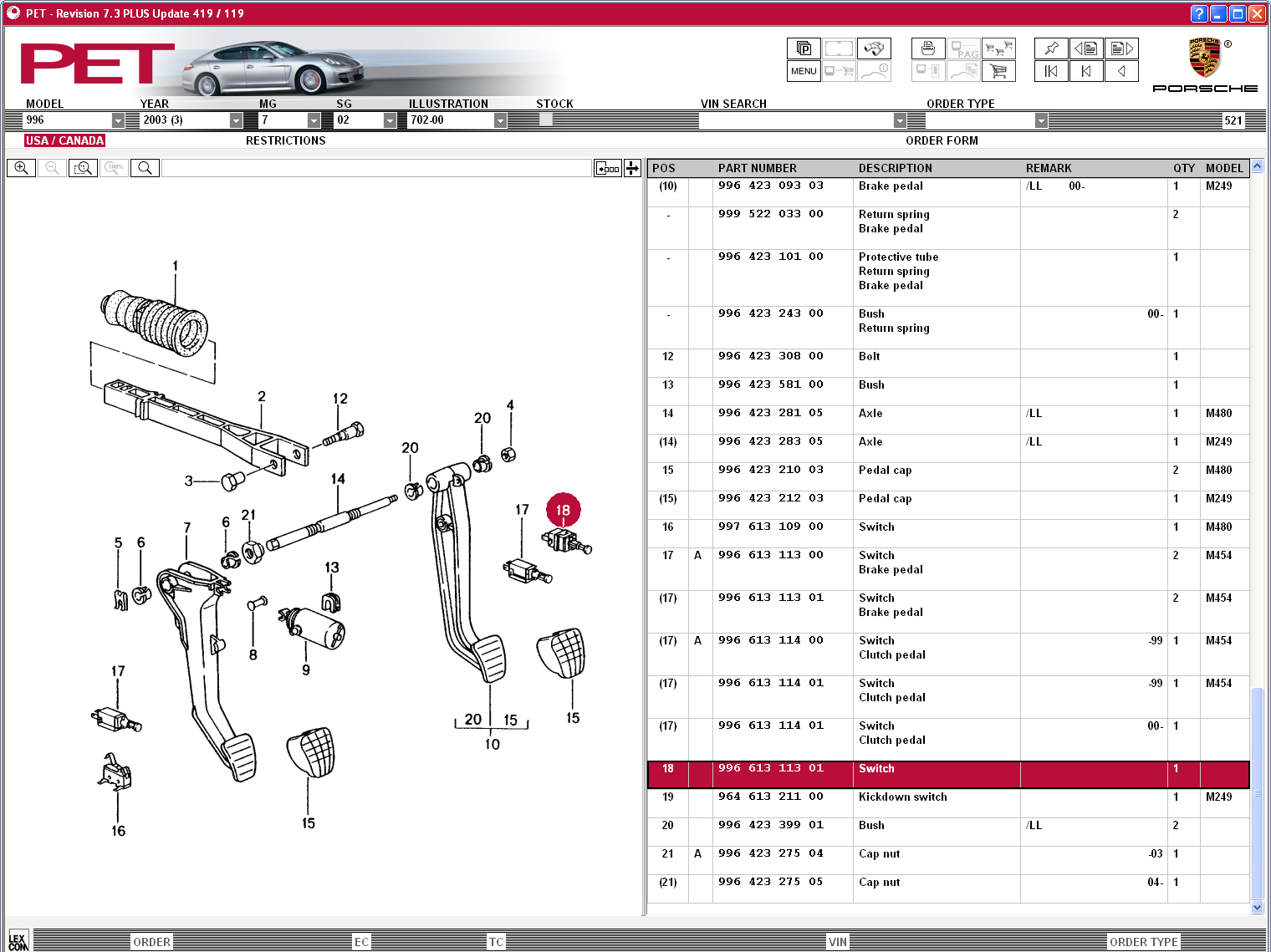

There are two switches on the brake pedal.  One is for the brake lights, the other for the cruise control.  Make sure you are working/replacing the right one.  See here http://www.autoatlanta.com/porsche-parts/hardparts.php?dir=996-99-05&section=702-00
Hi Joe, are you sure? Mine (MkII) has a single switch on the brake pedal and two switches on the clutch pedal - one for cruise control and one for starter interlock.
Two switches on the brake pedal - one for brake lights and one for cruise control (if you have that option).
Two switches on the clutch pedal - one for clutch disengage and one for cruise control  (if you have that option).

That's interesting, Loren. I have cruise control but has a single switch on the brake pedal with 4 wires going in. The wiring diagram indicates that single switch feeds both the brake light and the DME/cruise control module (SPDT contacts inside the switch for the two circuits).

Hey Ahsai!  So I was going by the parts listing...but...you got me to thinking so I crawled under the dash and looked.  I have cruise control and I can see only one switch on the brake pedal.  Go figure.  99 C2  So I think in our cars the cruise control detects the  brake application from the single brake lamp switch, which also explains why when the bulbs are burned out the cruise control doesn't work..

I also crawled under the dash last night just to make sure I'm not crazy :) I also have one brake switch. It makes sense because from the wiring diagram, it's clear that the single switch controls both the brake light and the cruise control.
Looks like you are both right. I looked at all the wiring diagrams.
MY1999 through MY2001 has two brake light switches.
MY2002 - MY2005 has one brake light switch.
Um, Joe's '99 has only one switch and I was only able to find one brake switch in all the wiring diagrams, regardless of MY.
