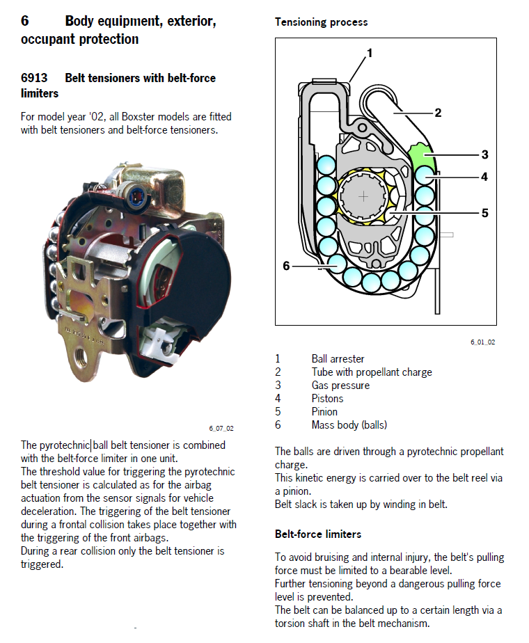

As of MY2002 all Porsches have pyrotechnic seat belt tensioners.
That means they are like an airbag - they fire once in an accident and they must be replaced.
You will need to solve one problem at a time if you have any hope getting this car road ready again.

According to the image above the tensioner is only triggered in a frontal crash WITH the airbags.  This should open up the % of 'good' used tensioners on the market
My understanding is that if the belt tensioner give a fault code then it has been fired and must be replaced.
