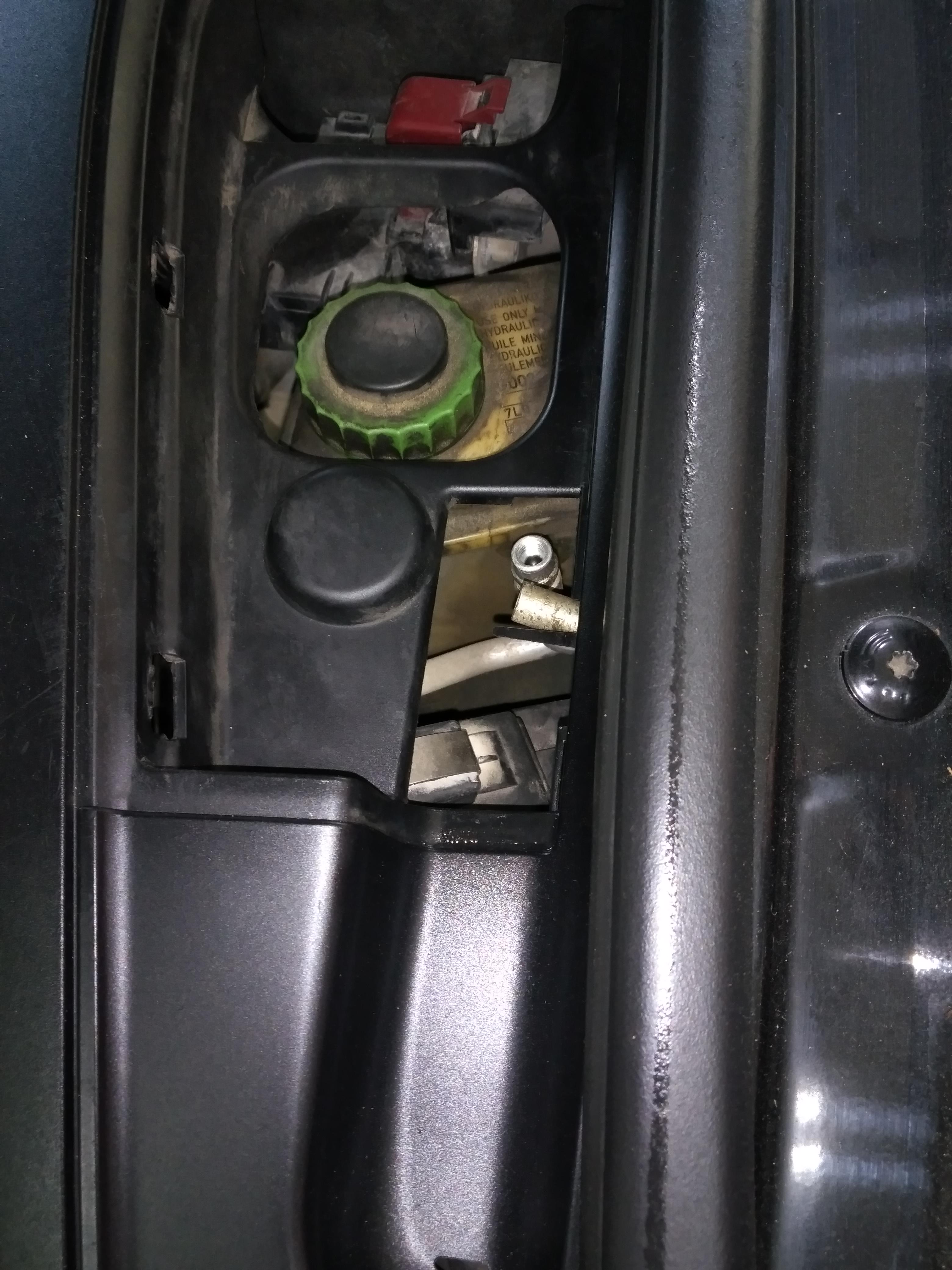

Picked up the car yesterday around 1.30pm temp was reading 55oC, I couldn't even touch the steering wheel and burnt my *** on the seat leather. Started up and tried to get the ac cooling but it was pumping out hot air, hotter than the outside temp. The garage guy wasn't there and his employee said "oh thats strange they re-gassed it and it was all fine". He then asked me for money to pay the bill, which I declined, I will check the car first I told him.
After 5 mins I gave up sitting there and went for a drive around, car felt ok but AC doesn't work at all!
Knowing all there mechanics are not working due to Ramadan hours here I decided to just drive home, I give up with these idiots.
Bad idea really, got stuck in Thursday afternoon traffic and had 50oC sauna for 1 hr until I turned of the traffic jam and headed to another fuel station garage. They checked the AC and confirmed my hunch there is no Gas at all inside. They vacuumed and found no leaks. They tried to fill the gas again but the refrigerant won't go inside. He said either the Schrader valve is faulty or the low pressure side piping is blocked. I noticed the low pressure schrader cap is missing when it was there before these other garage monkeys worked on the car and also there is a flat head screw driver wedge indent in the schrader Rubber valve. Can't see it on the picture though.
