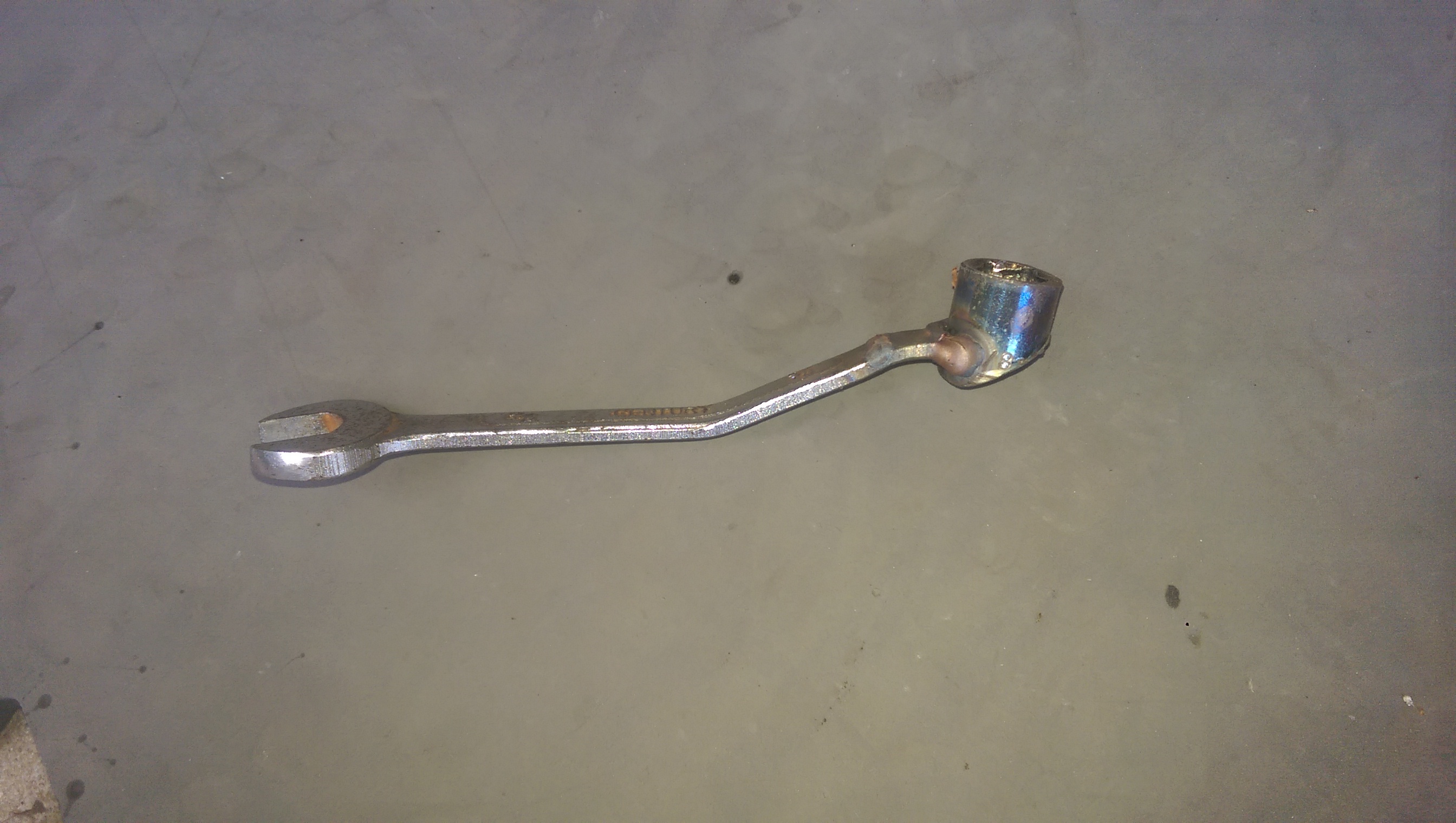

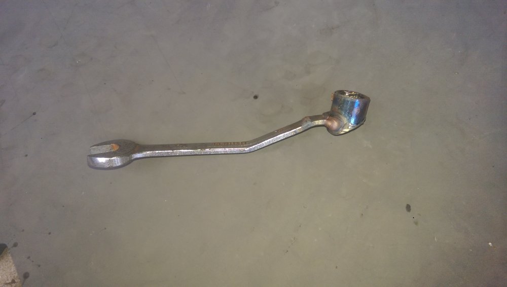

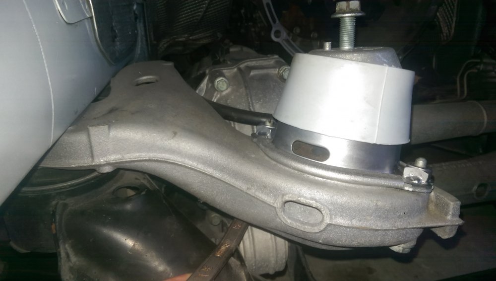

Yes. But the bolts are difficult to get from underneath. I tried bending an end wrench and ended up making one by welding a socket to a cut off end wrench and grinding some away. The mounts drop by about 3/4 of an inch with wear.

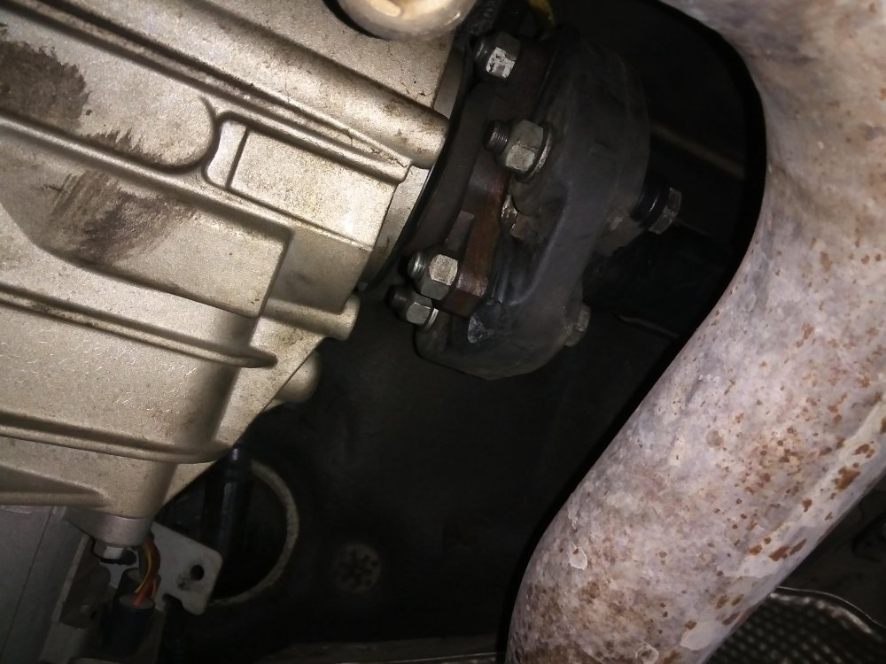

Unfortunately as soon as I drive it for a minute I notice the disturbing vibration, in the drive train it feels like. Before the work it was silkly smooth and the centre bearing and flex disc was in good condition I checked.
A constant vibration through the whole car increasing with road speed NOT with engine speed, I also heard a clunk when I deaccelerated down a slope and around a bend, just as I went back on the accelerator and the bend straighten out I heard the clunk.
I'm guessing cardan shaft or front Propshaft but not sure how that could be installed wrong when it was perfectly find before? Maybe they didn't tighten the centre bearing bush cradle properly?
Transmission shifting good and no leaks so far.
Engine starts and runs fine and sounds OK. Hesitation is unchanged by torque convertor seal replacement in case anybody was wondering if this was linked.
Sent message to the garage and will take it back in tomorrow afternoon to have a look.
If anyone has any ideas what this could be please do reply. Might save us some trouble shooting time.
Found the problem after having a look underneath...    flex disc Thomas we have a winner.
The garage have not tighten the bolts properly and the flex disc Rubber is visibly damaged. Big Sigh.

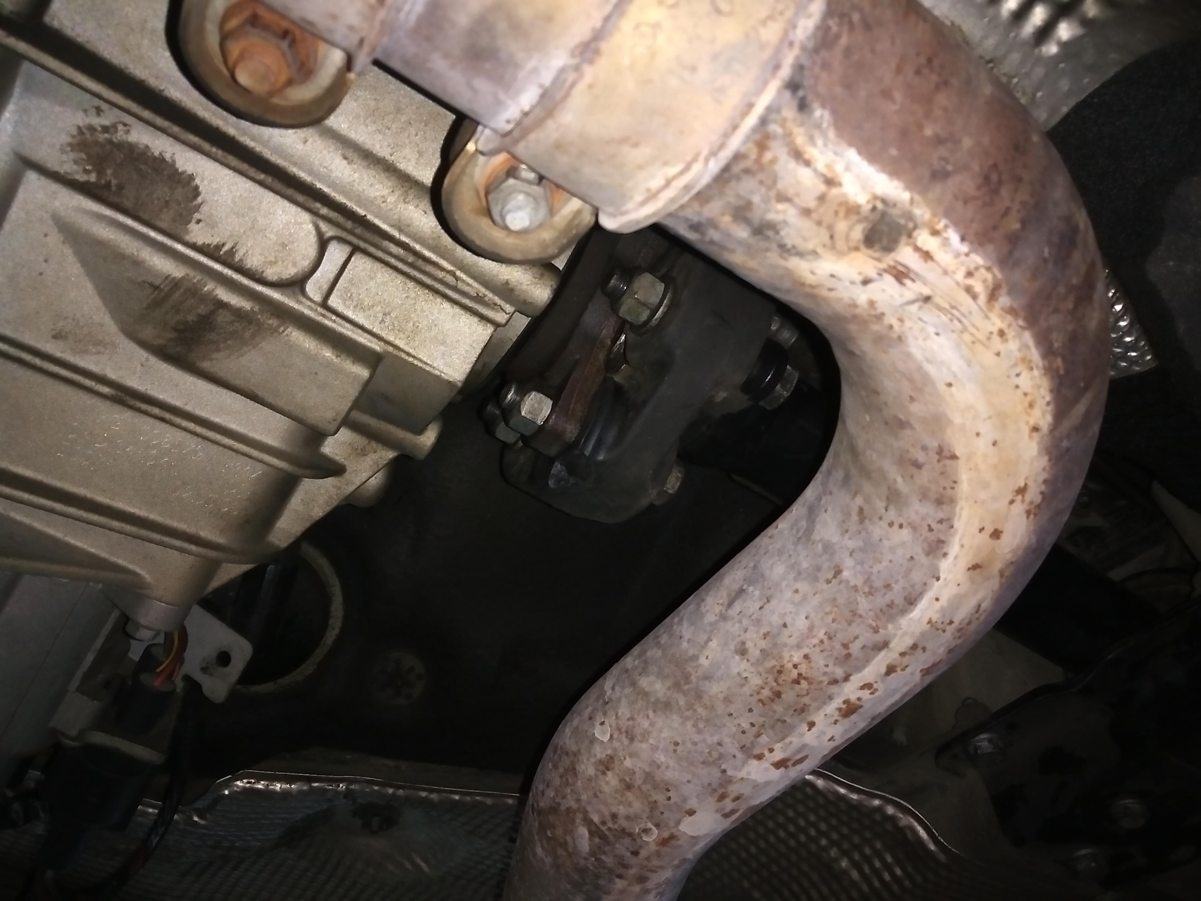

New flex disc installed this morning, wasn't the easiest job in the underground car park. Having to Jack up and lower and rock the car a bit forward or back to be able to get to the hard to reach bolts was a chore and it 40degrees here and 90% humidity.

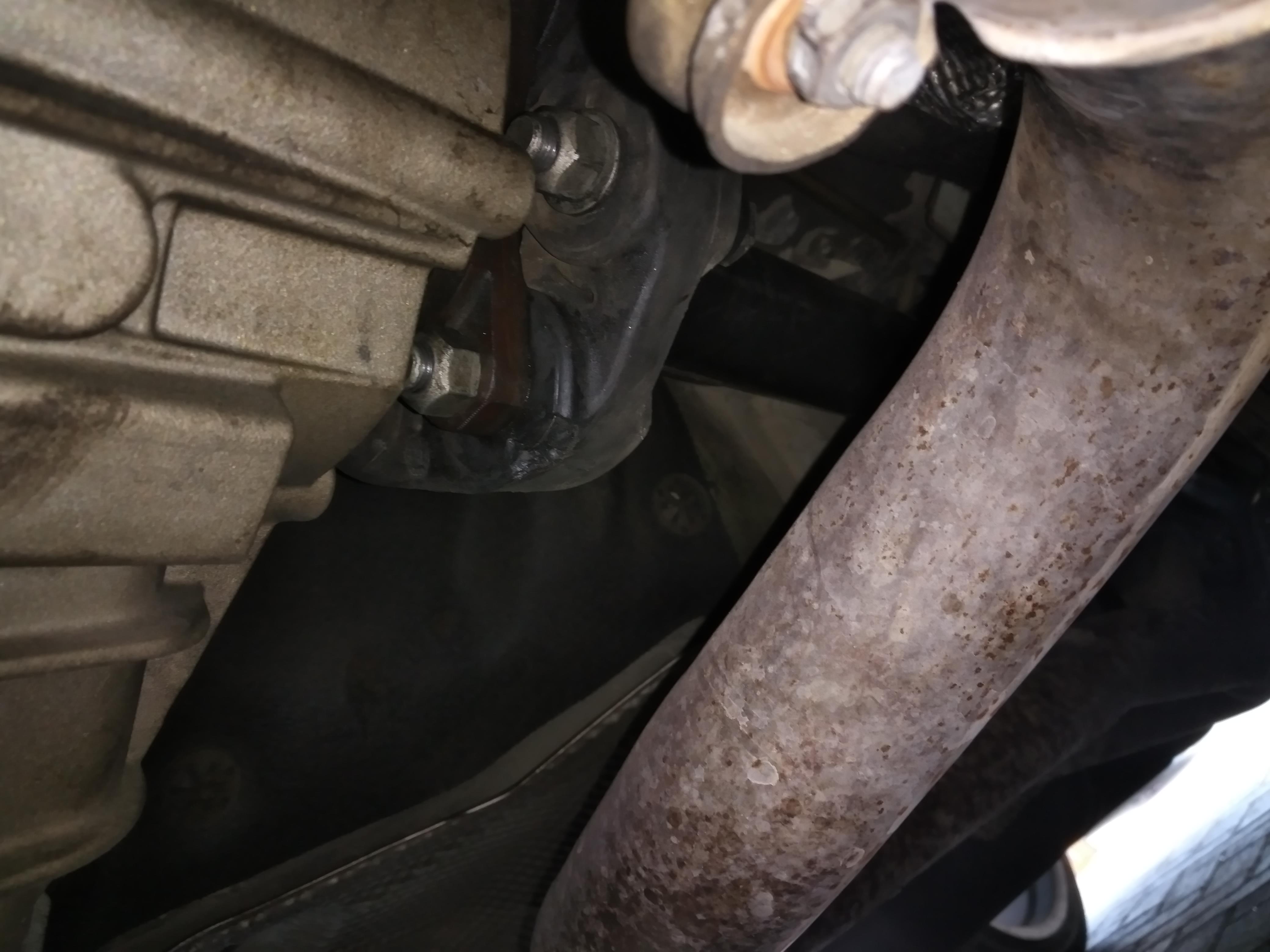

Also to note I haven't seen it mentioned in other diy that you do have to unbolt the centre bearing support and pull the shaft away from the transmission output in order to separate the inner spigot shaft which just sits 10mm or so inside the Propshaft. Once I did that the flex disc can just be squeezed out in the small gap.
Here is the picture my son took for me, old one has three distinctive tears in the rubber which is weird they all look the same and only damage is on the transmission side?
Haven't test drove yet as had to rush off to a birthday party. But I'm seriously not convinced this is the sole cause of all that vibration and noise. I hope I'm wrong.

You really deserve a good end of this story. The rumbling and vibration will be gone and you will see its a big big difference
Can't tell about the oil leak, but the noise is gone after changing the flex disc.
