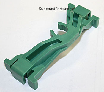

Possibly a shifter cable wear/misalignment issue.  If the car has the factory shifter, you can get a cheap (`$10) alignment tool from Porsche that holds the shifter in the correct position while you adjust the cables to match:
997%20shift%20alignment%20tool%20987%20b
If that does not do it, you are into checking the gear box internals
Thanks agin.  The tool is on order from Suncoast and I will report back either way.

What was the part number of the tool you ordered? Have you found a source for the adjustment procedure?
Thank you for reporting back your results. I will too if I do the adjustment.
Update: I found the part number [shift adjustment tool #SKU9X7 Suncoast] and I just saw a post on the replacement procedure and it looks like the adjustment threads are in the center console rather than the transmission end so I probably won't be taking all that apart for a relatively trivial issue (or unless your results are really fantastic).

For anyone that comes across this thread on adjusting the shift cable, the most important piece of advice I can offer is to make sure the car is in NEUTRAL before you unhook the cables to start the adjustment.

A quick summary for those that may be interested.  Taking apart the console will be tough the first time.  Should be pretty easy if you go back in for any reason.  I think total reassembly time took 20'ish minutes today.
My car now shifts better than at any time I have owned it.  Is it "snick-snick" smooth and quick?  No.  But it is close to my BMW 335i 6-speed and on par with a 996 I owned a few years ago.
Well worth the time and effort.
JFP, THANKS AGAIN!
