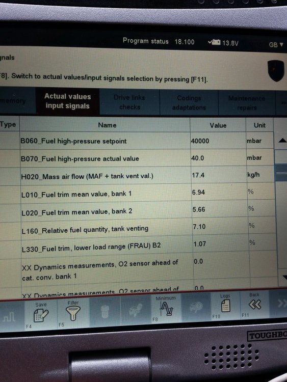

Seems like you are able to read out your cayenne. Could you tell me what your actual value and setpoint values are at this moment? I suppose your car is still ok now?
Because my actual HP value is around 5500mbar and the setpoint value is around 40000mbar. I am trying to figure out if my HP pump is dying. Because it already gave me a 1023 and 1026 fault last week.

Do you know which setpoint and actual values the HP system should have at idle?
40bar at idle. Answered this is one of your other posts asking roughly the same questions about your situation :) It's 99% your HPFP. It sucks. Just went through this entire ordeal in March. Like my grandpa used to say- Getting the answer I want to hear won't change the problem or the solution... - Matt

Hi, thank you for the information. So the actual value should also be 40 bar?
And it sucks indeed but at least now i am almost sure it will be the HPFP. I tried both fuel pumps in the tank by taking out the fuses of each one and it kept running on the left and right one. So they seems ok.
Yes. It's my understanding you should also perform a flow rate test on each pump. Either way, if they're original, they're likely on their last leg. Also, the fuel filter is likely nearing EOL along with the FPR (if all are original). Replacing all of the above sans the HPFP allowed reduced driveability (yes, not smart) during the week until my HPFP arrived... Oil change immediately after replacing HPFP, reset throttle adaptation, etc...
