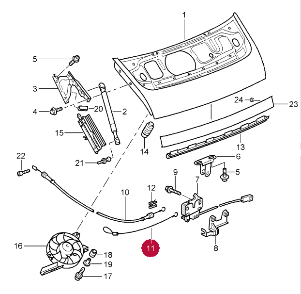

Thanks guys but opening the engine lid by the emergency cable is what I do also I have replaced the parts linked to it (7 and 8 from the part diagram above. also the lid opening switch) . However, I want to fix the electric function of the opening mechanism, so is there a way to track the problem exactly?

Since you have replaced 7 and 8, then there must be something wrong with the push button switch or a break in the wiring harness.  If you hook up a multimeter to the + wire of the solenoid wiring harness, check to see if when pushing the button you get 12V at the connector.  Also check the wiring harness ground.
