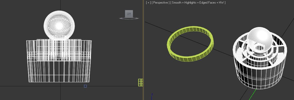

I recently, yesterday, noticed one of the pair of washer nozzles on the passenger side of my 01 C4 was gone.  I blame the guys who did my car inspection because it was not missing before then.  Personally, I don't care if it has a washer or not since I have never used it and don't see using the system any time soon if ever.  I googled just a replacement nozzle head and figured they were commonly lost and relatively inexpensive.  It turned out that everyone wants to sell you the ENTIRE unit for around $220 and some state the bumper must be removed to replace.  That sounded stupid to me on the order of replacing your entire lawn irrigation system every time I ran over a sprinkler head with the lawn mower.
I have a 3D printer and after doing a design that at least in theory should allow water to be forced through it, i printed out a replacement nozzle head.  It took me 3 design tries to get just the right dimension but I finally had a snug fitting visually idential copy of the lost nozzle.  I tried to design it at least somewhat functional but like I said I don't really care if it works or not, just that it covers up the obvious hole where it used to sit.
post-96666-0-07644000-1428261865_thumb.jThe problem I encountered was the piece is tiny and I was reaching the resolution limit of my printer a Makerbot 2.  This caused problems with the sphere design having a shell to thin to print correctly.  I may later redisign the top sphere part and give it a thicker shell or simply forgo the sphere design and make it an angled tube instead.
