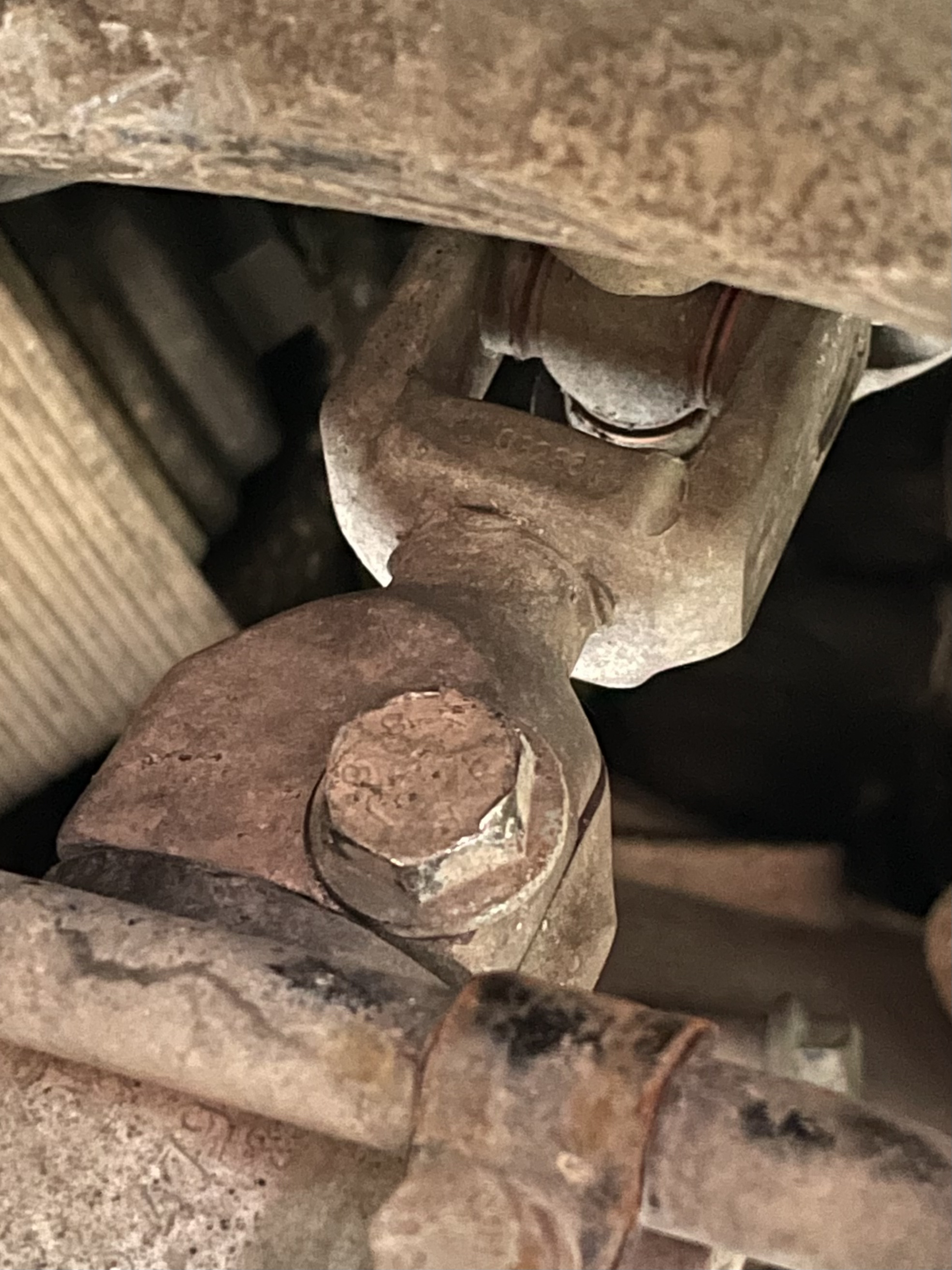

Hi folks, my u joint connecting the column to the gear is loose; observed from underneath the car. Leaves a half inch of play in the steering wheel which drives me nuts at higher speeds or in windy conditions. My buddy heard it from a 'Porsche guy' that there's a way to simply tighten the u joint or swap the intermediate steering shaft vs replacing the steering gear or steering column as the dealer recommended. Thank you in advance, Matt in Chicago

Just wanted to inform anyone having issues with play in their steering that my problem was solved by simply tightening the etorx bolt that attaches the steering shaft to the rack. Was quite loose. Easily accessible from underneath the car. Couple turns of the extended socket wrench with an e14 torx and she’s good as new.

No pics, but it's pretty easy to spot. A little tricky to reach. From underneath the vehicle's driver's side, with the trans shield removed, you can see where the column attaches to the steering gear by a single E14 torx (M10x35). By turning the wheel slightly to the passenger side I was able to reach the bolt with an extended socket wrench. If you pull up the parts diagram from the free PET pdf you'll see what I'm talking about. PMing you now.

Tighten the bolt today. Was infact a normal hex bolt and not a Etorx.

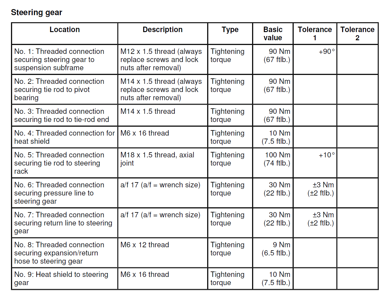

I tightened mine and its much better...!  Can anyone provide the specified torque setting for this bolt?
 Long time ago, but I am in the process of doing this now. Anyone know the correct torque?
Exact model and year of your car please...
