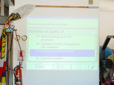

P1315 Misfire, Cylinder 3, Emission Relevant
P1316 Misfire, Cylinder 4, Emission Relevant
P1317 Misfire, Cylinder 5, Emission Relevant
P1318 Misfire, Cylinder 6, Emission Relevant
P1319 Misfire, Emission Relevant

Now, I clear out the codes and start turn on the key. Guess what, the CEL is blinking and then stay on.
Plug in the code reader and there you go: P0300, P0306, P0304 ....P0305 plus the old code P1316-P1319.
