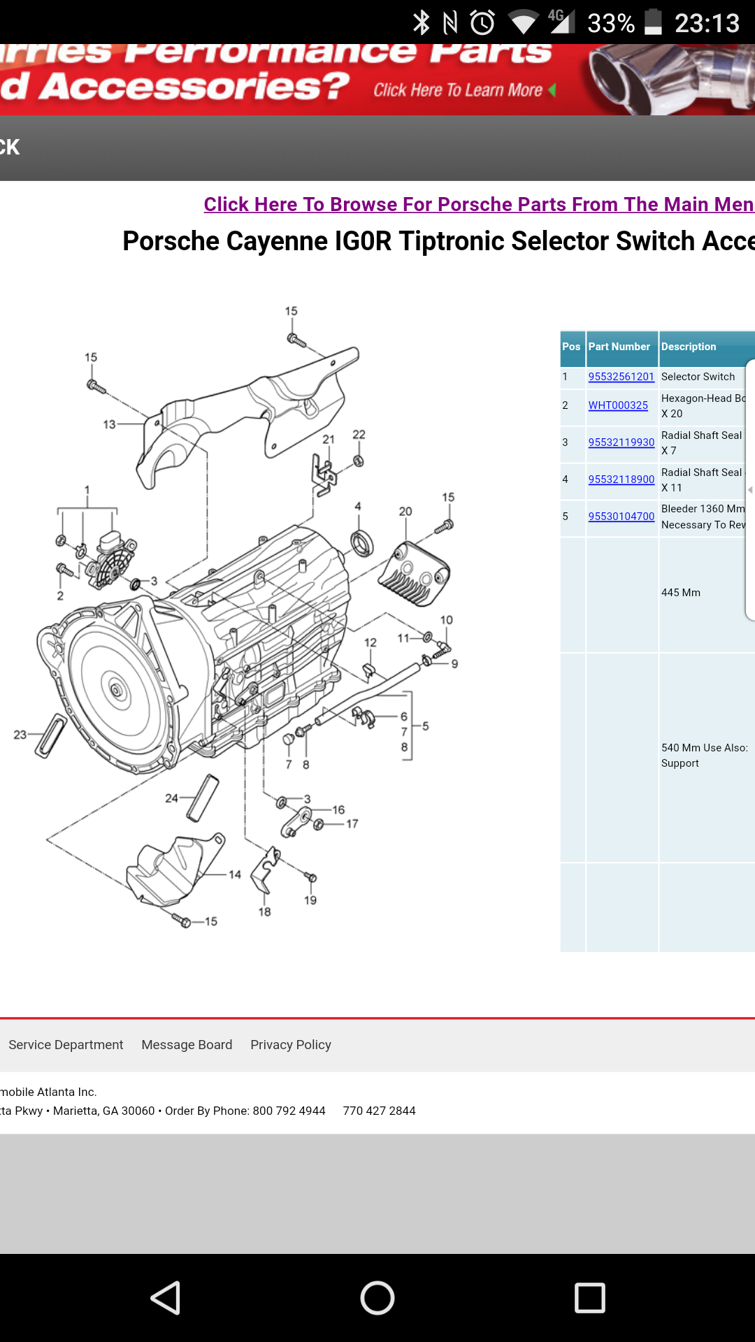

Other possible things to check is the connector going to the side of the transmission is not wet corroded or loose? Picture diagram part number 1. Refered to as the F125 multi function Switch (hence code 0293).
