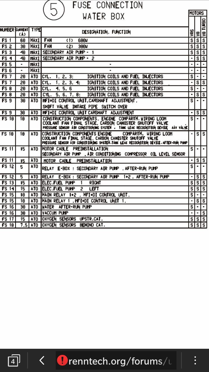

one problem fixed an other is there. the Ac stop working. I checked the cabel on the Compressor and I don't have there 12V. all Fuses in the right panel fusebox #23 and #25 are ok.
do anyone know where the relays are?

Try fs11 in the "water box"
Thanks a lot the AC works fine. now I have only to find the problem why the Cluster show oil level monitoring and psm failure
