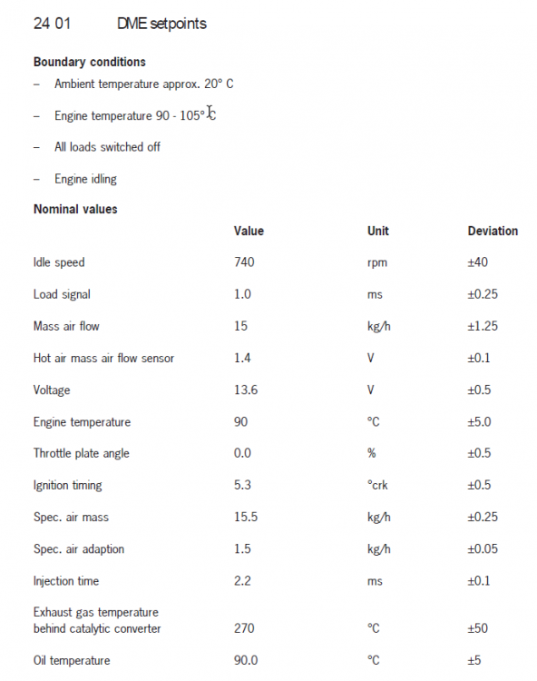

Anybody knows how many maf max kg/h readings for boxster?
I have this readings:
553,25 at 5800rpm
Enviado desde mi Redmi Note 3 mediante Tapatalk
Thanks Loren. I have this. Im asking WOT MAF Max readings.
That is not spec'ed by Porsche.
OK thanks. As there is a relationship between Flow and hp, I wanted to know if anyone has logged it and maximum value. regards!!
