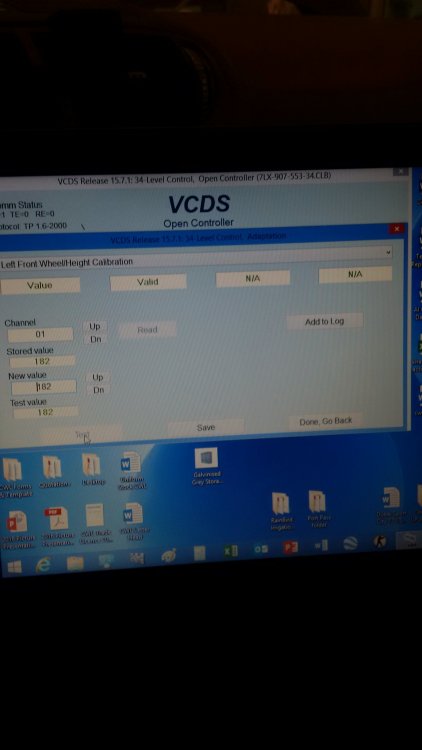

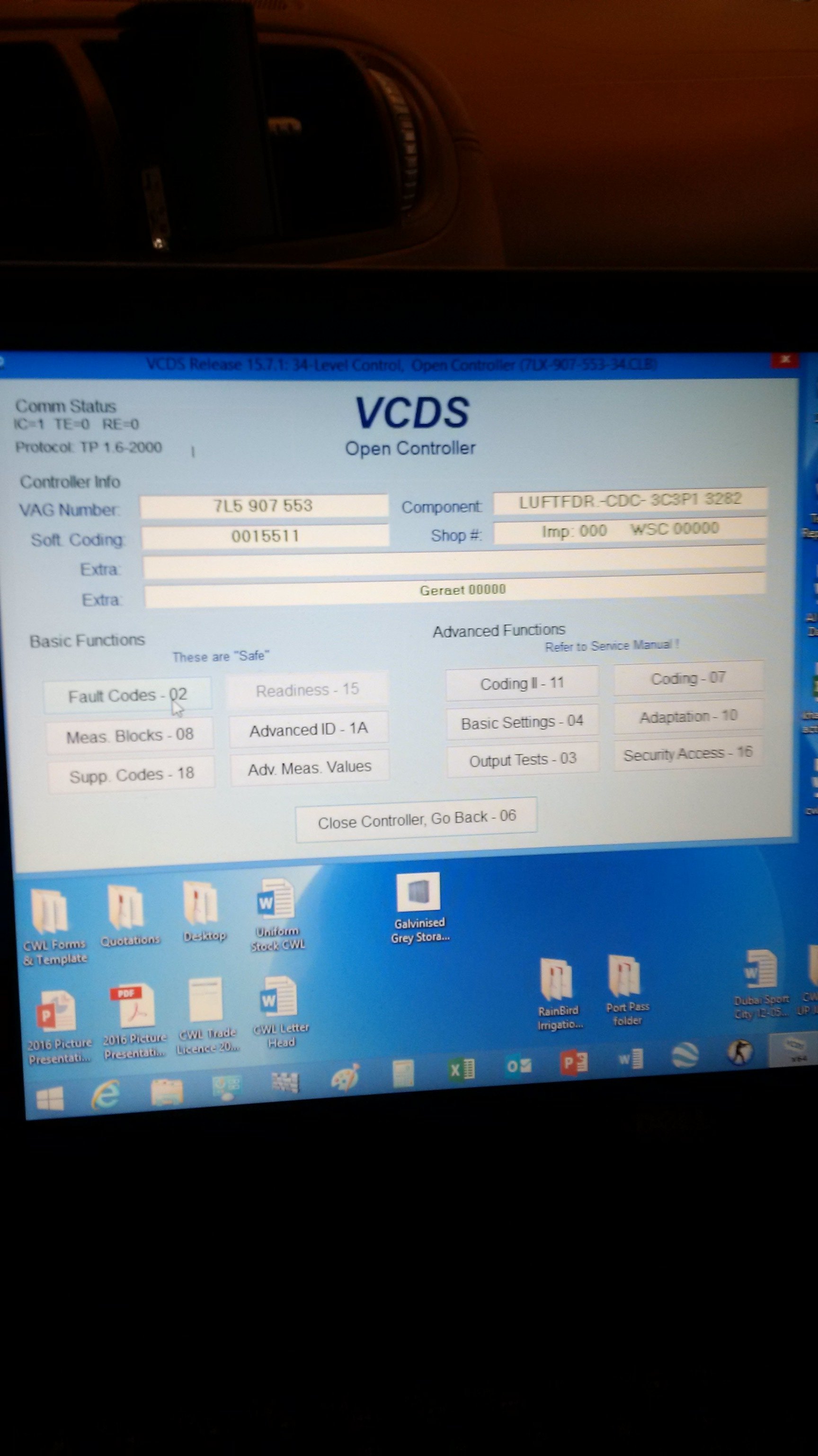

Go to chassis tab and select 34 self level suspension.

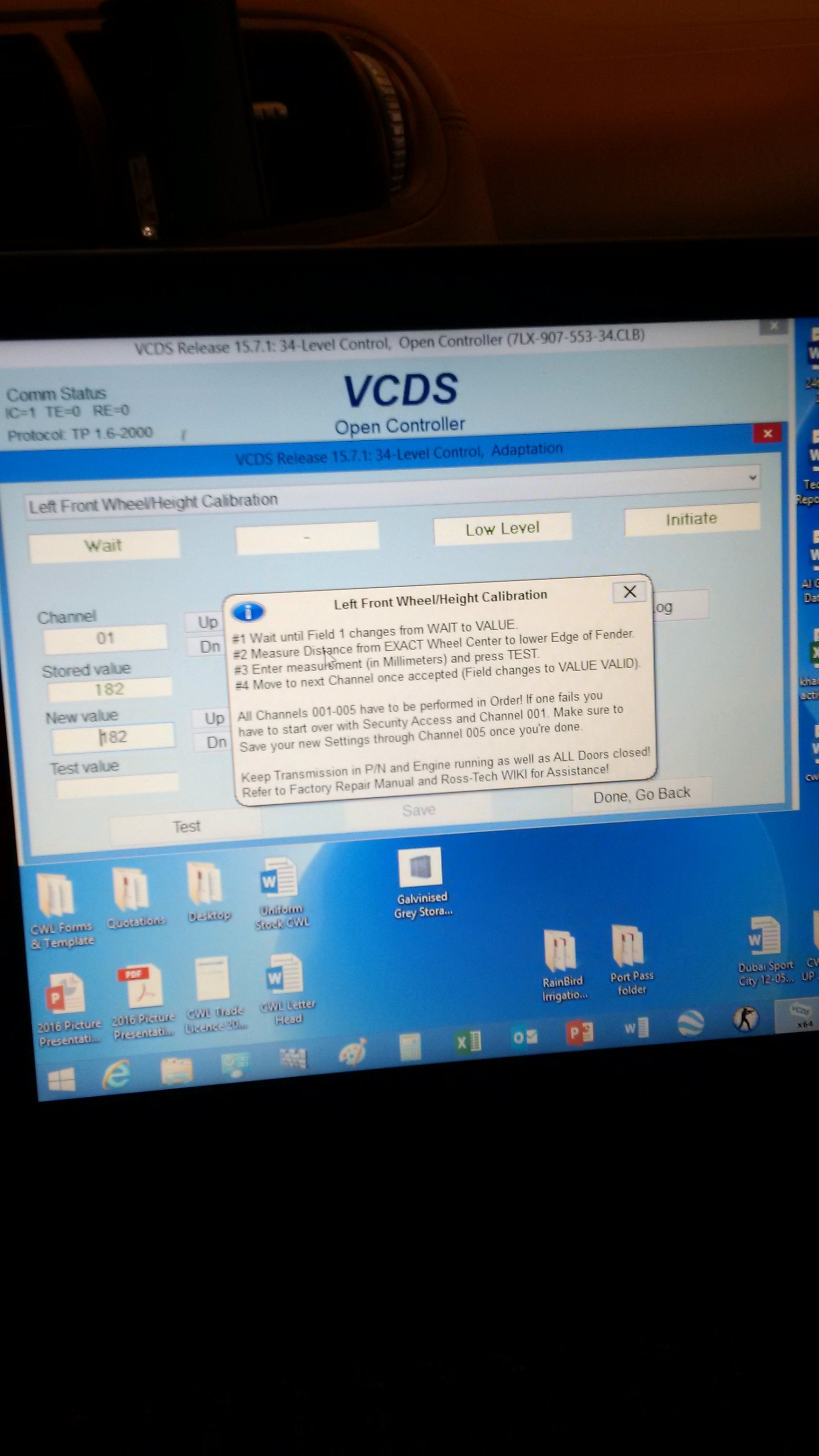

The vcds actually gives you on screen tutorial on how to use this for calibration.
Put in the security code as it instructs 15624 iirc and then begin the calibration sequence.
Knowing the correct measurements is a bit difficult as vw and Porsche take the mm measurement from different places and there fore the mm you see on vcds won't relate to your thinking, so don't try to compare it just use it a number.

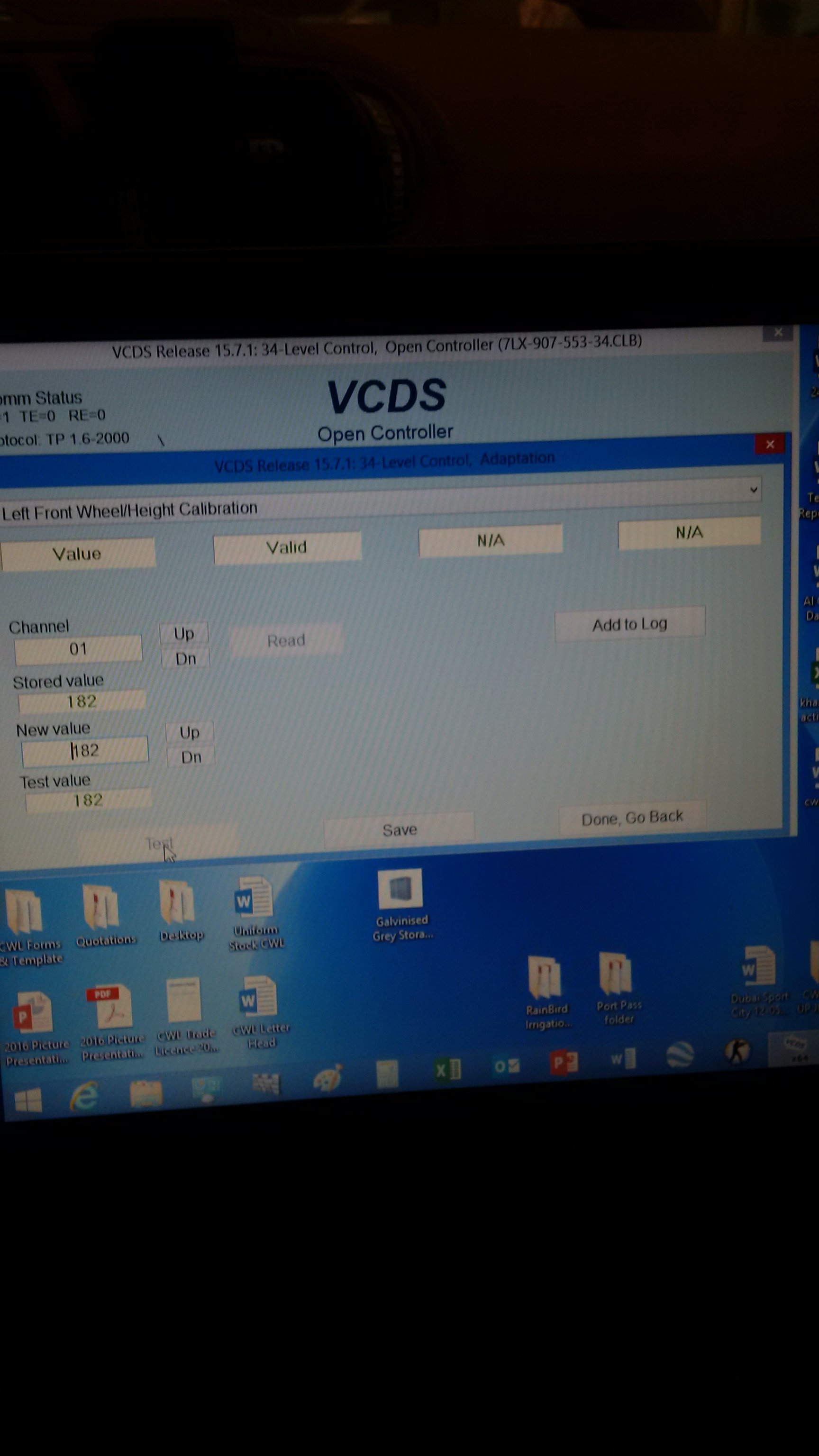

What I did was measured the rear from centre hub to arch then compared to front. Cross reference that against the vcds figure and input the difference as a subtraction to the mm measurement on the front thus fooling the vcds into thinking the front is low and it will pump it up.

So try telling it the front is actually 195mm thus it will raise it by 20mm next time.

If the reading you put in the test is not accepted then rock the car forward and back until it accepts the number you entered. You can even drive forward and back small amount as I did.
If you get any error you must start again from security code input forward.

Menu chassis then click 34 "level control"
