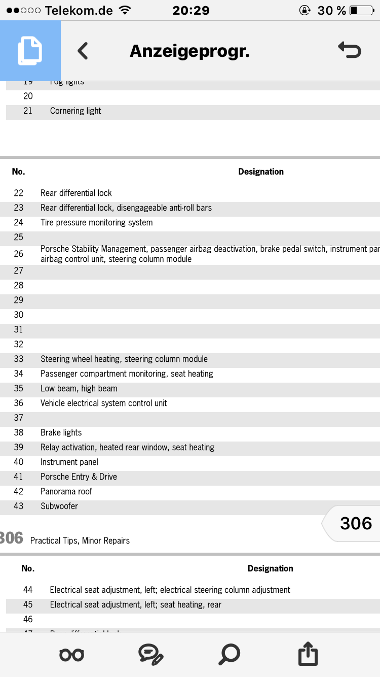

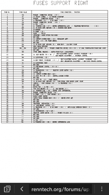

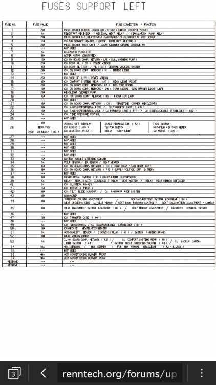

try to take out this fuse for a moment and put it back. Start the car and see what happens with your warnings
the oil monitoring failure is out but the PSM stay on. if I drive the Car sometimes went the PSM light off but after I brake down it comes back on.
Unless I have incorrect info the fuse on left is not psm related items and the fuse on right 26 is not used.
