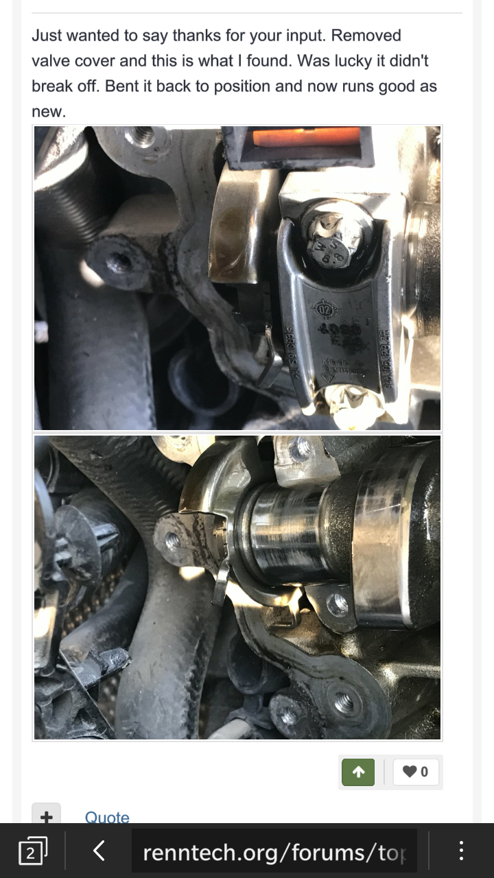

today I check the camshaft pick up taps and the little pin was bend. I bend it back and will check now the Timing again. had someone a diagram for the timing marks?
Another one with bent tabs this is turning into common occurrence.
Let us know what the outcome is, anymore fault codes and what's the running condition now?
Thomas your reading this for sure!
Yes i am reading this.
Many times already it has been discussed in the forum about the importance to take care about these cam shaft tabs when working on the valve cover.
