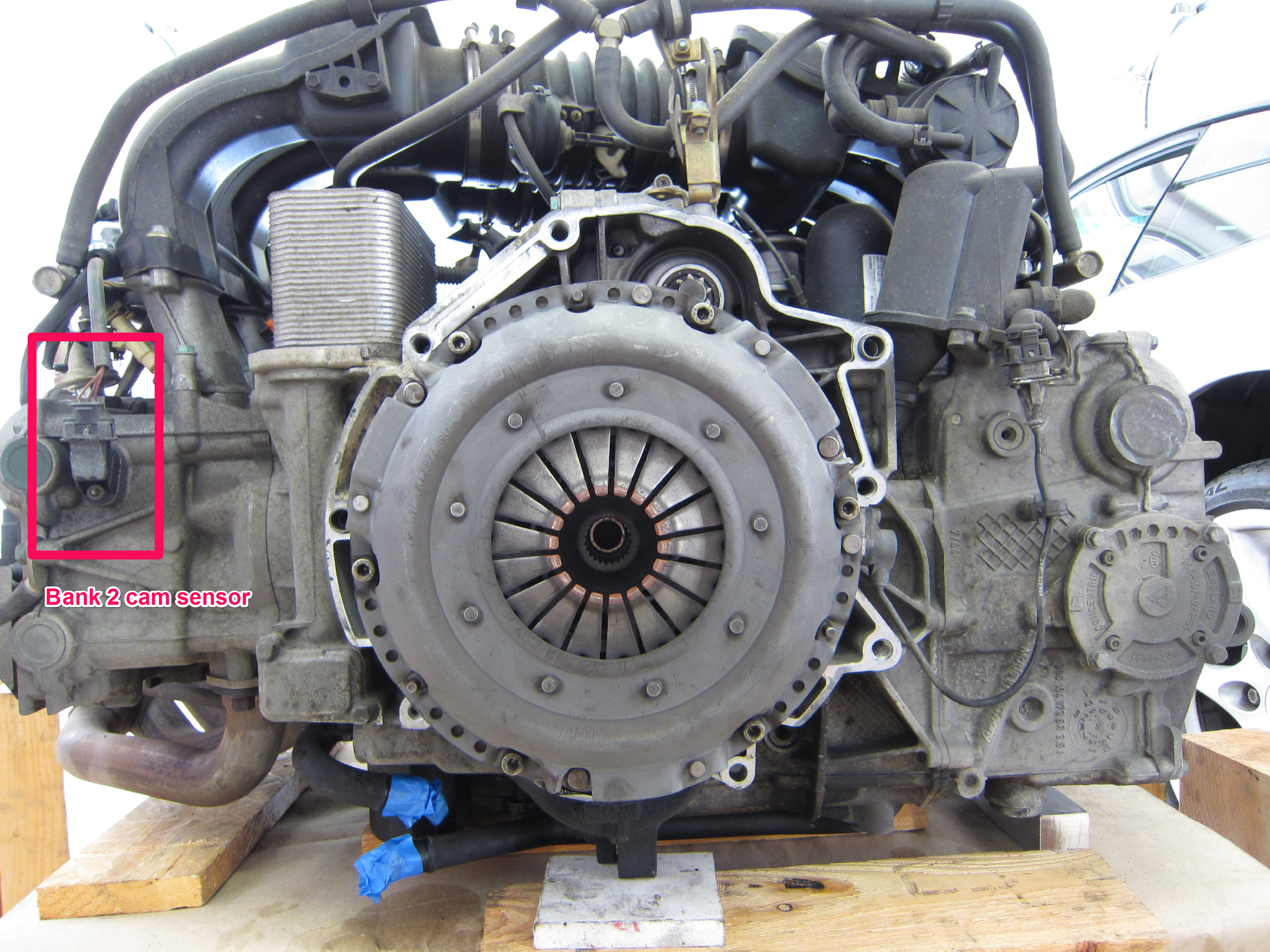

I managed to get the morning off work and had a look at the sensor that JFP and Ahsai recommended, thanks guys.
Wheel off, heatshield off.
Found the sensor.

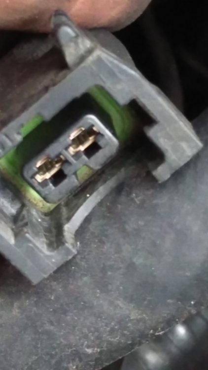

Took off the connector.

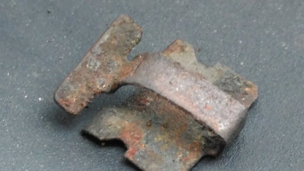

The metal clip that I think should be attached to the tab on the sensor holder, was on the loom but not on the tab.
Looking at the wiring diagram I tried to check continuity and it checked out.
This is what it should look like, as you say the cable clip is supposed to be part of the sensor retainer bracket.
I would take a close look at the sensor retaining bracket, we see these things snapped off pretty regularly:

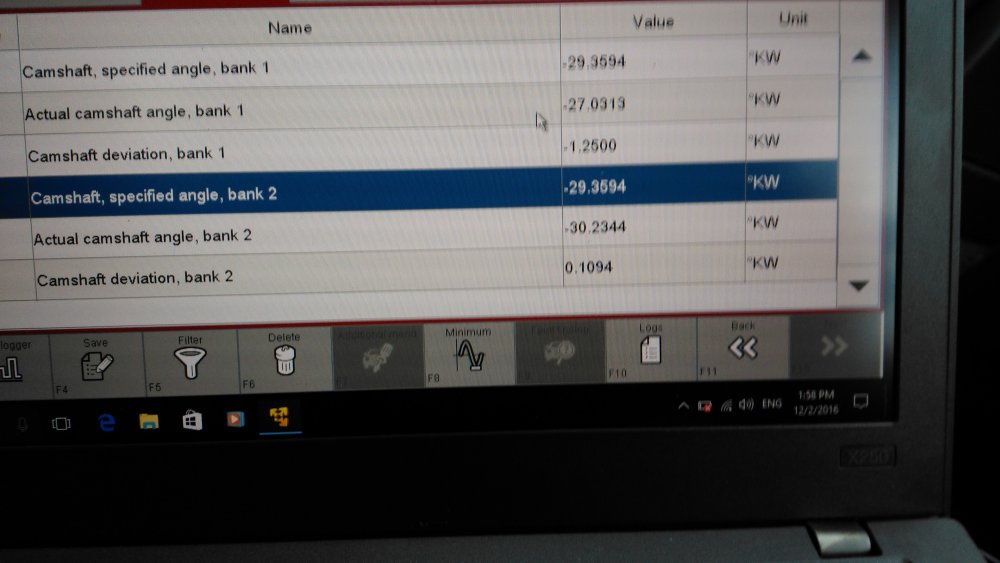

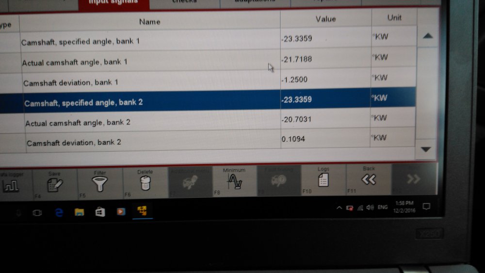

Idle, both banks.
In all of the three above, the difference between the actuals and the specified isn't the same as the deviations?????
The deviations are staying at static values.
I am Confused:cursing:.

  On 12/2/2016 at 9:02 PM, Captain Lockheed said:
A few more revs
Bank 1
Specified -29.3594
Actual -27.0313
Deviation -1.2500
Bank 2
Specified -29.3594
Actual -30.2344
Deviation 0.1094
Expand
These readings look OK to me so it looks like you have an intermittent problem in bank 2, where the spec'ed angle and actual angles were very different in one of your earlier posts. You can just reset the codes and see if they come back.
The cam deviations should be fixed (during each drive but they may be slightly different across drives) and solid at all revs. If they fluctuate with the rev, you have a very bad problem.
Edited by Ahsai
Expand
Which could happen if there was no communications from one or more cam position sensor.
Just so it's clear, the "sensor" you're checking now is not a sensor, it's a solenoid that controls the hydraulic flow to the variocam timing device on the head of the intake cam. The timing device varies the relative phase difference between the crank and the intake cam.
The cam sensor that John referred to is actually a hall effect sensor that reads the reluctor on the intake cam.

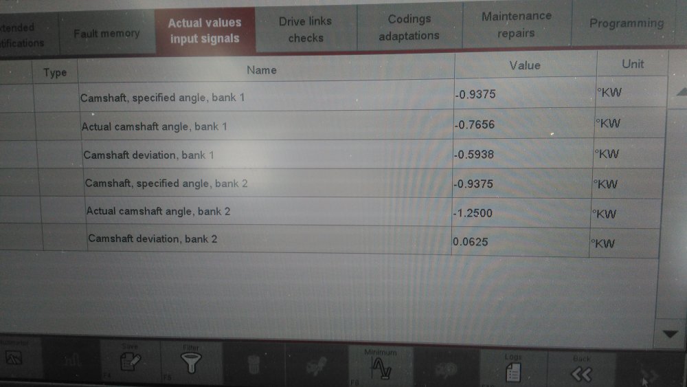

Managed to use the PIWIS to cycle the solenoids and check the wiring. Alla seems good. No obvious damage.
Bank 1
Specified -0.93725
Actual -0.7656
Deviation -0.5938
Bank 2
Specified -0.9375
Actual -1.2500
Deviation 0.0625
