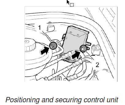

There is a control unit here

Sensors/transmitters are inside the wheels.
The receiver is the control unit that then communicates with the PCM/radio and the instrument cluster via CAN (network).
