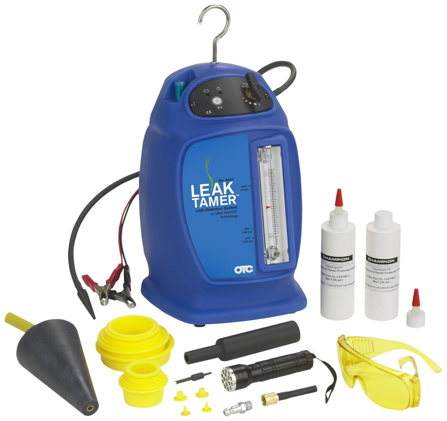

Thanks Loren, not sure where to get a smoke machine from just yet but I'll try this and let you know. Thank you.
Most good auto repair shops have them.
A good smoke test unit is upwards of $1.5K, so I would consider doing what Loren says and take it to a shop with one.
