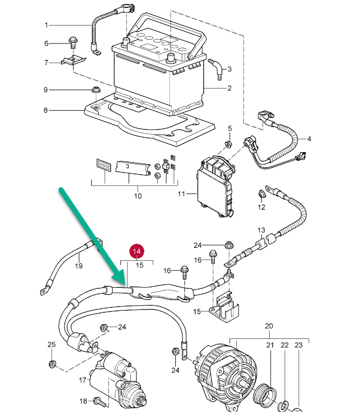

Upon turning ignition key,  heard a click, and had no electrical power to anything on car. After opening hood and looking around I grasped the positive battery cable and pulled / jiggled slightly to check connection from where it disappears into the  firewall (if you will) area, and all electrical power was restored... car started and everything fine? Next time I went to start car experienced the same scenario. My question is...where, what does positive battery cable connect to that would exhibit these symptoms. Thanks
997-1 had a problem with the cable to the starter.
Make sure you get the correct cable as they are different for 6-speed and Tiptronic.

Loren thank you for your response. The cable from the starter and to union #15 has been replaced. If cable were for tiptronic would it still fit my application as I have a 6 speed trans.?
What is part #11, and how might it figure into my issue? As everything works after moving cable, I'm thinking its something up front?
Check the nut that fixes cable #4 to part #11 (firewall frunk side). Part #11 is the power distribution unit under the dash on the passenger side that houses a few large curent fuses.
I know one case where that nut was loose (on a Boxster but same design) and that created electrical cut-out issues.
