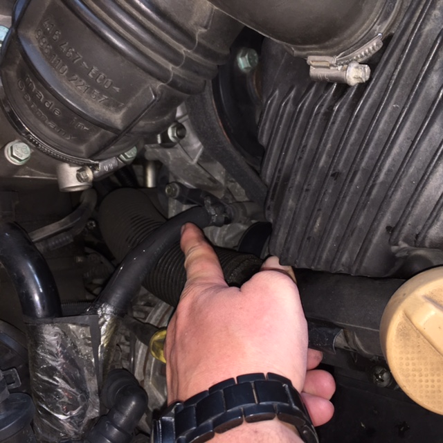

Wondering is anyone can help me locate/purchase the small radiator hose just right of the oil fill, and to the right of the dipstick. It the hose that goes up from their.
Cheers,
Thanks, I will get one ordered ASAP, looked in my rear view today and noticed steam coming from the engine compartment. Lice clean slice to the outer rubber of that hose. With a nice stream on antifreeze coming out. Hope I didnt do any further damage.
Try sunsetporscheparts.com if you want the best deal. Btw, that hose connects to the AOS so it will be quite some work to get to (need to remove the alternator and the left intake manifold).
Um, that would be news to me but please let us know if you find a novel way to deal with these hoses. Could help AOS replacement a lot if true.
