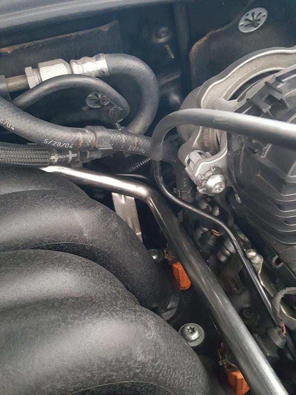

I agree with JFP. Check all those vacuum lines at the back of the intake manifold. Also the one line I found snapped that caused similar symptoms lewisweller is the T-connector at the very back of the engine hidden down by the firewall that connects exhaust lines from the turbos and runs to the front of the engine and connects to the crankcase ventilation. It is a very common piece that can break and be overlooked when tracking down leaks.
Picture from Lewis.
We are talking about this T piece?

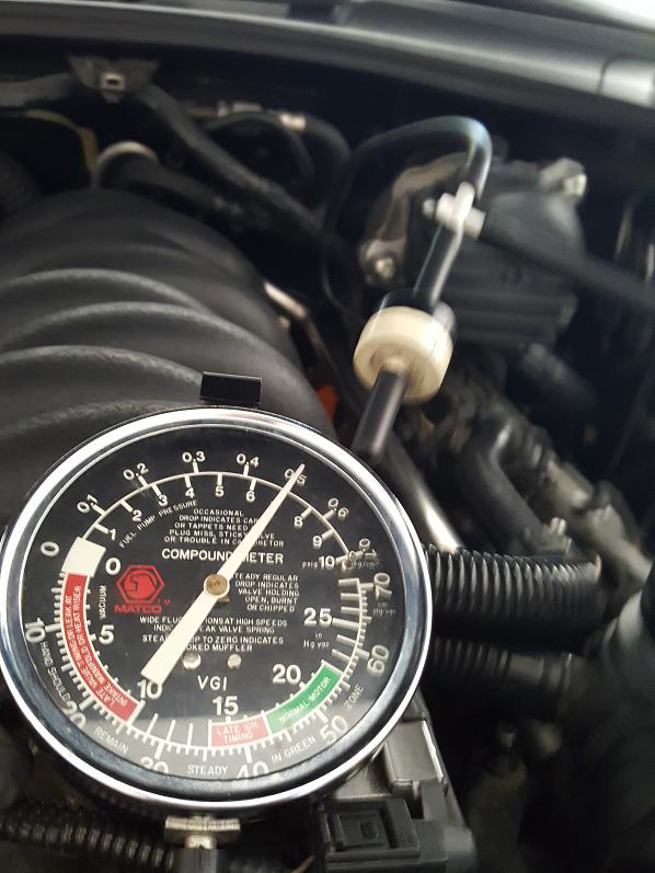

I am suffering the same issues of building only .04 bar boost. After pulling and inspecting all the related vacuum /pressure lines, visually checking wastegate operation and both diverter valves, everything seemed ok. Still only .04b boost. I know the turbos are spinning ie;.04b on the gauge sooooooo, There are only 3 things that could be holding me back, diverter valves, change-over valve, N75 valve.....  I pulled the change-over valve and plugged the vacuum and boost feed lines. I then borrowed the check valve from the pressure line and put in series my vacuum/pressure gauge on a "T". I then pressurized the diverter valve lines with 7b air knowing the check valve would hold the pressure....it worked perfectly (see attached picture). I did a test run and  it built .08bar before popping off, but not for longer than a second.....hmmmmm, at least I knew it was capable!!!! I then decided to disconnect the wastegate line from the N75 valve and try again....total success, it pumped right up to .08 + b and stayed there. So, reflecting, I am going to replace, the N75 valve, the change-over valve and both diverter valves. I'm super happy that I confirmed the turbos were capable and the controls are just not doing what they should. Hopefully the bastard computer is not interfereing and limiting boost, if that's it I'll have to go down that road.
Anyway, here's a couple pics of how to confirm diverter valve are working.
Tim
