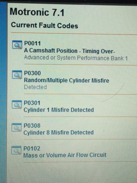

Hi I had a workshop error message when I started my car this afternoon thought it was one of the vacuum pipes had split again so thought I would replace as soon as I get home well all was well until I tried to accelerate and nothing happened and I got all the gear selection PDRN lite up. So I slowed down and carried on at 60 changing gear stopped at a traffic light the. Tried to move off and the cayenne no power then lots of power and the PDRN disappeared. Was fine until I tried to accelerate and it coughed again I limped home plugged in the durametric and received the below errors.  I cleared the error took it around the block and same again from a standstill coughing. Any ideas I did change all the plugs to Bosch and one coil pack that was cracked in cylinder 4 a couple of weeks back and it has been running like a champ until today
any ideas all and thanks in advance

I suspect you have a boost leak - - that would trigger the MAF and misfire errors. I once did not fully insert the driver side turbo-to-intercooler hose into the intercooler flange. It blew out under boost and gave similar errors including the PRND error on the dash. Check your intake tract from the MAFs to the engine for leaks. Do a pressure or smoke test for best results. Good luck.
HI thanks for the quick reply, why would it effect driving off from lights if I'm not under a boost condition ? Any ideas the size of pipe I'm looking for could it be a vacuum leak around the air filter box passenger side, thanks
Yes - It's technically a boost/vacuum leak issue so it can affect drive ability at all speeds depending on how bad the leak is. It's caused by unmetered air from a leak between the MAFs (mass air flow sensors, which are just below the air boxes) and the engine. And when the MAF readings don't match what's actually entering the engine, then the fuel mix will be off (causing the engine to run rough and throw codes). You need to check all the intake plumbing for leaks, cracks or things that came disconnected. From your description, it sounds like you have a big leak (because you have trouble at higher speeds too), so start with the throttle body and examine all the charge piping (Y-pipe, pipes to ICs, hoses from ICs to turbos, turbos to MAFs). Most of that piping is ~2.5" black plastic or rubber. Note also that there are some small hoses on the underside of the Y pipe that can come loose or get damaged by the water pump pulley that aren't obvious without pulling off the Y-pipe, and can cause issues. It's also possible you have a leak on one of the vacuum hoses or corrugated plastic tubes attached to the intake manifold. Inspect those too, but it can be harder to visually troubleshoot those hoses as they are smaller and many of them are obscured by other parts. That's why a pressure or smoke test would be most useful. Lots of videos on YouTube on how to do this (generically). Hope that helps. Good luck.

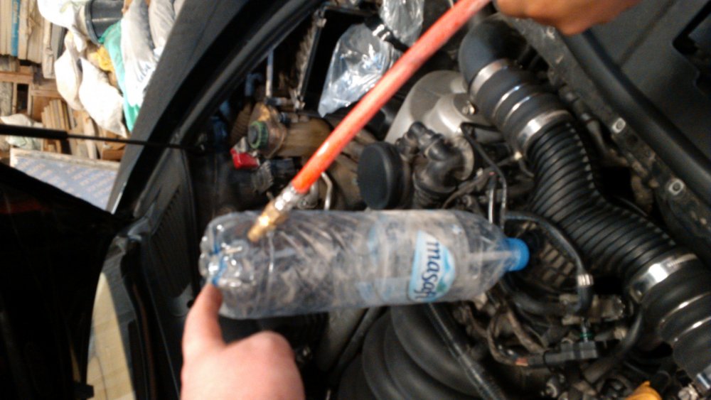

Home made smoker can be made from a clear 2 litre bottle, drill the cap a hole slightly smaller than a cigarette butt, also make a hole in the side of the bottle to fit an air source hose/ gun/ pipe from a air compressor or hand pump etc.
Before testing Remove the air box pipes both sides and cover with a plastic food bag and duct tape tightly to make pipe ends leak tight.

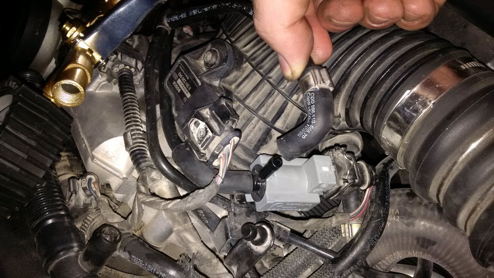

Remove the intake Y pipe mounted Map sensor, (pictured above my thumb in the second image) one torx screw T25 I think or a flat blade will do it, using the Map sensor hole place the bottle with a lit cigarette in the cap, put bottle upside down on the map sensor empty hole in the intake.
Pressurised the bottle with air to force the cigarette to burn and push the smoke into the intake Y pipe and around the system.
Look for smoke escaping around left and right side piping from turbo to intercooler and all those pesky vac tubes and other small pipes.
You may need to used more than 1 cigarette to fill with smoke, I used 3 Total to get smoke everywhere it wanted to go, didn't find a leak though.
