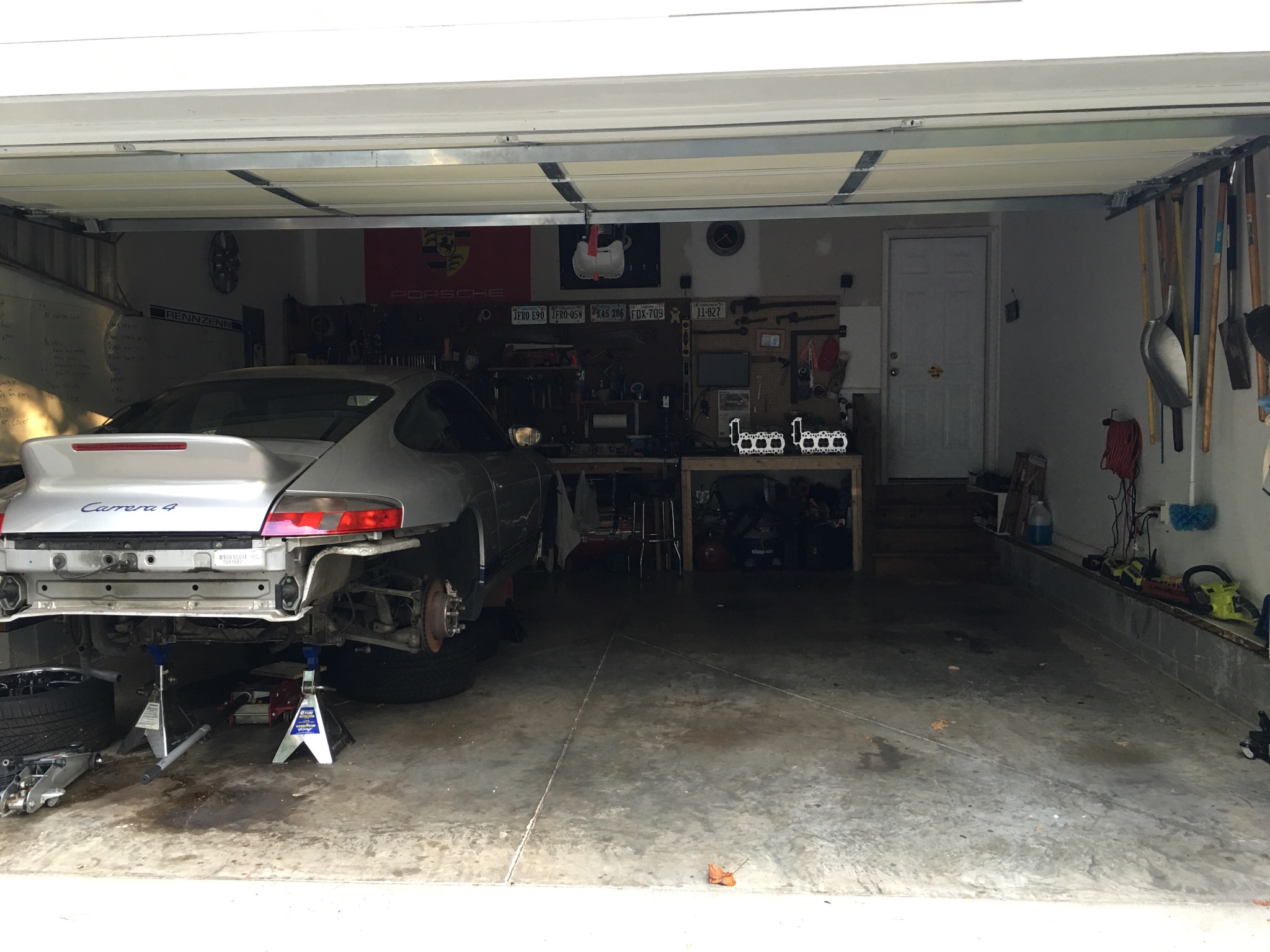

Back in May I found the dreaded oil-in-coolant, followed by coolant-in oil. I got the engine out of the car and the heads off, and away they went to Len Hoffman in Georgia. He confirmed yesterday that I've got a crack in the 1-3 head. He's doing the repair along  with some other maintenance items and port/polish. The lifters and fuel injectors are also away for service. I'm aiming to have my 996 back on the road in the spring, running better than brand new with a bit more umph from the head work. Anyone else had work like this done? Just wondering what to be looking forward to.

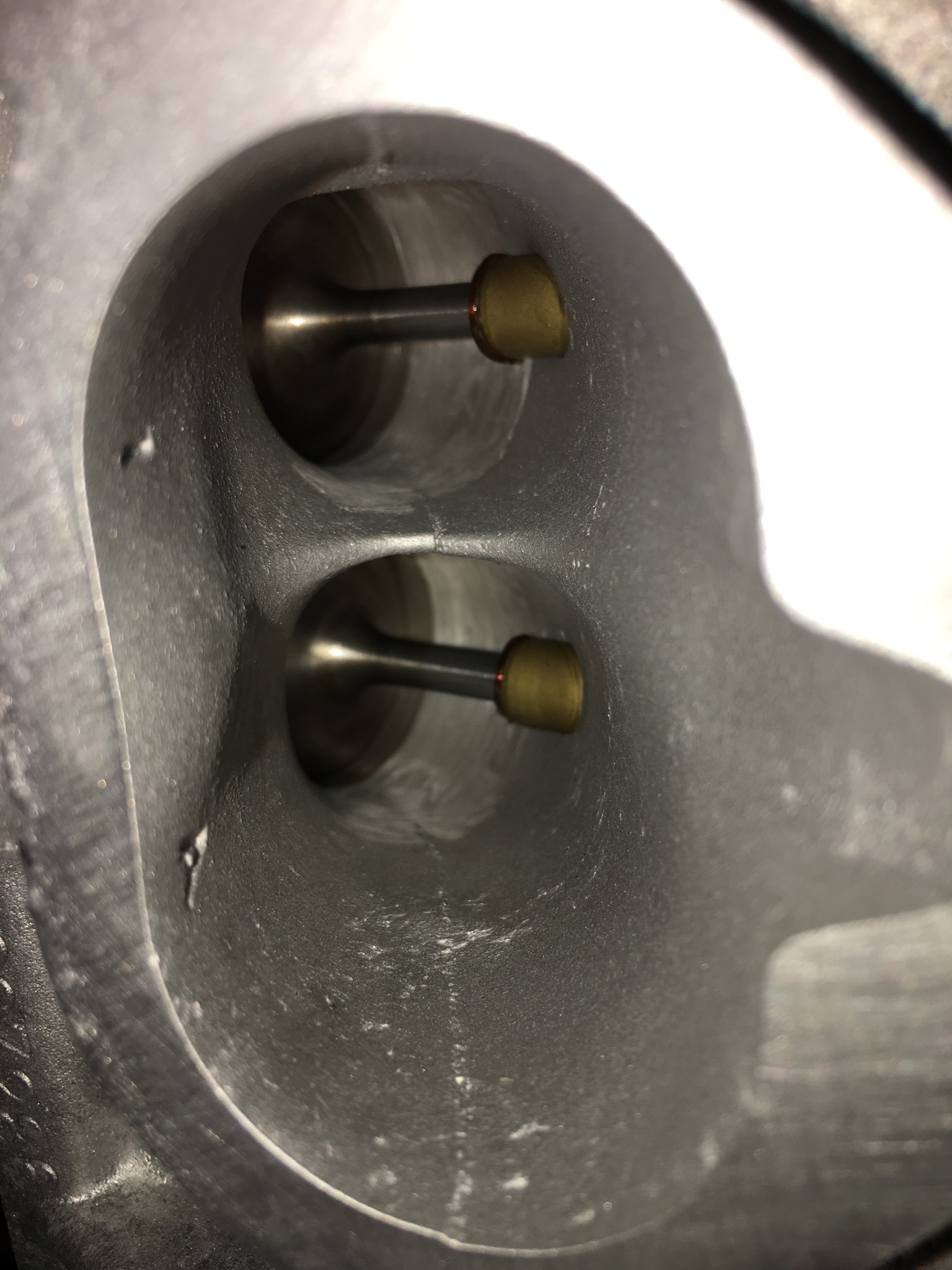

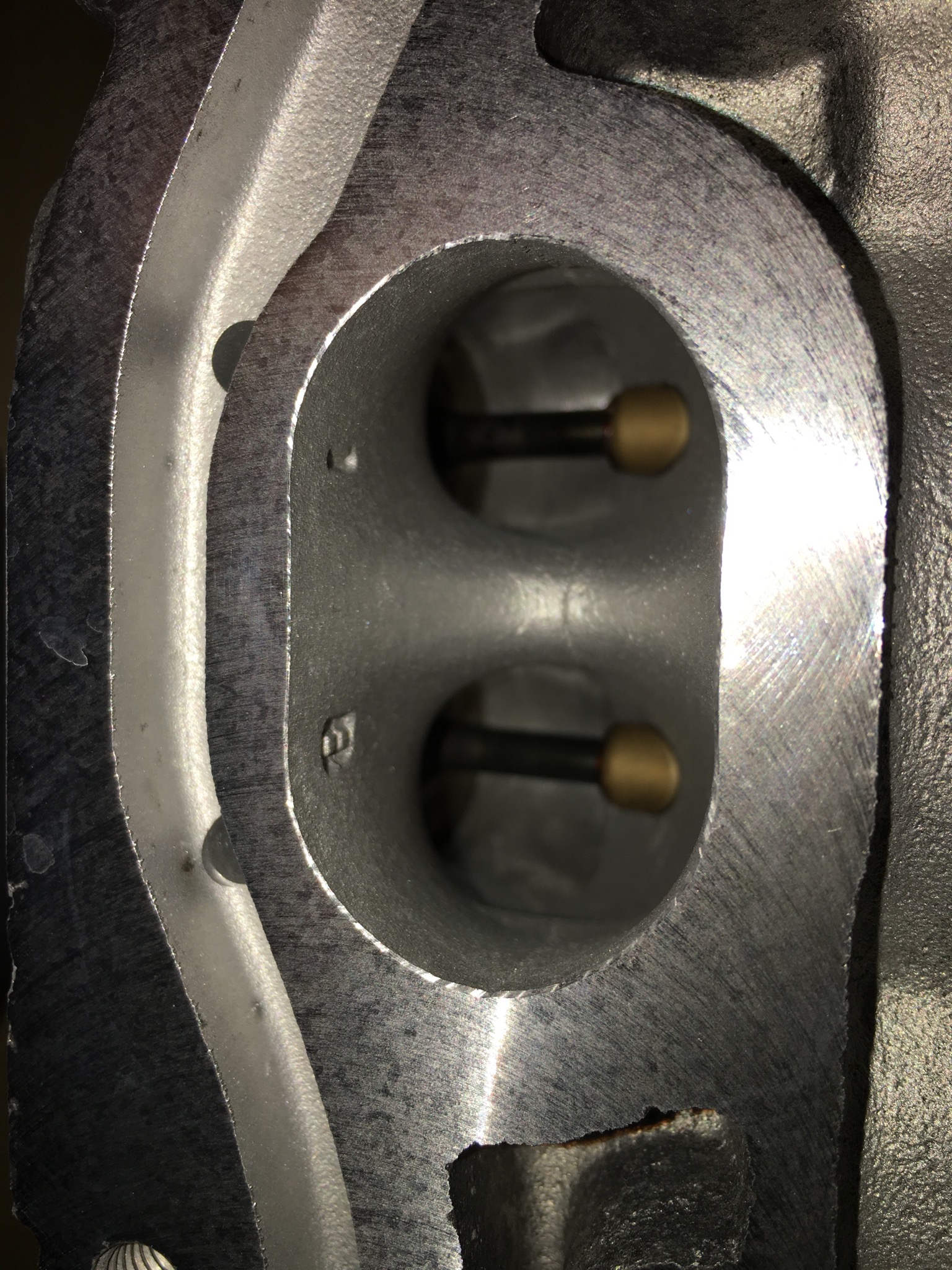

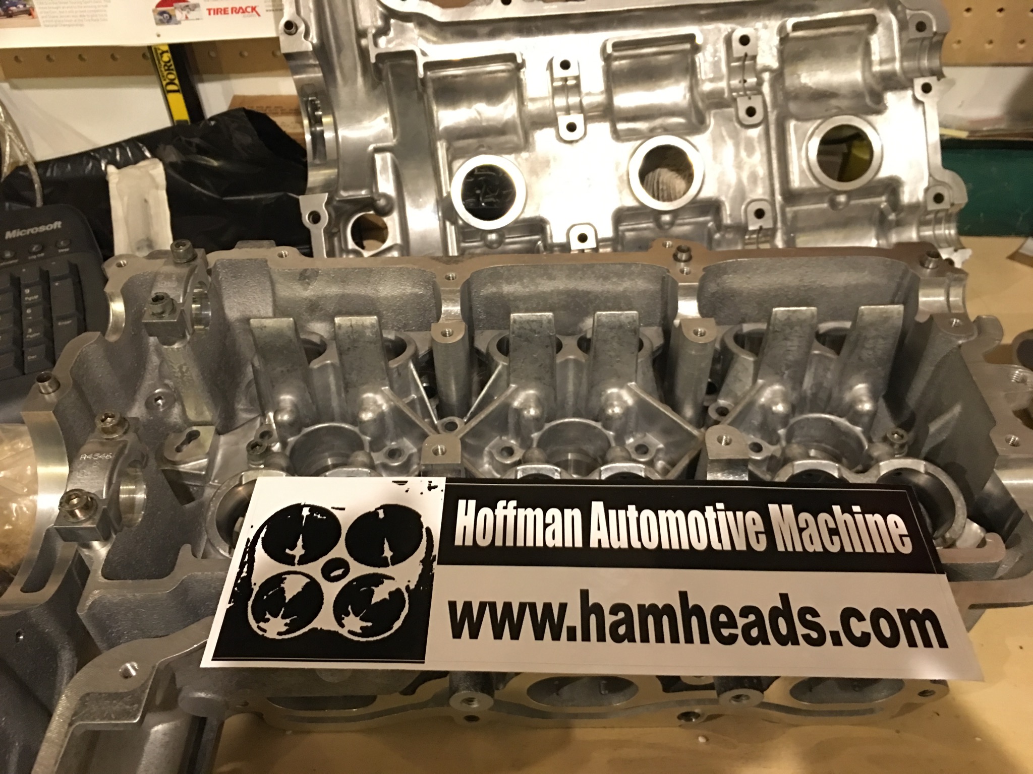

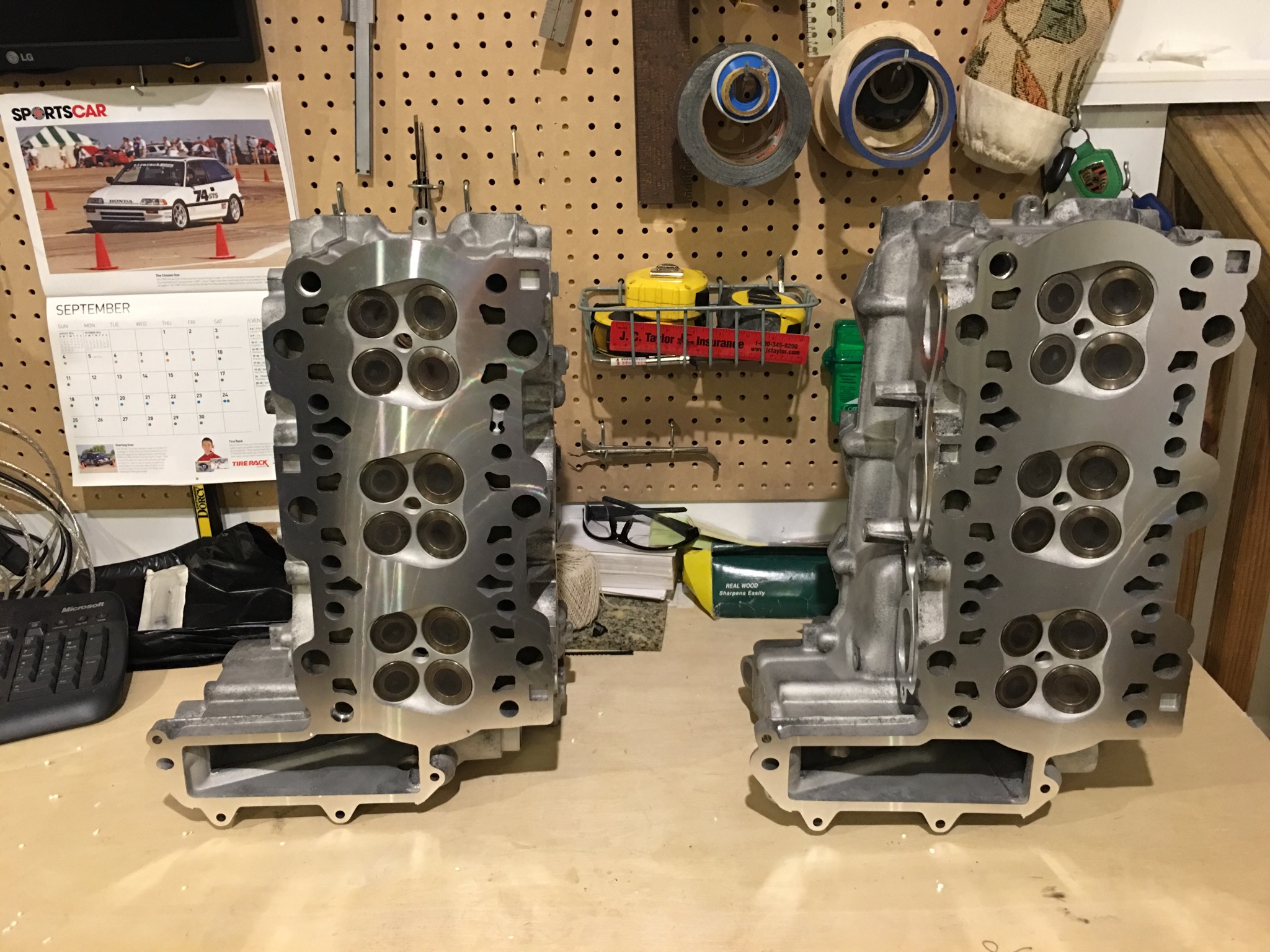

Got my heads back from Hoffman automotive yesterday. Wow, they look great! Unfortunately, there are a lot of "while you've got it apart" items that I want to tackle, so it may be spring 2017 before she's on the road again. I'll keep posting here as things come together.
