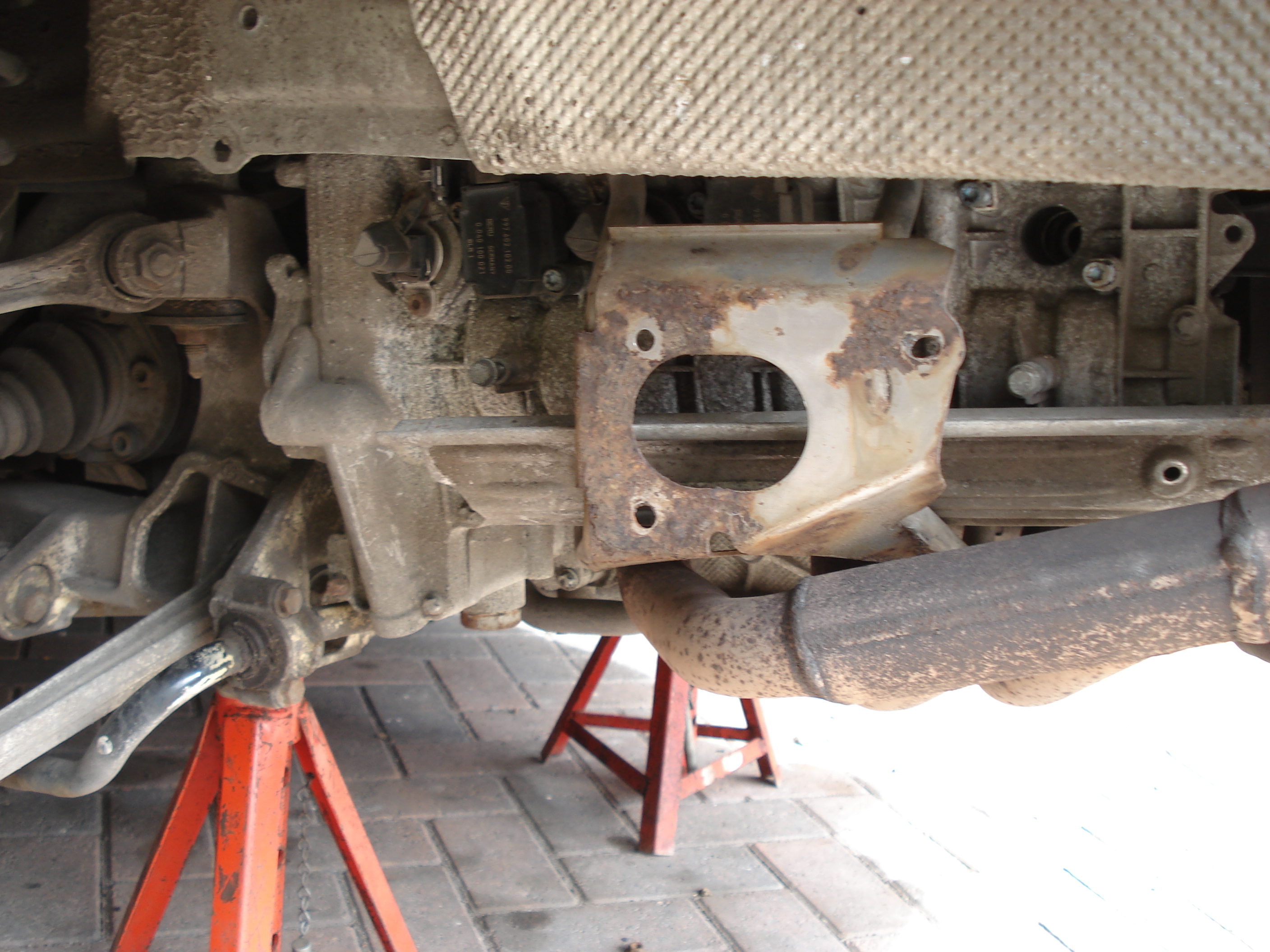

I replaced mine and the plugs when the exhausts were off. It's much easier and it's not the difficult to remove the exhausts.  I found a "wobble" bar was useful on the ratchet wrench as it's difficult to get a straight line.
