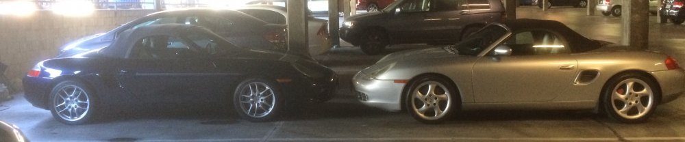

I have a 2002 Boxster S with 91k on it.  I just purchased it within the last 8 months and I've slowly been trying to tackle all the issues.  It is the 3rd one that I have owned, and I actually have a 4th one right now too (its an 03 base).
The problem I am having is that there is a clunking after I shift at low rpms (3000 range).  It is a very obvious clunk and it is very unsettling.  I had the motor mounts and transmission mounts replaced (3 total mounts), but the problem is still there.  It is also particularly noticeable when I shift at 2500 or so and dont get right on the gas.  Giving it gas minimizes the clunk.  I thought for sure this is motor/transmission mounts, and so did the mechanic.  But now the problem still persists.  I just drove the 2003 base and there isnt even the slightest hint of an issue like this.  The car with the problem has 91k (02 S).  The 03 base has 110k.
