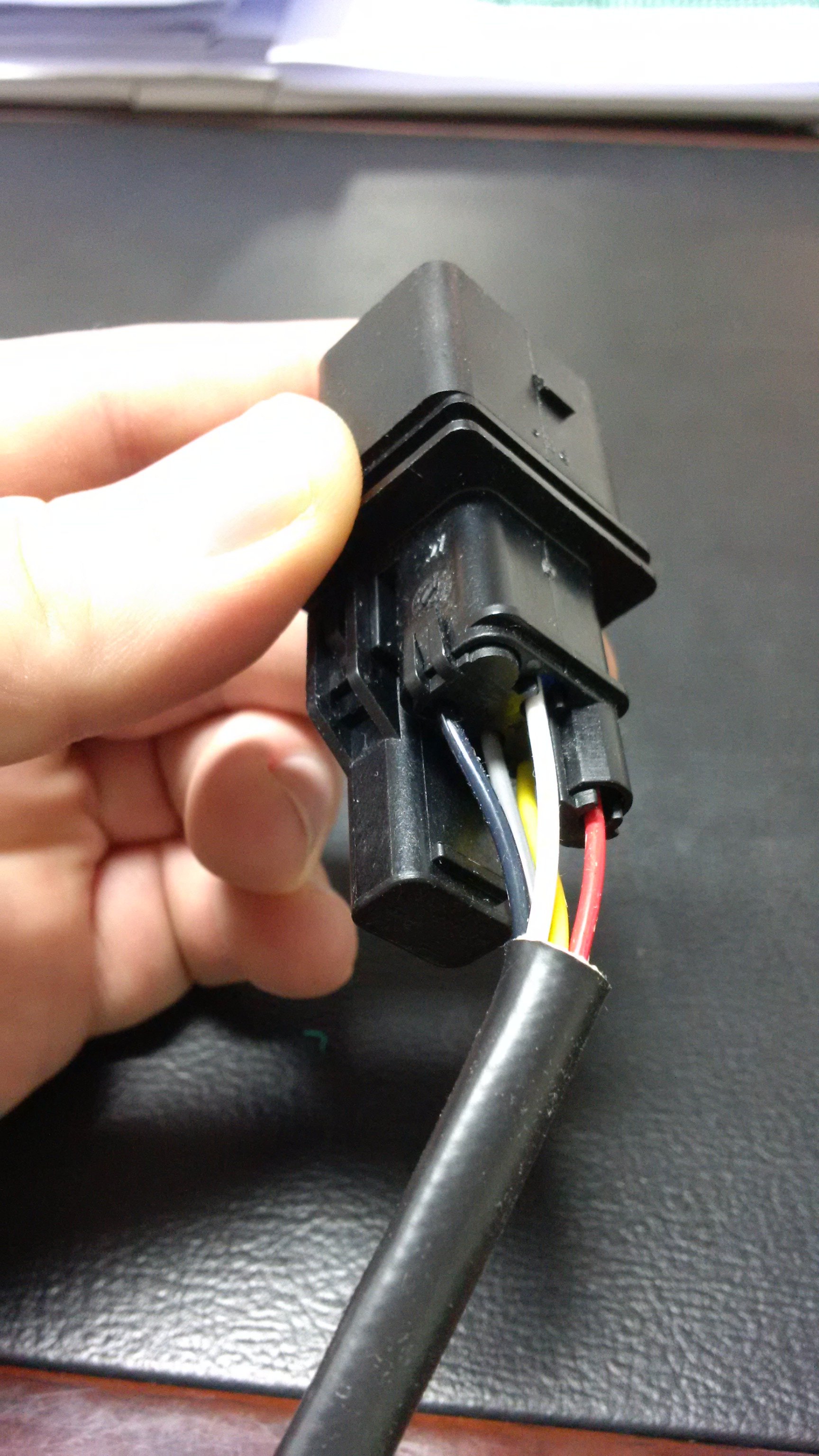

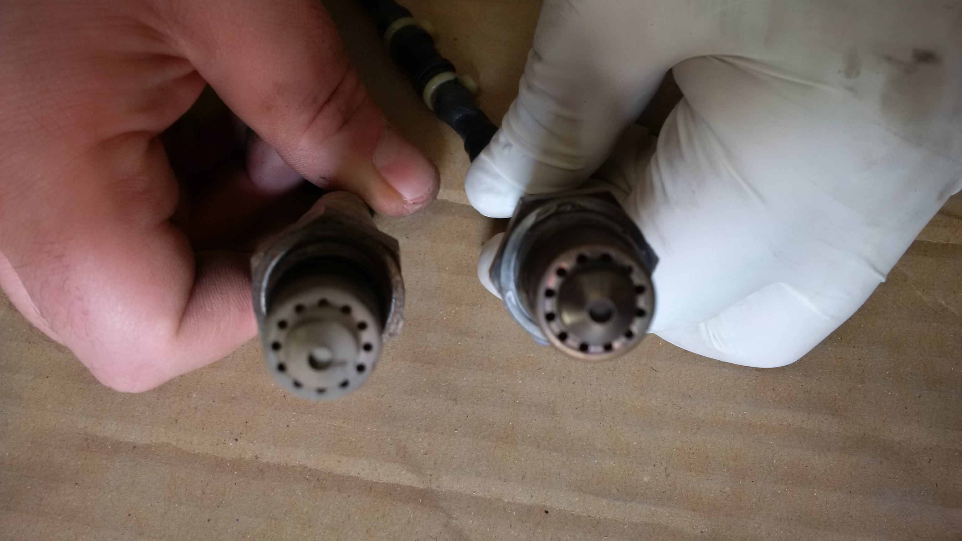

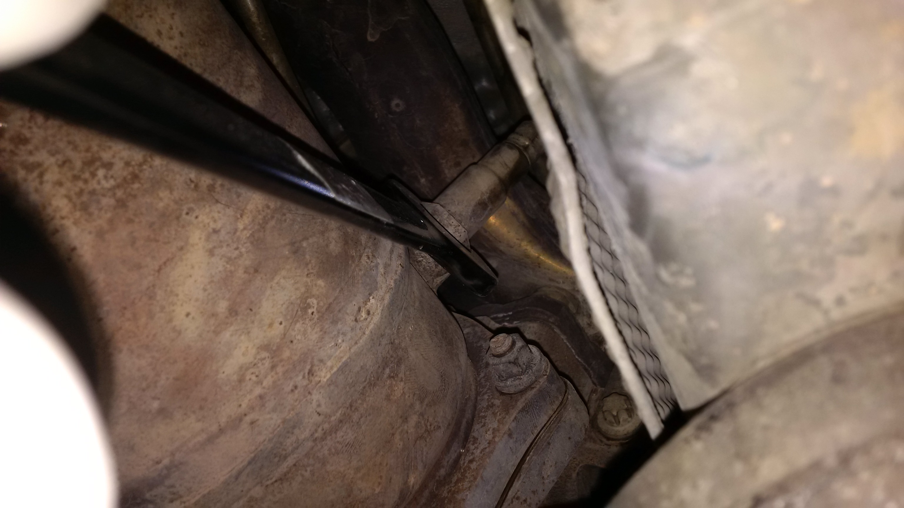

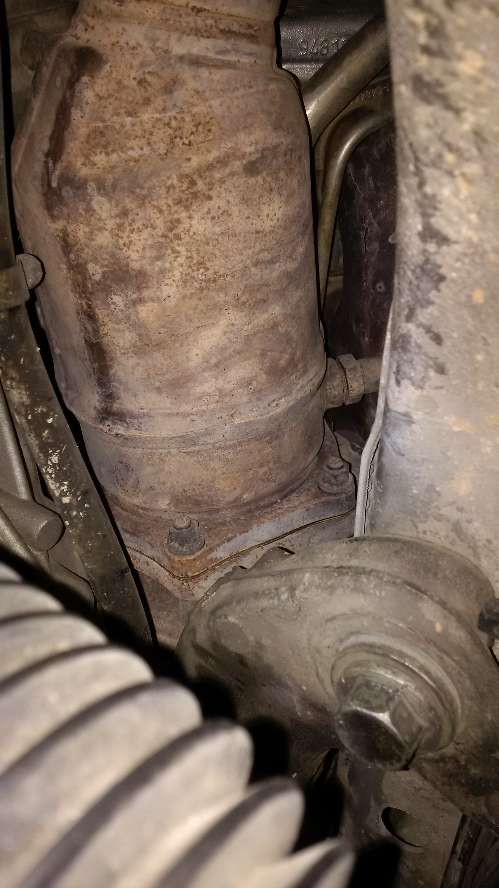

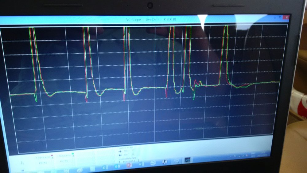

 Well the precat o2 sensor on bank 1 is installed, piece of cake to do infact. I was worried by the DIY I read of special tools and bending 22mm spanners. I had a sacrificial 22 mm spanner and blow torch ready but when I got underneath (wheel off and on a jack stand) I could easily put the spanner on it and with a 1/2 turn it was loose enough to hand thread it out. Burnt my arm on the cat because I'm impatient to let it cool down any longer, got Xmas prep to do as well today, great.
So yeah easy peasy to swap on this side at least.

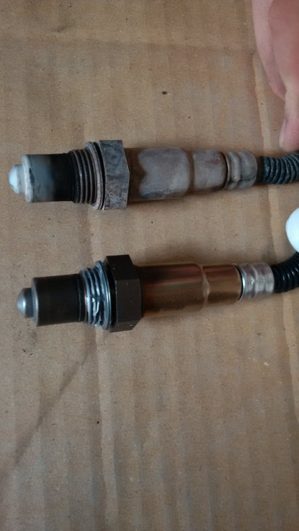

Take a look at the graph of both bank 1 (new) and bank 2 existing precat wide band lamba sensors. 4 times snap throttle and they look perfect. Before the bank 1 sensor was not reaching peak milli amps at all and lagged behind the bank 2 sensor. Now they are almost a perfect mirror image trace. :clapping:
It is likely the sensor was damaged as a direct result of this banks previous blown head gasket (coolant into the combustion chamber) contamination of silicon which makes the sensor "lazy".
Unfortunately whilst I'm faffing around with this graph and pictures I'm hearing a whine from the throttle body I think. Ahhhhhhhh ffs can anything just go right and be f***ing fixed for once pls. :censored:
The drive home was uneventful and short, I don't know what the verdict is driving wise yet.
Need to do some km's and see how the fuel trims adapts, if the the stutter is reduced or not and if the fuel economy is better.
