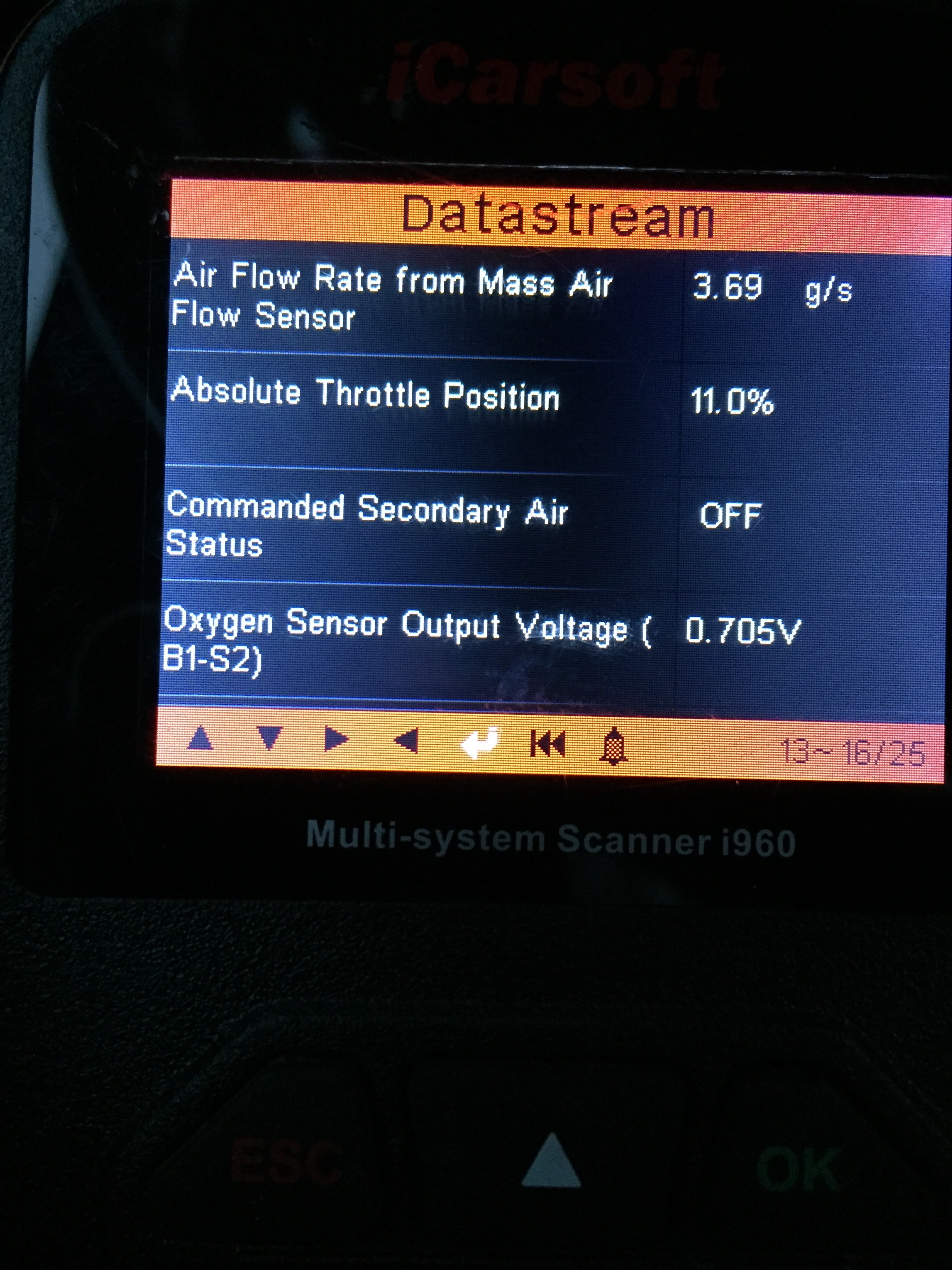

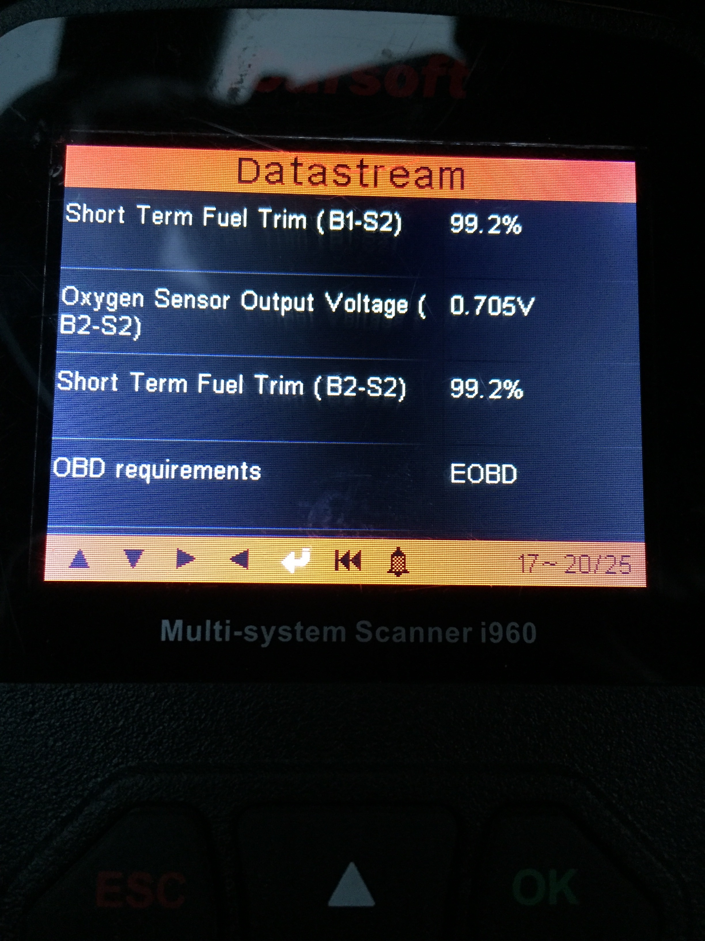

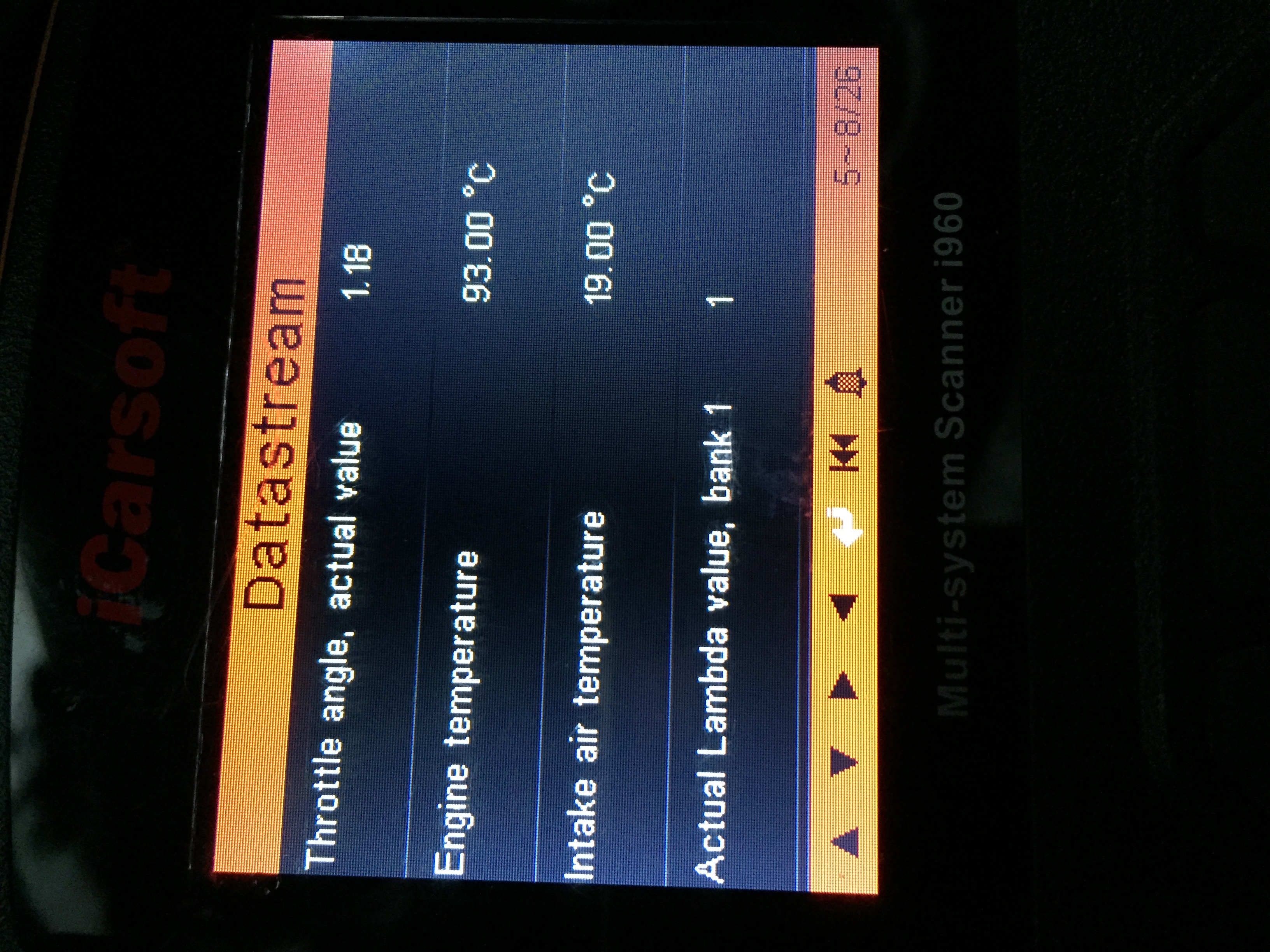

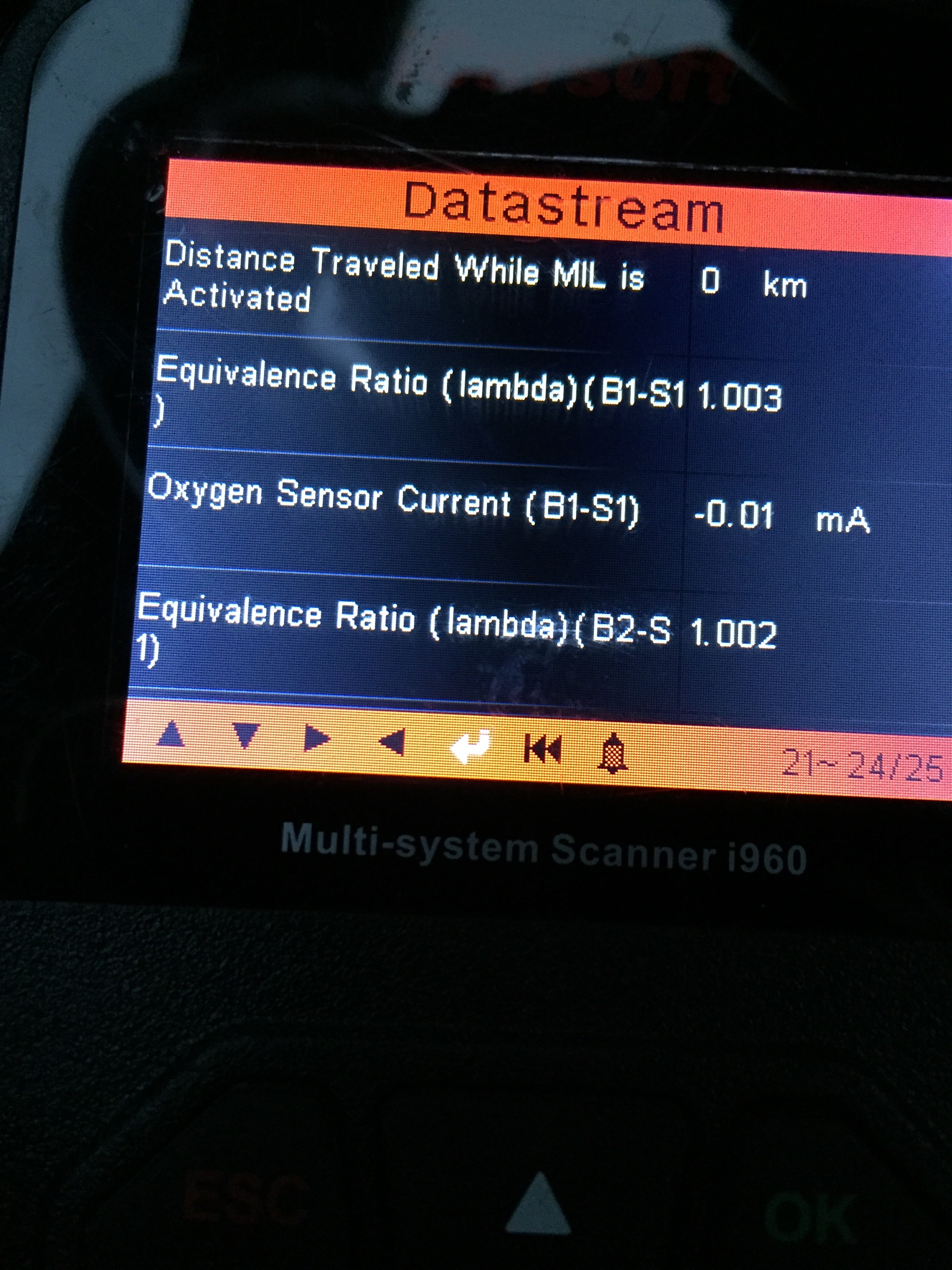

maybe some professionals could please have a look to the OBD readings and try to analyze the values.
Actual lamda value bank 1 and bank 2 so different numbers but i cant interpret.
For idle I think your MAF reading is fine. Your Lambda values are close (Equivalence ratio). Not sure what the first two Lambda ones are as the 102.39 makes no sense. Lamda or 1 = 14.7 to 1 A/F ratio, optimum burn. Optimum power is a little richer around 12.8 to 13.2 to 1 which is where a Cayenne on Wide Open throttle will run, we'll call it about Lambda .87 to .90.  It would be interesting to see those two Equivalence ratio's on WOT when you're making power. See if your program has instructions to see what the meanings of the Actual Lambda values in the first pics are as they should be close to the same on both banks. The Equivalence ratio reading say S1 which means coming from the first (Wide Band on Turbos) O2 sensor which is what you want, pre-cat.
Thank you Mark.
The OBD device is a Icarsoft. I will see if i can find some explanation.

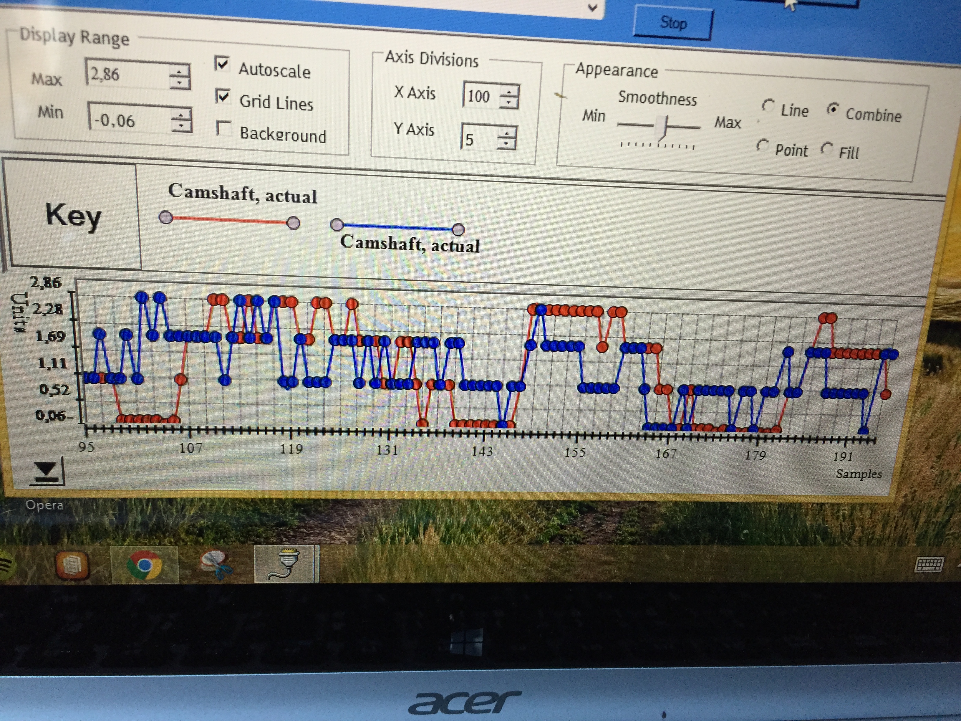

Thomas your data pretty much is saying at idle the car is running fine.
Your issue are during acceleration same as me. To see what your lambda sensors are showing by way of a graph would help diagnose if either or both sensors are working correctly or not.

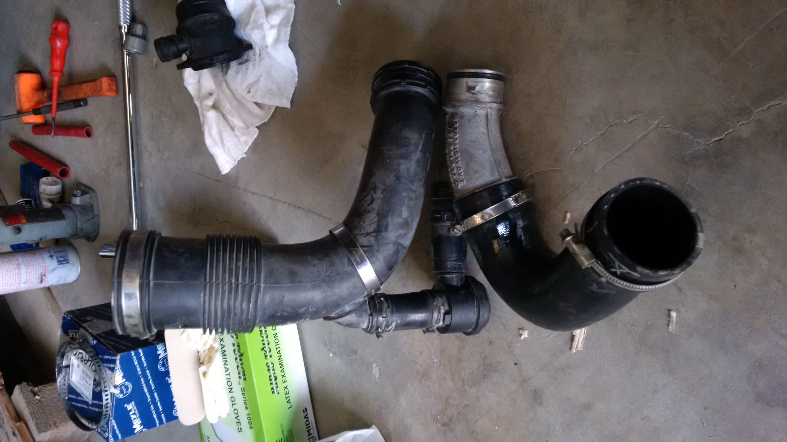

The fact you have overboost code tell me that your problem revolves around the turbo piping, the wastegate or the manifold area pipes.
have you tried removing those flexible hoses connecting from bank 1 and 2, and the pipe 5 I had split also I assume the small check valves you check when replacing the silicon hoses the other day?
Lastly as we was emailing earlier you said the whistle noise started after replacing the driver side DV, time to jump back in there and recheck everything again top to bottom.
Whistle noise is almost always a boost leak, when boost is leaking out the dme holds the wastegate shut longer to build up the boost it wants to see in the manifold, when you shut the throttle it will spike up and over boost code will pop up, then performance is reduce until you switch ignition off or reset the dtc.
When you have the turbo inlet pipe off, feel the turbo impellor wheel for play, there should be no movement side to side up and down. A small amount of movement in and out is acceptable. Also spin the impellor and check it's not rubbing and also spins freely.
A faulty worn turbo can cause overboost as well.

i changed almost every pipe which is possible.

I used pipes with the same diameter like the original ones.
Heat resistant up to 240 degrees celcius.
pressure lines from N75 valve to wastegate: inside diameter 4 mm.
Many small pipes arround the y pipe have same size.
the bigger pipes which you see on the pictures from yesterday have 9 mm inside and they fit very good and tight.
One pipe which is going  from the change over valve at the back of the engine along the fuel rail on drivers side to the front is 6 mm inside diameter.

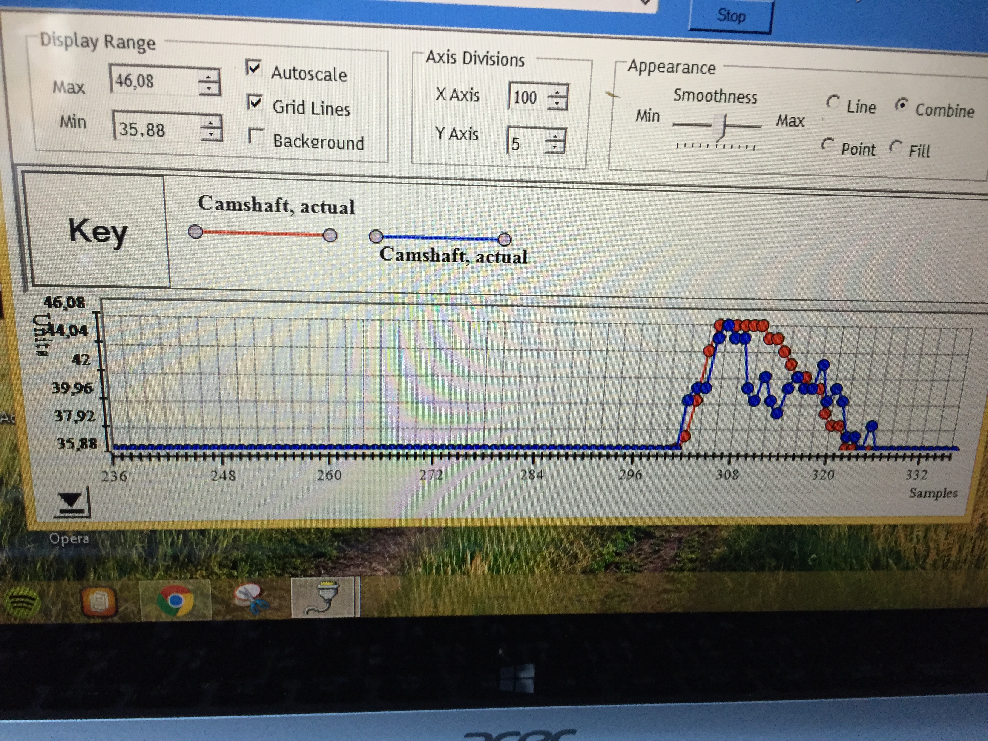

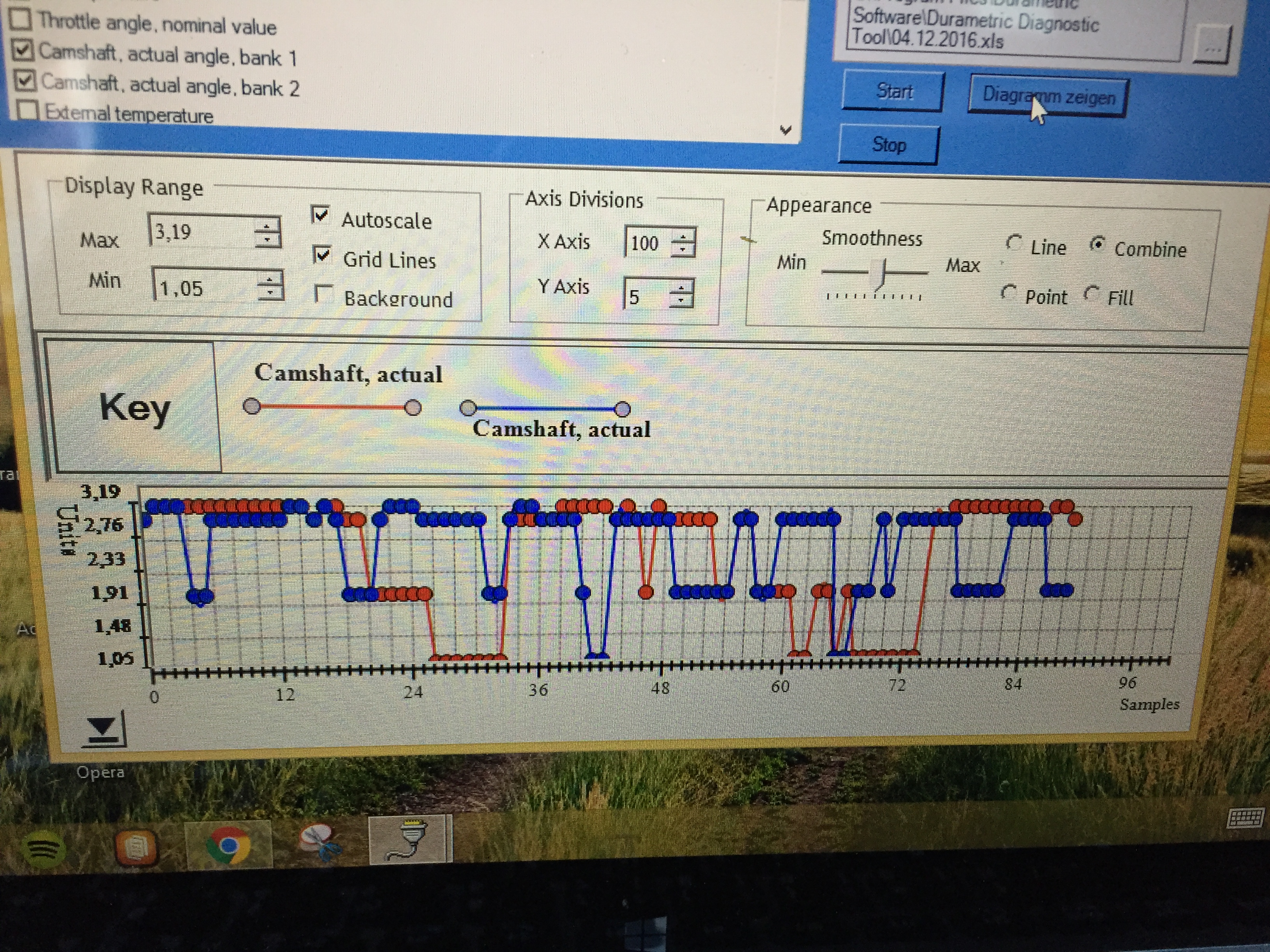

So guys i need your help here.
Still affraid i could have a timing issue. I read the values with my durametric cable but i cant interpret the numbers. Maybe somebody can assist.
The lower numbers are at idle and the higher ones ar 2000 rpm.
2 hours ago, ekstroemtj said:
Grafik
Thomas from my understanding the difference can be from -6 to +6 deviation between each bank, you have only a few degrees at idle and at 2000rpm.
I your idle rough or smooth? If smooth you don't have a timing issue I very much doubt.

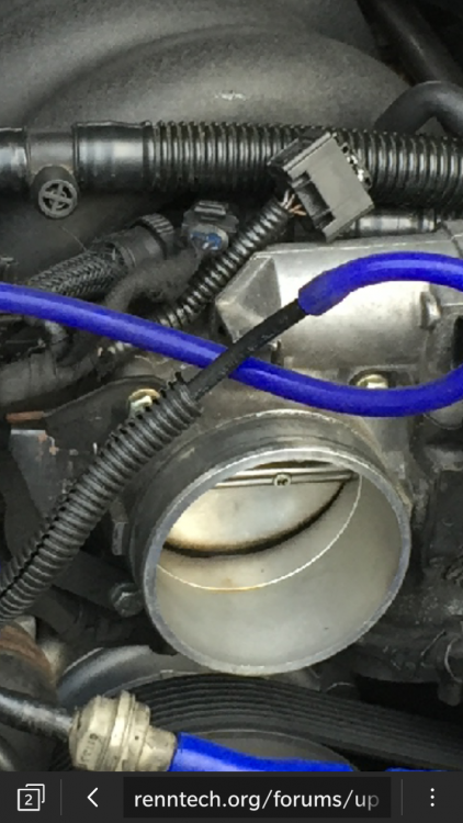

Thomas when did you last remove the throttle body and clean it?
This is yours from your picture and I noticed its quite dirty.
This isn't going to cure all your problems but may help or at least not add to the problems.

throttle body looks so bad?
how can you be shure its the purge valve? Cant it be the evap canister which is sitting in the wheel housing behind?
Yes that's dirty I think. A quick clean is 30 mins of your time and a quick throttle body adaption in your software.
