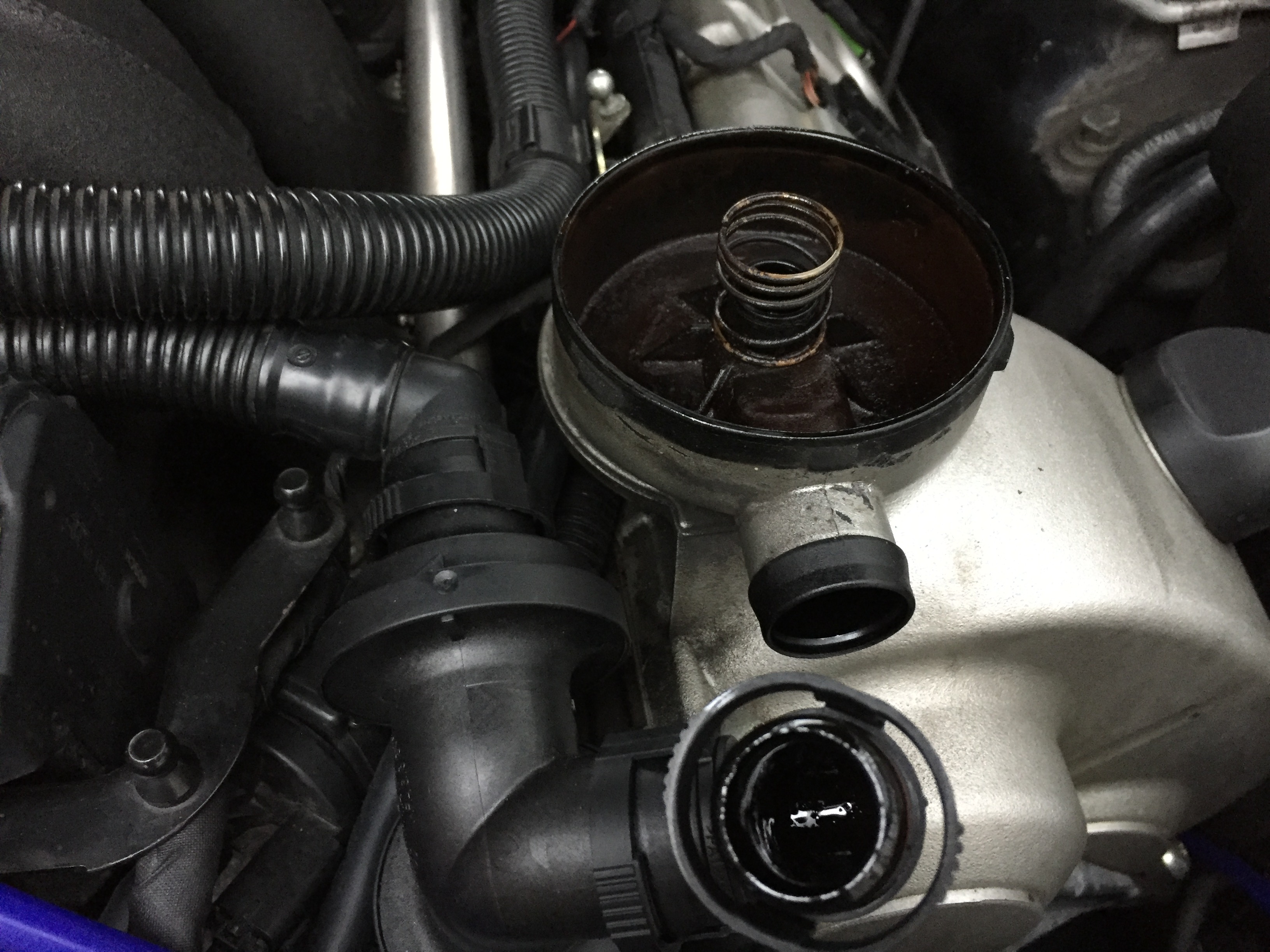

OK, one quick paranoid question - it's ready to take off, but to get the pin out to remove the Y tube you have to disconnect the electrical connection to the throttle body. If the engine is off and the key is out, will I have to have reset any codes after doing this? There seems to be something wrong with my OBD2 connector...and I guess in general, can you disconnect electrical components on the engine when it is off without tripping a code? Or are there systems that are continuously monitored? Thanks!
Reflecting on my workmanship comment, he we go again – on one side and in the Y pipe there are metal rings to take the force of the ring clamp, but on the passenger side it was missing! Consequently the pipe is crushed in a bit, and maybe not sealing like it should. This is why I work on my own vehicles!

the hose coming from intercooler going into y pipe should be fitted with 2! clamps each side. How is your y pipe looking inside? Oil? Dry!

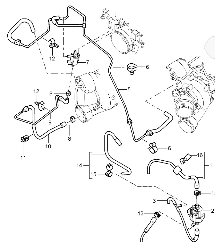

I replaced today the pressure line (9+10 on the diagramm) which is going from n75 valve to the turbo. Dont know what it does?! I blow into the pipe and i hear the air coming out on the air duct which is connected to the air filter box. Is this right?

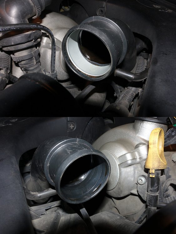

The hose (it does have the 2 clamps) on the drivers side and Y pipe were a bit oily, but a lot better than before I drained the oil from the intercooler hose on the bottom. What did surprise me is that my Y pipe is starting to de-laminate inside. You can see the plastic cracking and coming loose at the arrow:
Hi Thomas, one night of working on a site and I missed so many posts! Lol
Ok this pipe is the boost reference from the passenger side turbo. The n75 valve uses this boost pressure to control the wastegates opening. If this pipe leaks usual you get Overboost code. I changed this pipe the other day and posted the pictures. As below pics it the lower pipe with the securing clip attached to the alternator.
You have to take the turbo pipes off to access this pipe and replace.
lewis... the pipe is not leaking.
Just when i blow into this pipe, air is coming out at the air hose which is connected to air filter box.  Is this usual?
Normal yes pipe is straight through. No check valve or anything so you can hear the air travelling into the turbo and back around up to th airbox.

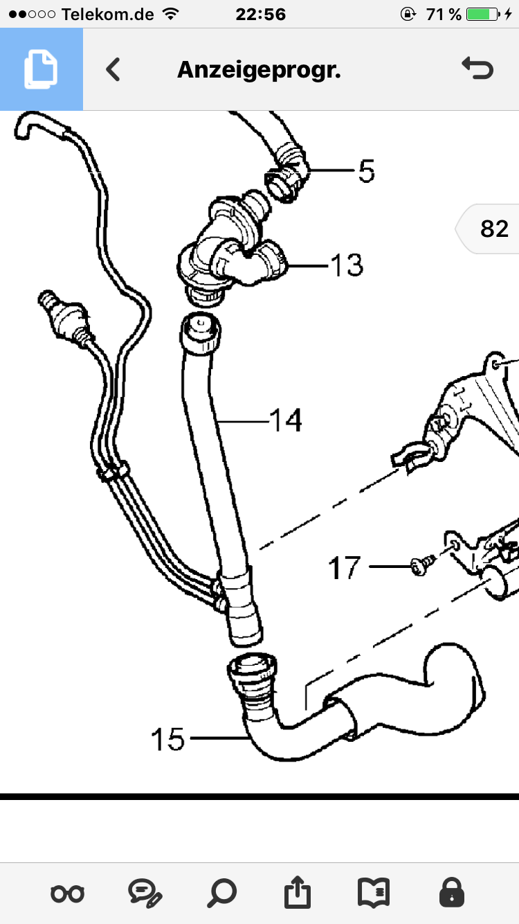

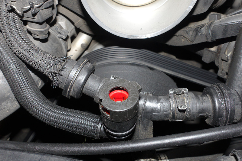

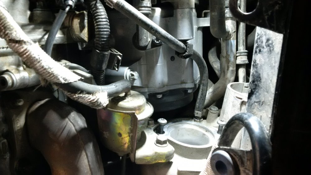

Some time ago the picture from the area close to the driver side turbo charger was posted. See below the pic with the arrow.
Is this the hose 14/ 15 ? If yes, is a replacement possible without taking away a lot of stuff?
I need to replace mine.
It's pipe 15 thomas.
To get access you will need to remove airbox cover and the turbo intake pipe/MAF sensor then you can just about reach inside to get your fingers on the pipe 15 clamp to squeeze the tabs and release the pipe off. Then separate from pipe 14 and wiggle out from between the Serpentine belt.
If you are going to replaced 15 I would also replace 14 as well it only makes sense. You will need to remove the Y pipe to access the small pipe and non return valve underneath the Y pipe.
I tested mine when I stripped it out the other day to change the orings. My pipe 14 and 15 was new when head gasket work was done.

6 minutes ago, ekstroemtj said:
mine looks terrible. Somebody before try to repair something here. Maybe this could be part of my problem.
I bet that leaks!
Buy 15 and 14 fit new and forget that as a possible problem so you can move on.

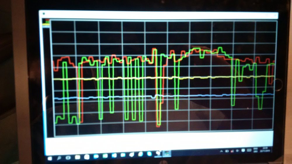

Ran diagnostic last night looking at the pre and post cat o2 sensors. The postcat sensor reading is in volts and the pre cat "wideband" air/fuel lambda sensor reads in milli amps (current).
What I found is the bank 1 sensor 1 lambda sensor is not producing enough current milli amps, take a look at the first picture of 4 times I repeated snap throttle opening and the bank 2 sensor 1 yellow line hit max milli-amps where as the blue line bank 1 sensor 1 doesn't get half way to rich milli-amps. So this could be the issue with the stutter hesitation lazy wide band sensor! As my fuel trims are good and the idle is steady and lambda 1 ie 14.7:1 I dont think it's any other possibility like maf (new) ignition (all new) or fuel (new filter and regulator). No exhaust leaks.
During cold start and warm up the engine drives very well, once warm it stutters all the time.
Anyone disagree or have more experience on this??

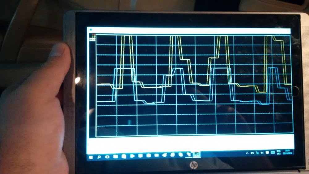

Second picture is the bank 1+2 sensor 2 post cat 02 sensors in volts.
You can see the red line which is bank 2 sensor 2 is normal stable line as the cat does its job whereas bank 1 sensor 2 green line is fluctuating either as a direct result of the wide band sensor 1 lambda fault and/or the cat efficiency is poor.
As the post cat 02 sensors have no effect on air/fuel mixture I don't intend to address this yet.
I am ruling out also a clogged cat because that would highlight performance at higher rpm, the engine would feel suffocated whereas at high rpm the engine runs very well.

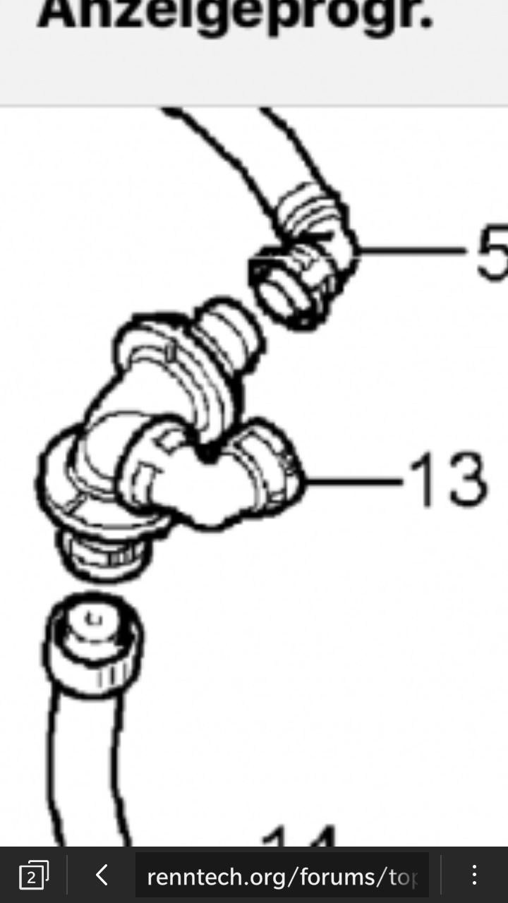

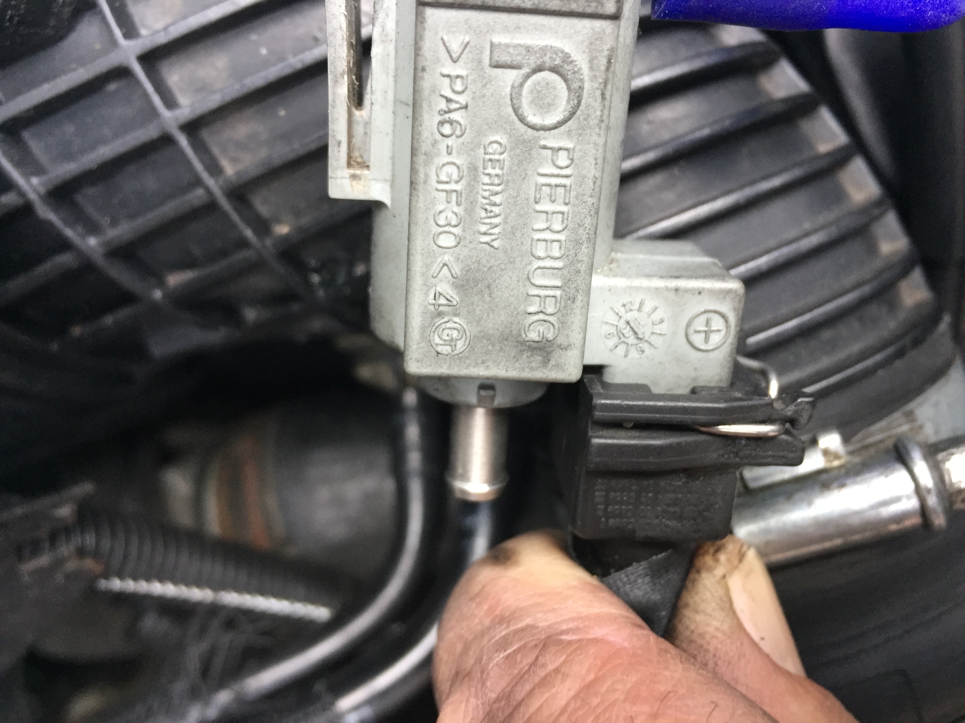

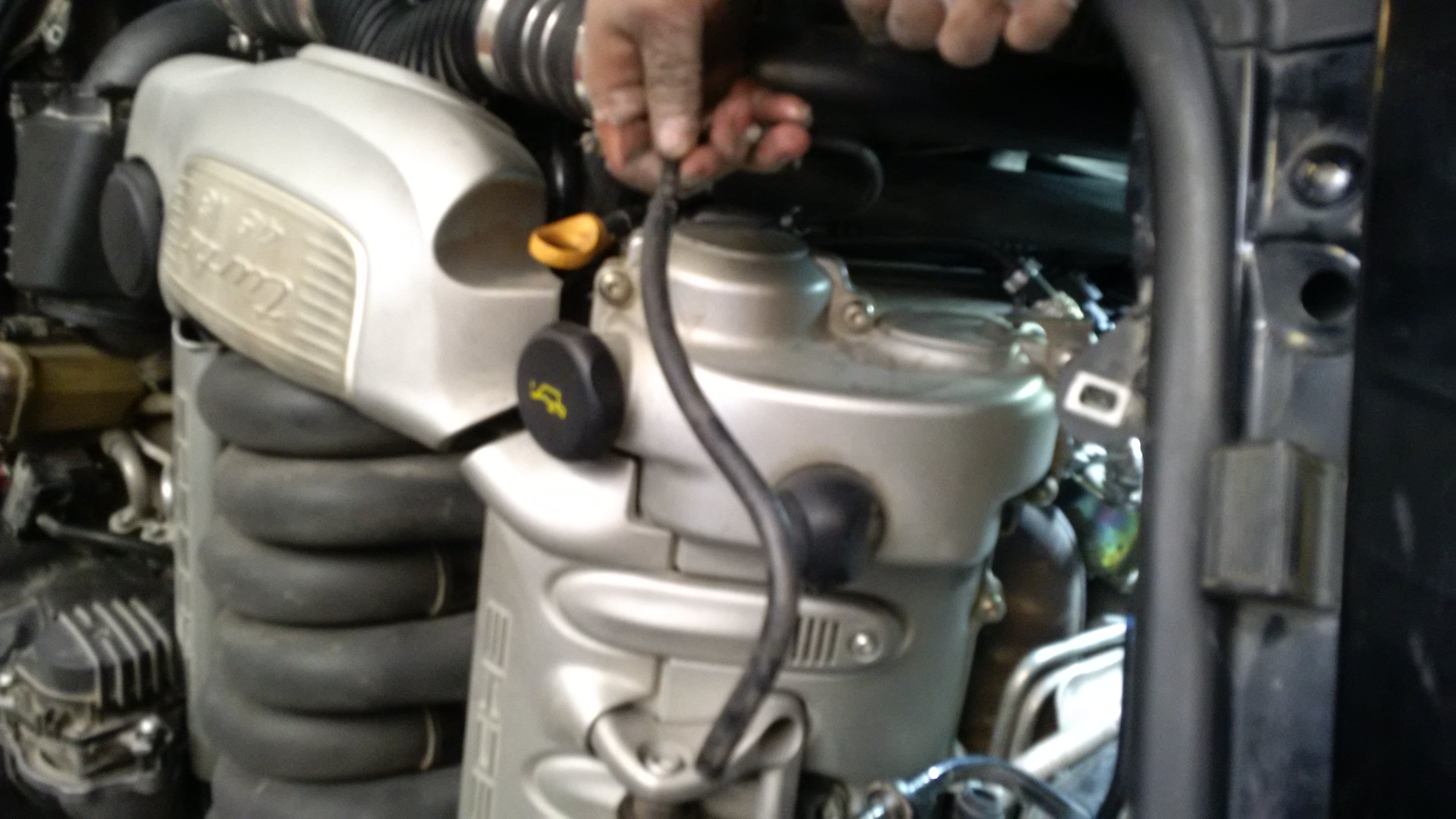

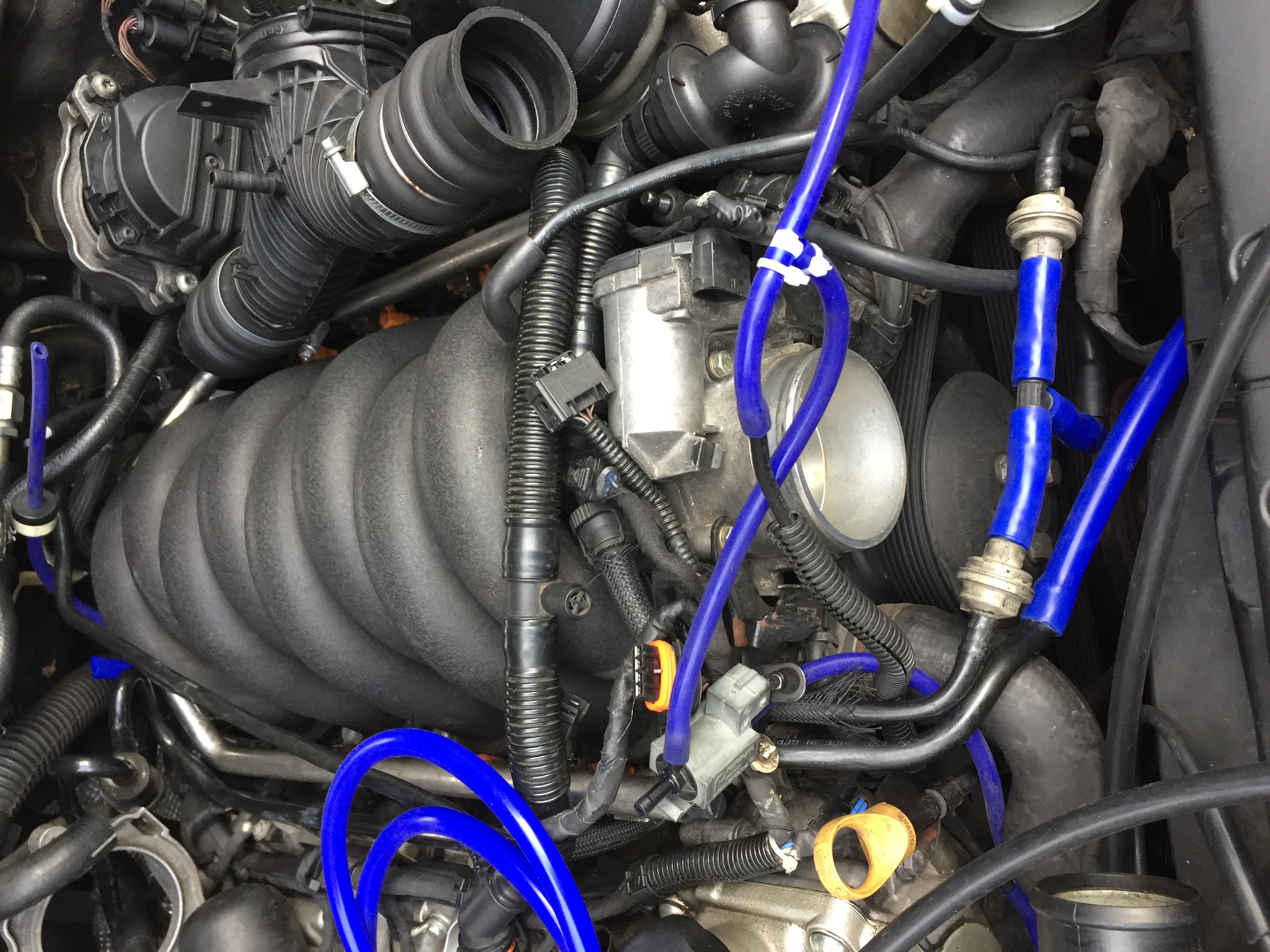

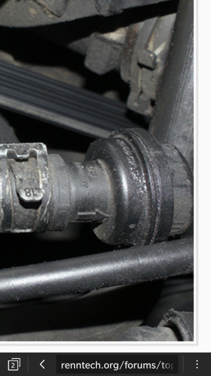

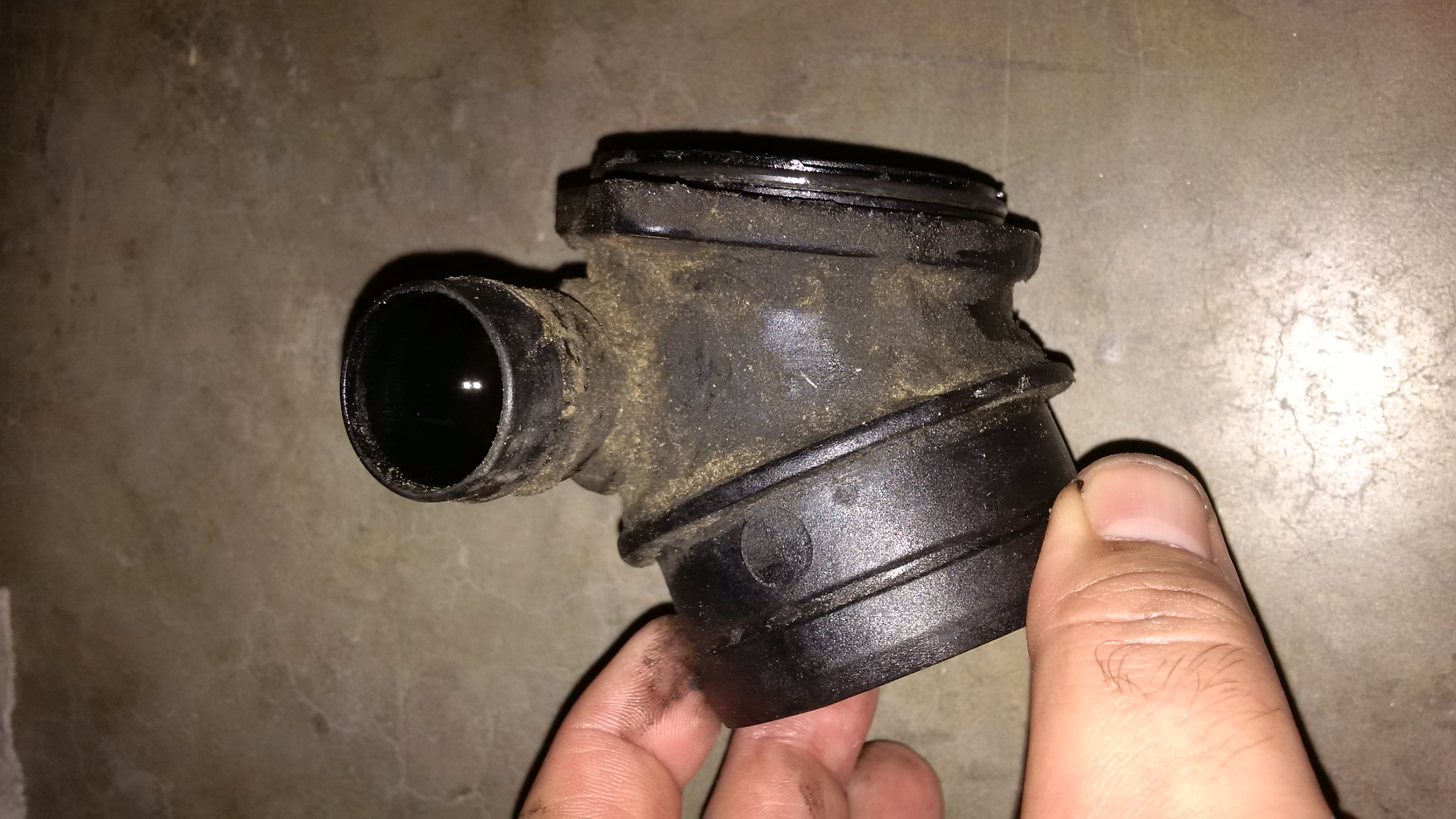

Did you check the black colour check valves,? First picture.
They have an arrow which shows the open direction, blow and suck hard to confirm they work.
Also check the 3 way check valve 2nd picture below. Blow into pipe where arrowed number 13 is pointing, the air will go through to either other port as normal operation, you need to cover one port to get the other to open as your breath isn't enough to open both simultaneously against the diaphragms. Then blow back though the other two port and you should not be able to blow any air at all through either.
There are some more check valves white and black/ grey at the back of the manifold which also can be checked for functions and the vac pipes too.
I've learnt with a vacuum leak at the manifold intake side the idle can mantain with the throttle body whining away trying to compensate for the extra air, when accelerating the throttle response is rubbish and hesitant, boost takes longer to build as the air escapes.
If you have a divertor valve problem ie split diaphragm or vac pipe running to it is split/leaking the car is very jerky and will under boost as well +-0.5 bar only, lift off surging of boost which is not released from the turbo is felt as the jerkyness.
Leak around the injector would would my first thing to fix, leaking fuel or leaking air in either way can't be healthy. Pictures pls......:biggrin:

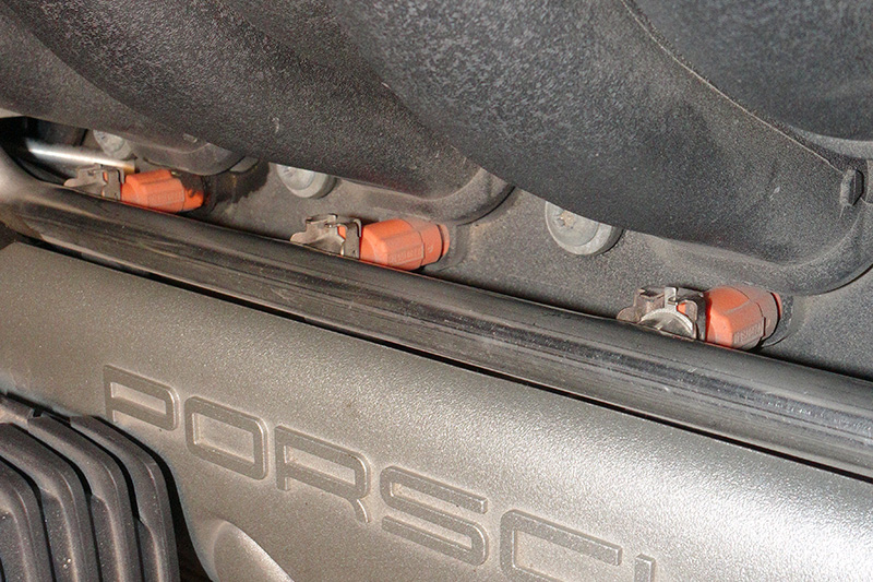

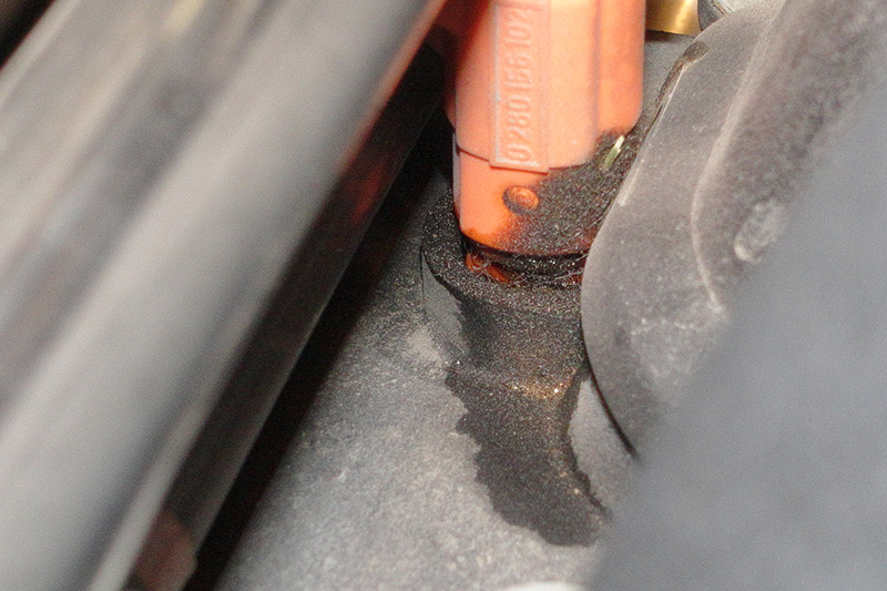

Pictures always! Here is the leak from the rear injector, the others are fine.
I suppose I haven’t paid much attention to this because on my old Jeeps most of the injectors leak and they still run fine! - but then again, this isn’t a Jeep engine.  I have also had engines where as soon as you pull the fuel rails off, all the o-rings start leaking, so I guess I try to avoid doing so. I am not sure how long this has been like this – I need to clean it off and see how it builds over time. But maybe this does contribute to the variable rough idle and maybe even the hard starting.
The injector orings are cheap, my advice would be to remove the intake manifold this gives you the opportunity to do the following:

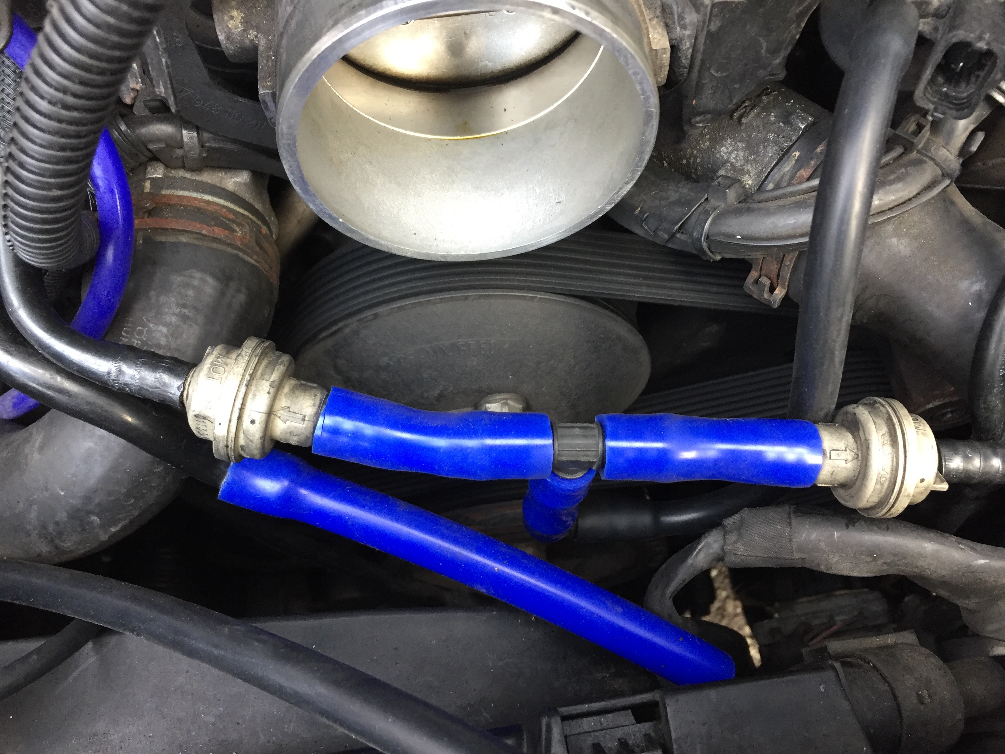

i changed almost every pipe which is possible.
The connection system under the y pipe i also replaced with new tubes.  Same on the firewall. I changed the CVS membrane which i ordered from russia.  So what, same hesitation as soon as i hit the throttle a bit more.
