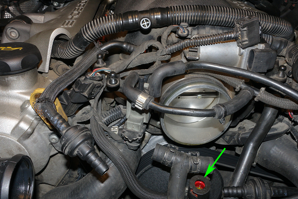

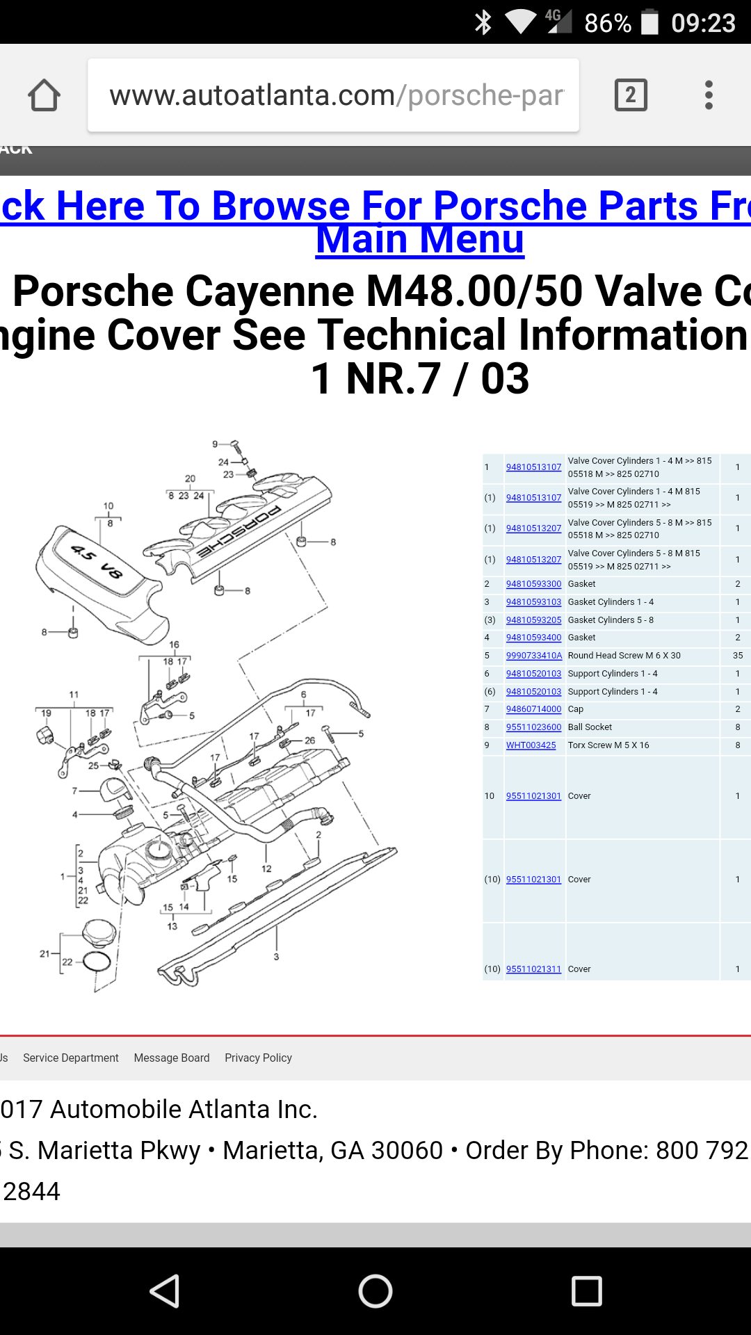

Mike I replaced these and you don't need to remove the valve cover or sensor or anything.
Buy the seal part number 4 from Porsche not too expensive! Don't say that often do we!
Then remove plastic cover and disconnect electrical connector.
Use a wide strong flat blade screw drivers to deform the old seal enough to pull it up and out.  Be careful not to crack or scratch the chappy plastic valve cover recess. Wipe Clean all surfaces.
I added a smear of red high temp gasket sealer to my new seal outer edge to be sure it would seal nicely and slid it in and home with a socket sat on top and a gentle tap.
Job takes about 10 minutes per side. Piece of p*ss.

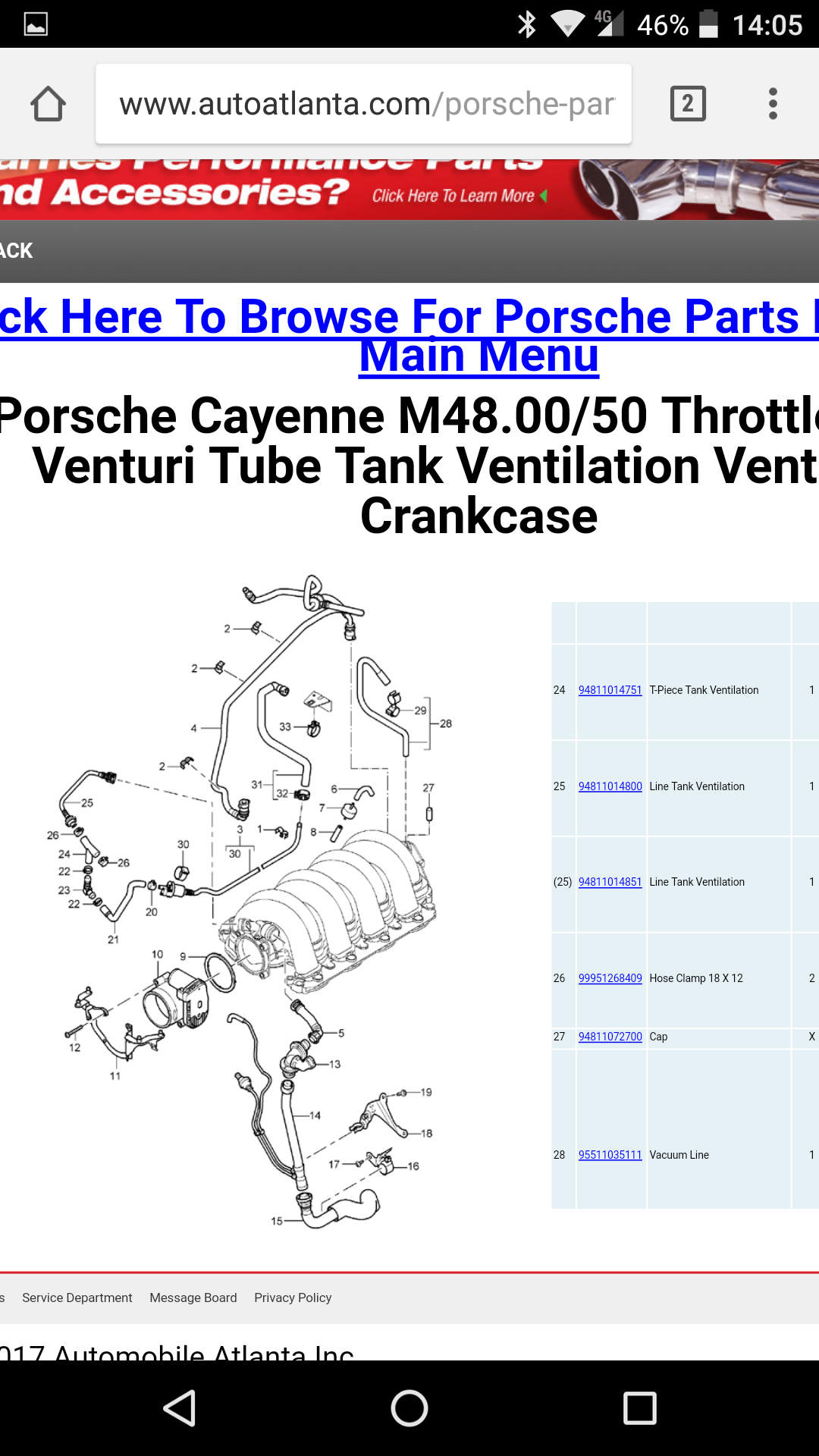

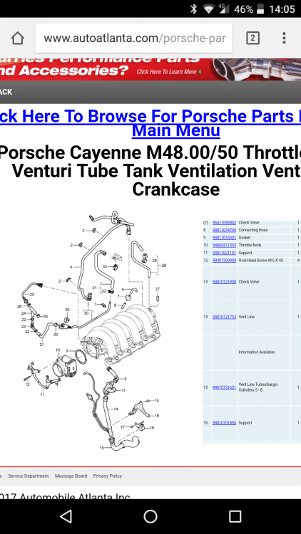

Part numbers attached picture is items 14 and 25 for the valve you have to buy the whole pipe section. Rolls eyes.
These one way valves ( just noticed they have arrows on them!) are normally open or flap around sort of open and require boost pressure from the manifold side to close properly or vaccum to open properly. Get your head round that!
I think during idle vacuum 25 is sucked open and draw through vented tank fumes via the purge valve if it's open. Then when you're on acceleration the boost pressure closes 25 and 14 is actually sucked open via the turbo intake pipe where it's connects to.
So the simple test is to suck hard on the disconnected open end of the pipe(s) as per your picture and they should be closed.
Edited by lewisweller

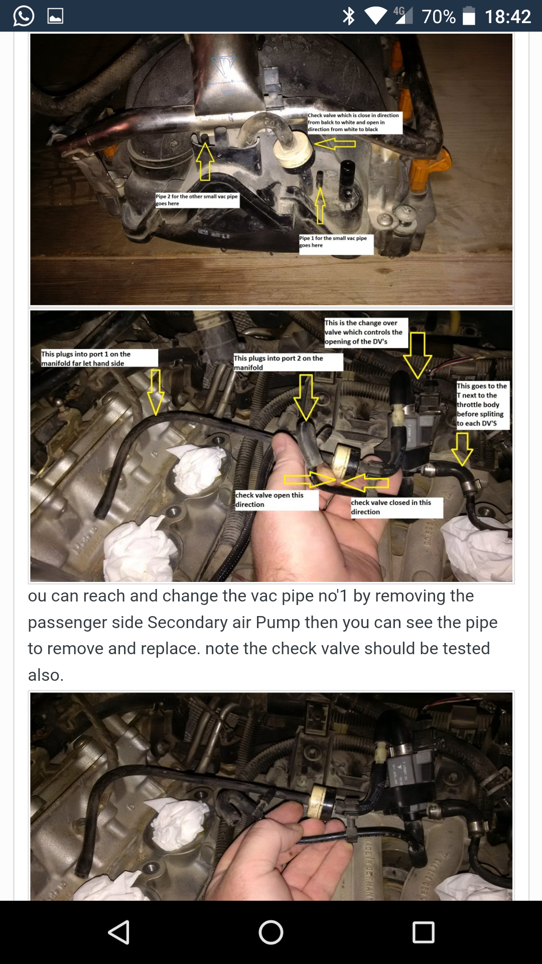

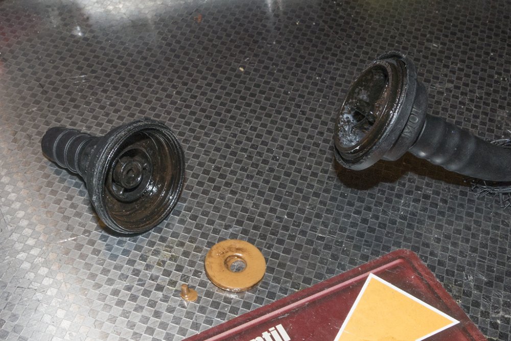

So do you still get the oil smell Thomas? Because the more I look into this the more I think it is an EVAP system problem not a leak. I fixed the check valve - if anyone is interested they do come apart if you pry at them:
You can see the center of the diaphragm was ripped out - some glue and a small piece of latex glove backing and it sorks like new again. But the problem isn't fully solved. Drove all day and didn't get any error codes, and didn't smell oil. But I went over a hard bump, smelt the oil and then pulled over and check for codes and sure enough the P0441 came back. So I'm thinking the oil smell must be some venting of the crankcase.
The check valve seems like it was part of it, but there is still something else going on. Lewis, do you remember the air flow through hose #4 on your diagram, the one from the bottom of the Y pipe to the back? It splits into one line that goes to the air pump, and the other into an elbow into the manifold, and another that goes off to the drivers side somewhere. When I suck/blow into it there is some air flow in both directions - I get the feeling there should be a check valve on this line because it goes right into the intake, and you would be always bleeding off boost pressure, unless there was positive pressure in it all the time.
You have to blow pretty hard into it to get air to flow, but it does.

Yes pipe 4 is the venturi pipe, it creates vacuum for the brake booster by allowing manifold pressure to bleed off and back around to the connector located in the Y pipe in front of the throttle. This air flow even though it's positive pressure cleverly creates a vacuum in the other tube which Tees into another pipe linked to the vac pump and around to the booster.
As the air in the system is not lost this doesn't affect the MAF measurements.
The vacuum pump is therefore afforded a rest.
When your at idle and pump the brake pedal repeatedly you can hear the vac pump kick in as the venturi pipe isn't able to create enough vacuum at idle if your pumping the pedal. This is how to test the vac pump works. And also the engine off, brake pedal pumped until hard and held down, then engine on, pedal should drop as vac in booster increases.
So by blowing or sucking pipe 4 I think it is correct it is open into the manifold. Screenshot_20171115-184250.thumb.png.993b67d888b3aeb6683329ad73ae59e9.png

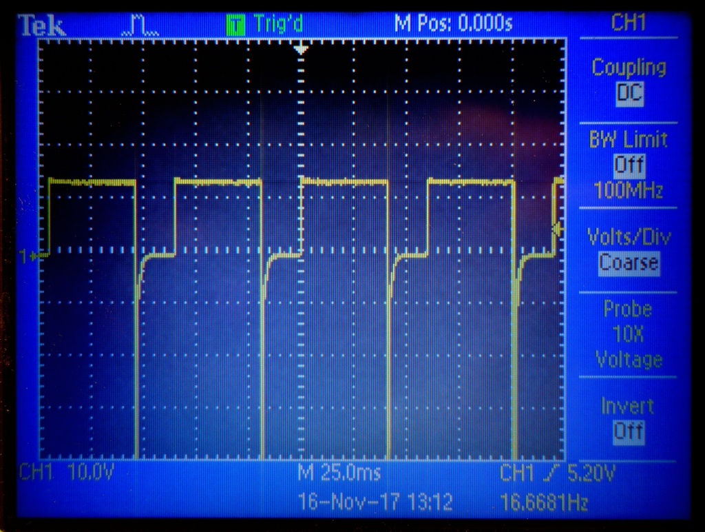

So a good 13.7 volts are getting to it; when I hook it up to a current source it clicks and opens and closes smoothly and without fail, and when I accidentally disconnected it while the engine was running I got a P0444 - EVAP Purge Control Valve (N80): Circuit Open error, which I have never seen before.
So the only chance that it is the N80 valve is if at 16 Hz it somehow fails. Anyone who has monitored solenoids like this before, is that big negative spike normal? I am figuring it is just an artifact of the probe, or does it indicate that the N80 is drawing too much current when closing? I can't hear the valve when the engine is running, but its right next to all the lifter noise.

Where are you reading 13.7v from? I see 5.2v stated as ch1.
Looks normal for PWM.
https://www.tlxtech.com/understanding-solenoids/theory-operation/pwm-solenoid-theory
The voltage is on/off, hence 0v up to ??v is seen.
So this shows your valve is open about 70%.
I don't think this proves the valve is mechanically working correctly. But electrically it is looking normal.
