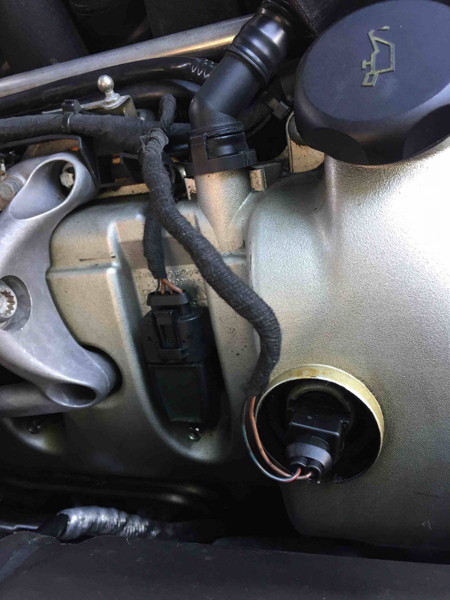

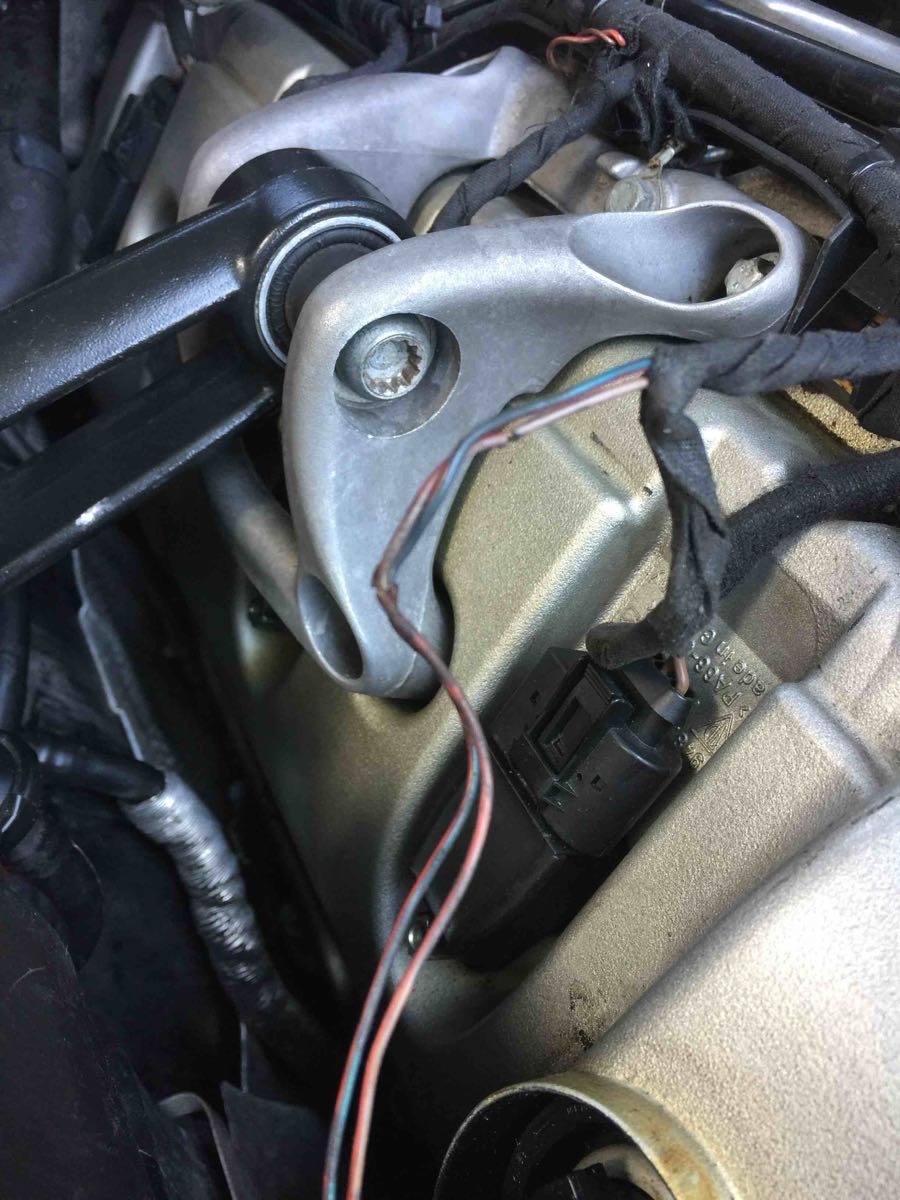

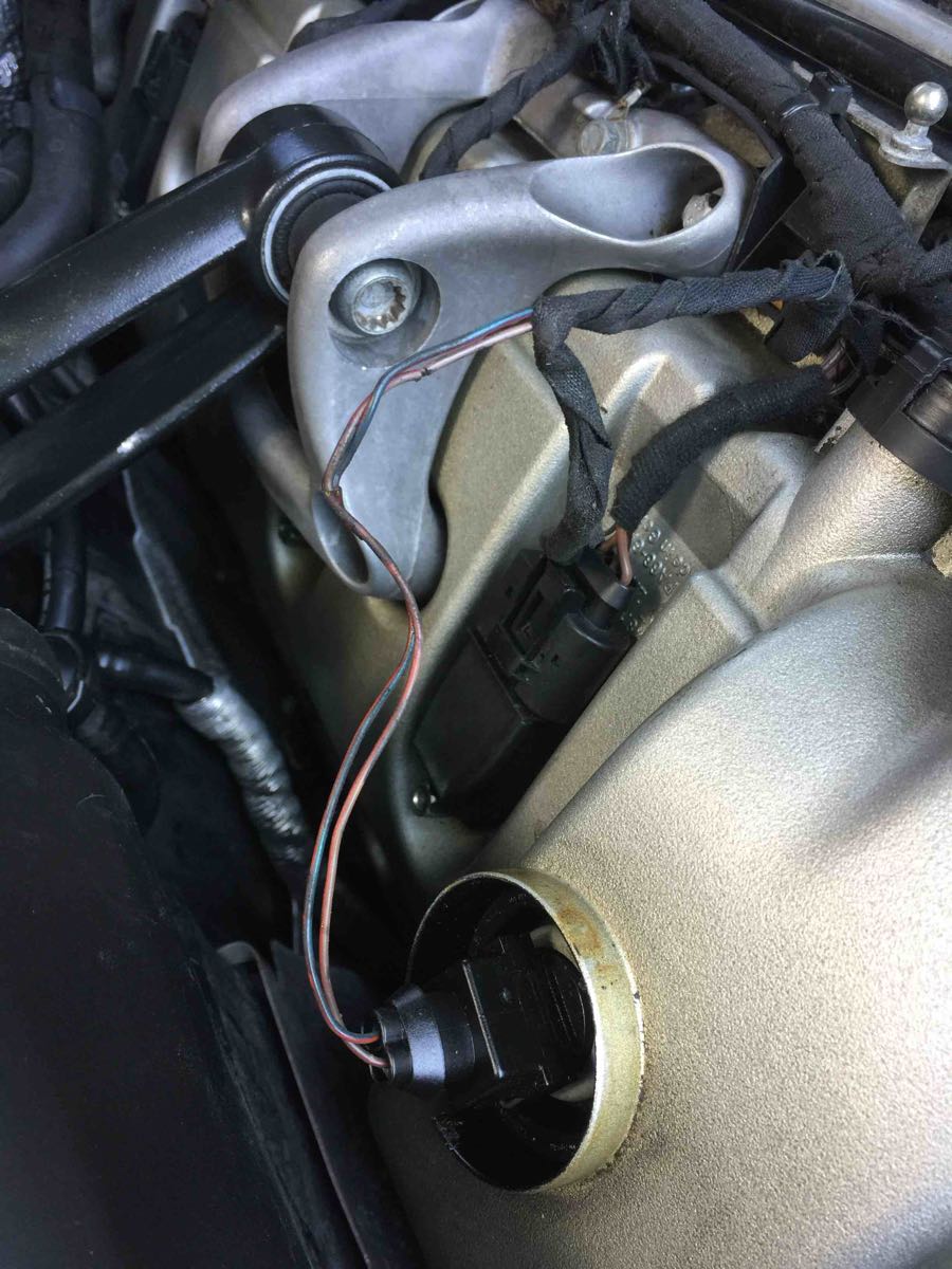

As some remember maybe I had continuous fault codes with the camshaft sensor/ actuator. Timing on one bank not like it must be. I changed the sensors on the backside of the bank with no result. I was very close now to change the magnetic sensor in the front.
Today I unwrapped all the isolation material. What i found very common already with my engine. Everywhere briggle and broken wires.
Everybody with continuous faut codes should really check the wiring in the engine room. Now after 10 year almost everything in a very bad condition.

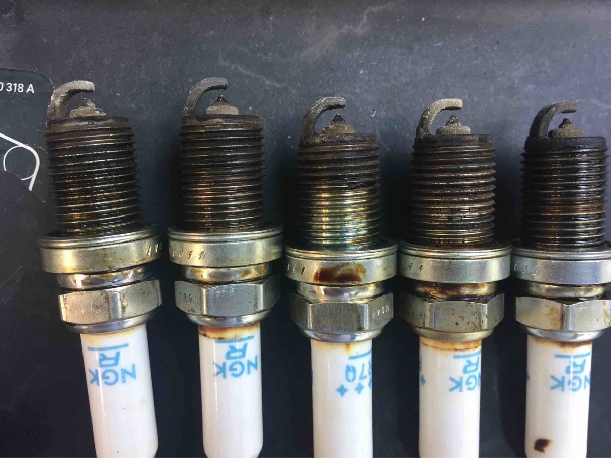

When did you you take out your coils last time?
There is a gasket under the valve cover for the spark plugs. This is becoming very brittle over time. Oil is flowing to the tunnel where the coils are. This could cause a smell when engine hot.
Thanks guys - I'm due a tune up, realized I have put 40,000 km on it since I bought it a year ago! Will pull the plugs and coils and check the area for oil. But it is strange that the smell is strongest through the vents, and only on certain settings and/or when braking or accelerating. When I smell it I have stopped and opened the hood, catch a bit of the smell, but it is not as strong as in the cabin with the fan on. I can see how it would get sucked in the air vent, but it is hard to trace since I am always driving when it happens. But I should do my plugs and MAF's anyway.
And Hand Wash Only!
  • 3 weeks later...
Did you ever figure out where your oil smell was coming from Thomas? I can't, and it is getting worse. Every time I go over a sharp bump like a curb into a driveway the vents blow a really strong smell of burning oil - nobody wants to drive in the car anymore! I thought it might be the oil that collects in the cam adjuster caps that splashes out, wasn't that; can't see any stains on the headers, and even though the valve covers are a bit leaky, it's just damp and has no drips or anything major that could splash. Cleaned one side with engine cleaner and now it just stinks of burning oil and engine cleaner...
Pulled the plugs btw and they looked very good - gap had widened a bit so I just tightened them up, cleaned them and put them back. Cleaned the MAFs and its running smooth again. Stinks, but smooth.
