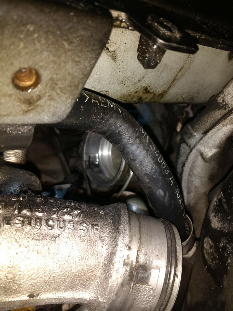

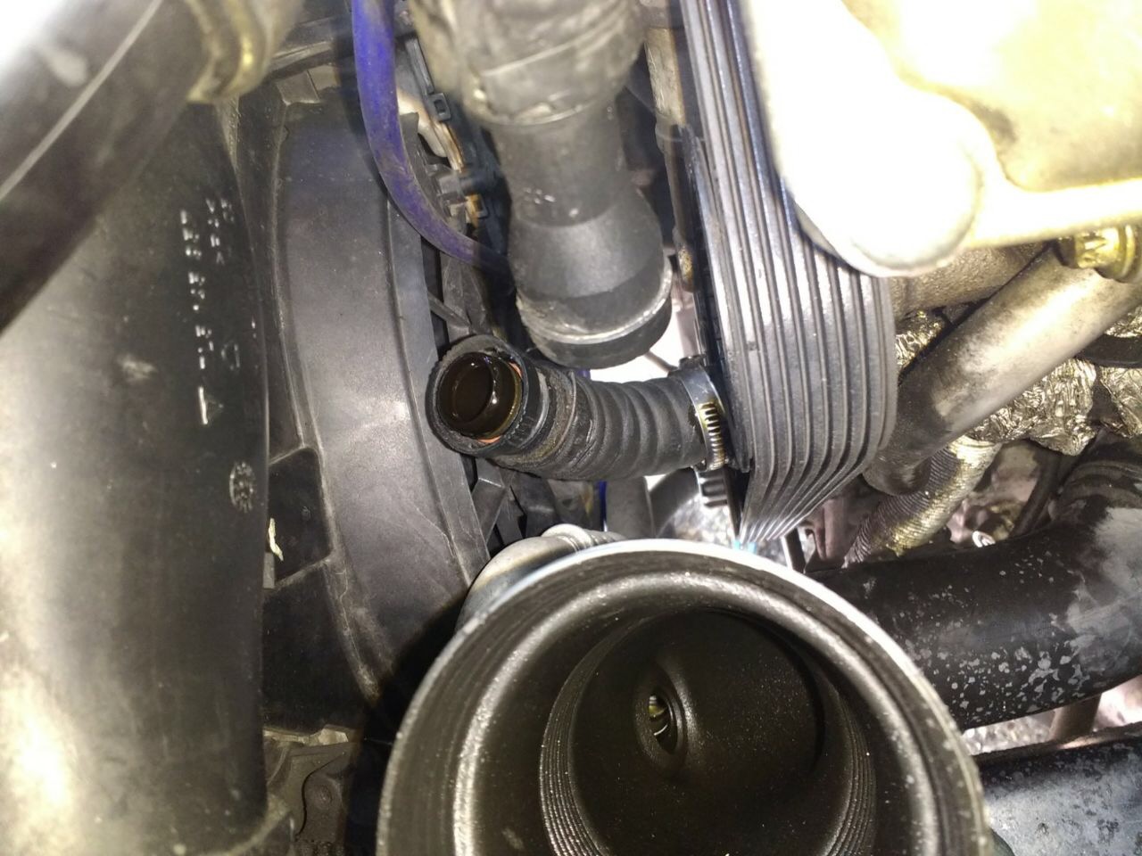

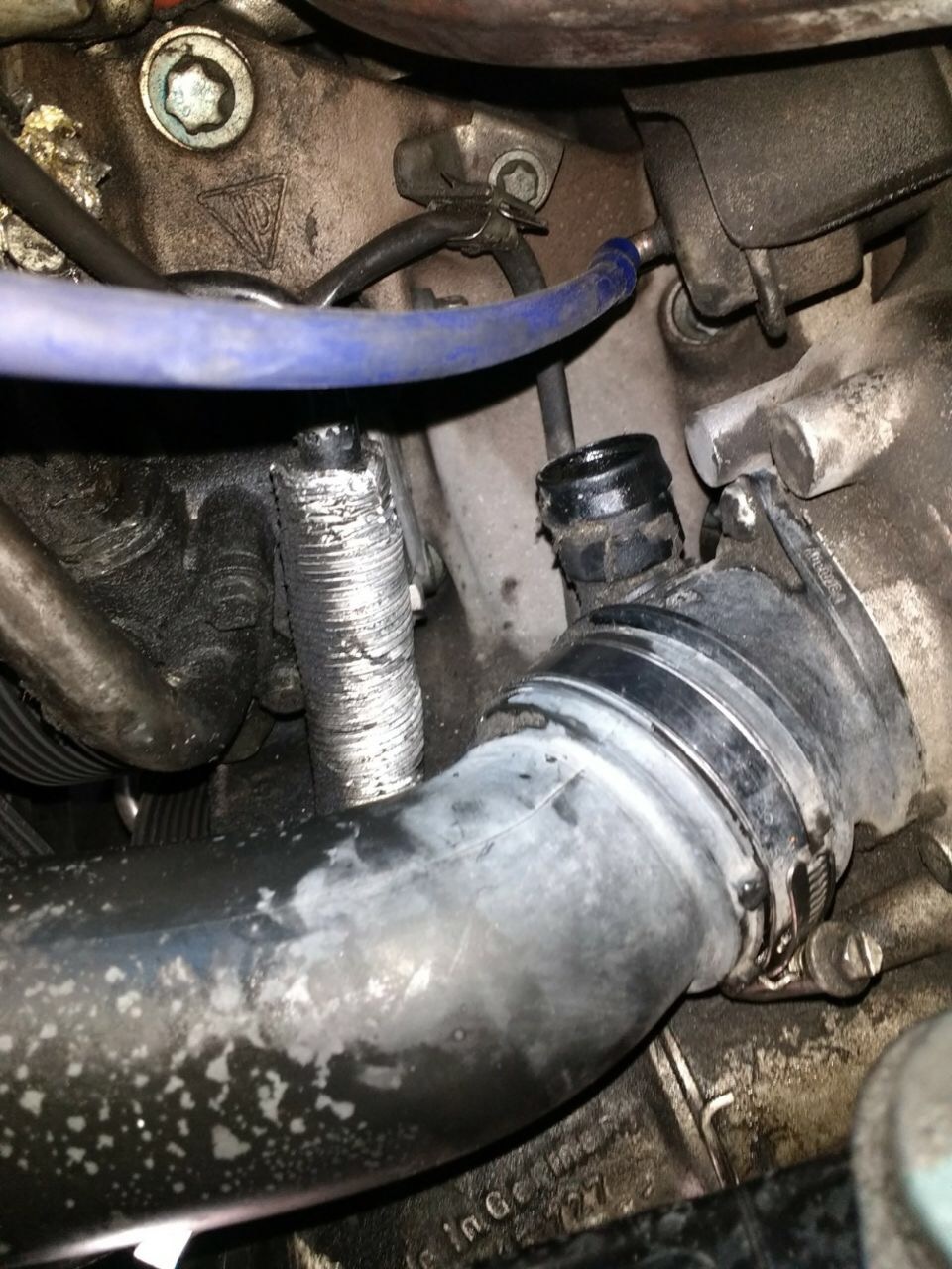

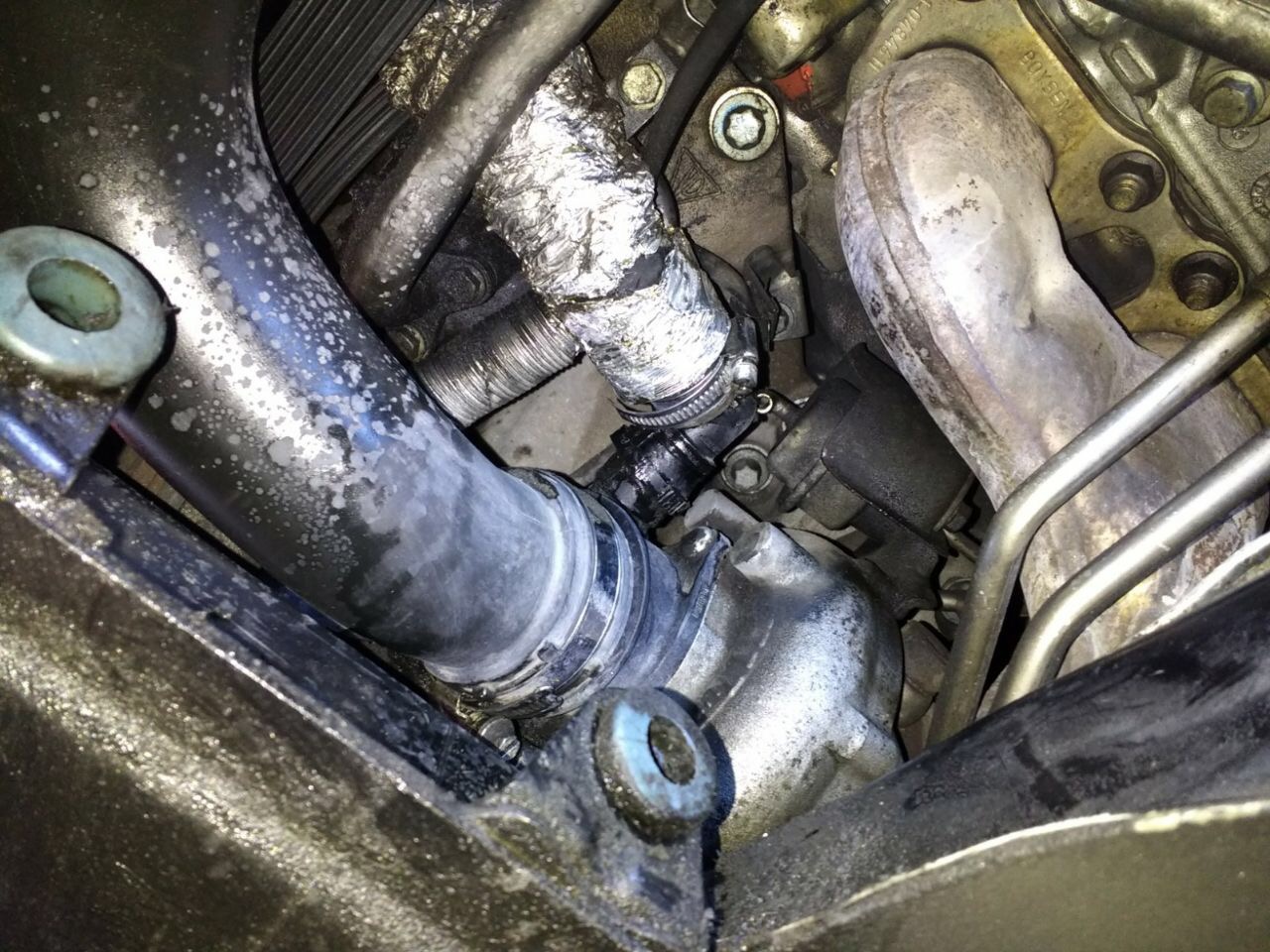

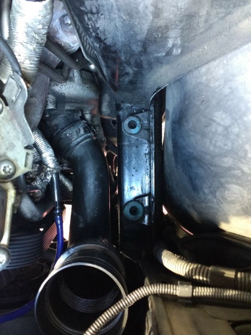

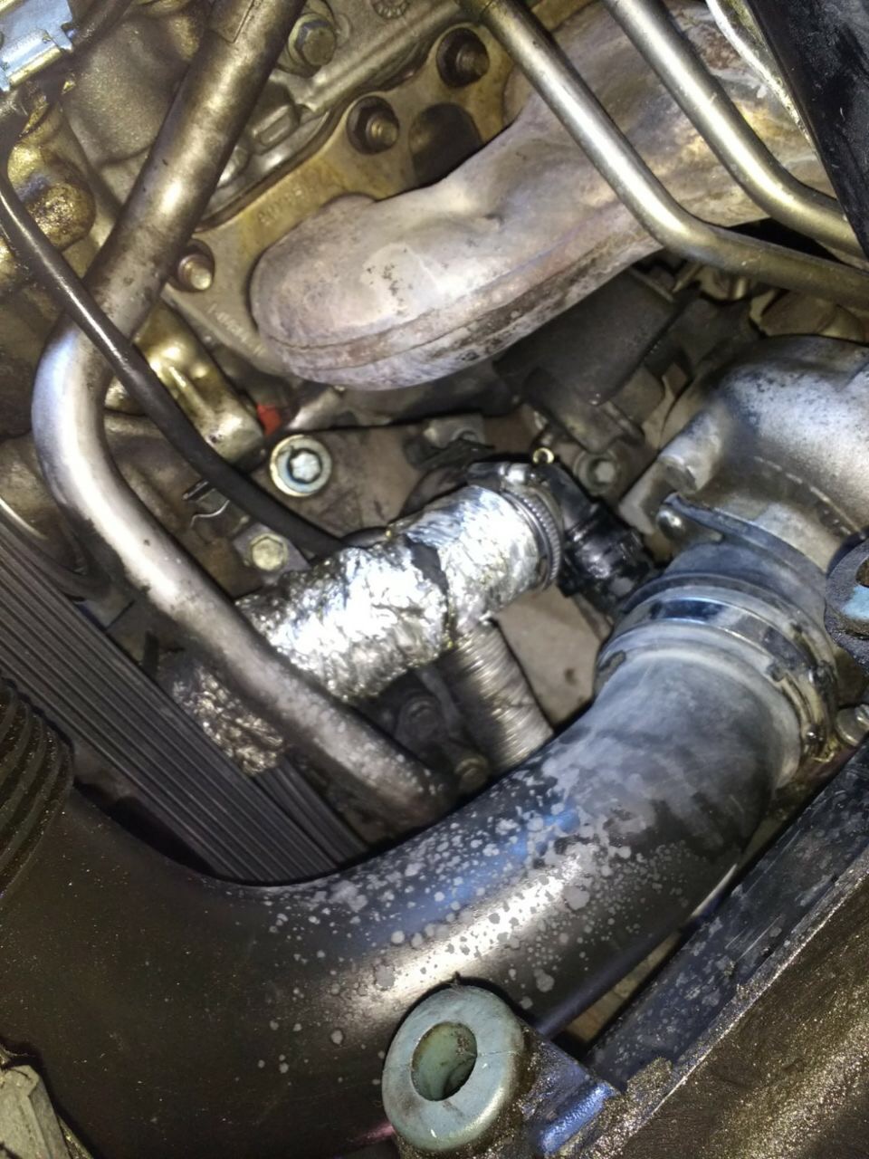

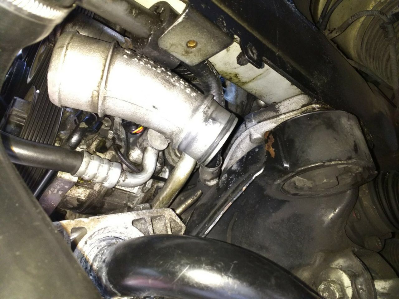

Major work on the drivers side Turbo.  I can see that there was already some "specialist" working here.
Take away air filter housing to get access. Take away tube with the MAF.
Changed the o ring between the metal hose and the charger
Edited by ekstroemtj

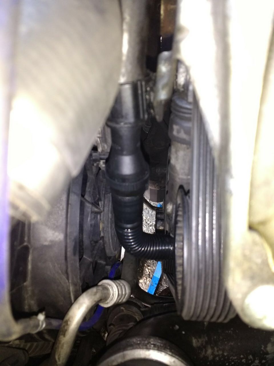

Changed the pressure hose to the wastegate. New blue silicon line.
Changed the tube which is going away from the turbo housing in direction to the belt. No. 15 on the diagram
there was already a damage and previous owner fixed it in a very special way

Reason found. The clip which is fixing the small metal boost hose with the turbo housing became loose. Hose wasnt fitted very tight than. Big leak.

Repaired but i found it really difficult to fix this. To place this spring on the right place. Very tight everthing. Cleared codes and testdrive. Everything ok. I am again suprised how different the shifting is working without a boost or vacuum leak
