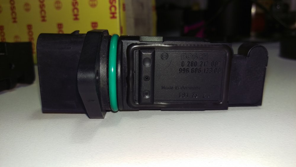

Sorry didn't see that pic, I was looking on my phone last night, I'll wip mine out and check the number.
