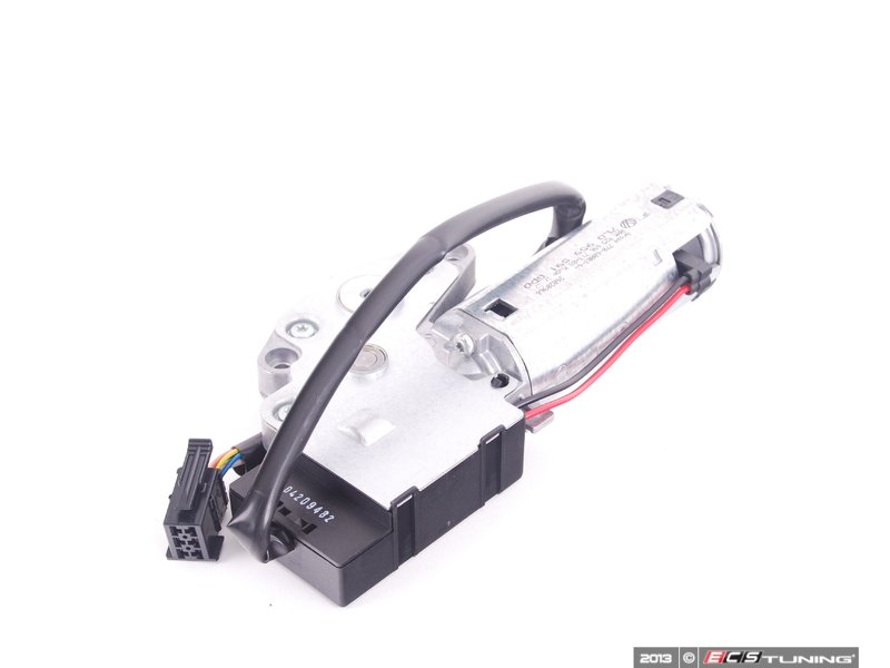

I believe that #5 is the little motor for operating the roof:.
If so, it is under the headliner, and the motor retails (US) for around $350.  Here is a complete roof parts break down: Cayenne roof
