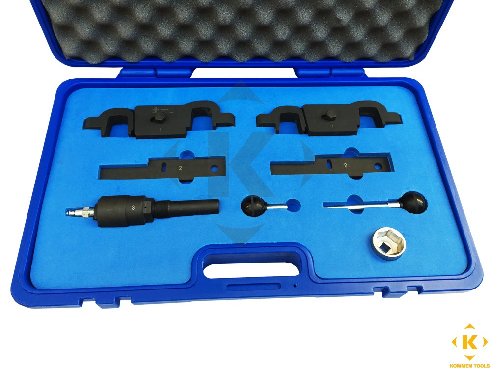

I'm sorry, but along with a lot of specific knowledge about this engine, you are going to need specialized tooling, such as the Cayenne camshaft timing tools to do this type of repair:
And these tools are both quite expensive, and have only one use, for setting valve, cam or VarioCam timing and also requires a regulated air source between 5.0 and 5.5 bar to complete the repairs.  This is well outside what I would suggest is a "do-it-yourself" type repair for someone that has not done it before, or had special training on this engine.
Rado.... Please take the advice of the guys writing to you serious. This codes which you have and the problems your car is showing you cant solve by yourself. To serious. To difficult.
