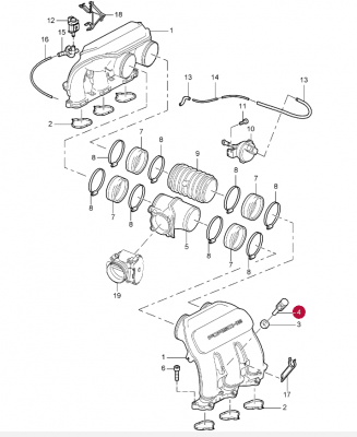

In the engine compartment, mounted on the intake manifold, is the temperature sensor for the fan:
It is possible that this sensor has either fallen off its mount (common) and is laying on something hot, or is going bad.  I'd start there.
Check your engine temp sensor. It may have fallen off and is laying on top of the engine.The sensor is between the intake manifold runners for cylinders #4 and #5. Right side of the engine compartment.
I've looked for the sensor in the area you described and there is nothing between the intake manifolds for cylinders #4 and #5.  Is it possible not even and sensor "holder" is there? Does a holder for the sensor exist?  I'll take it back to Porsche and ask them to "test the sensor" for me.
A little background on the car FYI.  I purchased the car CPO'd in Dec 2015 when it had only 5k miles on it.   After 3 weeks and 1k miles, the car had two problems I noted.  One was the fan issue and the other turned out to be a badly scored #6 cylinder (excessive oil consumption and badly sooted left exhaust tip).  In my concern about the cylinder issue symptoms,  I failed to mention the fan issue when I brought the car in for service.  As it turned out, Porsche replaced the short block under warranty and the car runs fine but I still have the fan issue.  I did bring the car back for a summer tire change and it was then I was told the fan was operating normally.    Given the lack of a sensor in the area you described, it seems to me it probably wasn't there at time of purchase and overlooked when the new block was installed.
FYI, the purchasing Porsche dealership who CPO'd the car is different than the servicing Porsche dealership.  So if correct, both dealerships missed the lack of sensor when doing some serious maintenance work. (CPO and a new short block).   Thanks for your help.
The holder for the sensor is a rubber grommet that slips inbetween the manifold runners the sensor slips into the center.  Nothing exotic, but it is essential.  Look under the intake runners for both the sensor and the grommet, they are both very easy to knock loose.
Oh never mind. Saw it's an '08 now. Look around for an unconnnect plug then. Maybe the sensor was never installed after the engine rebuilt.

This is the temperature sensor location on late model 997-1.
(click to enlarge)
