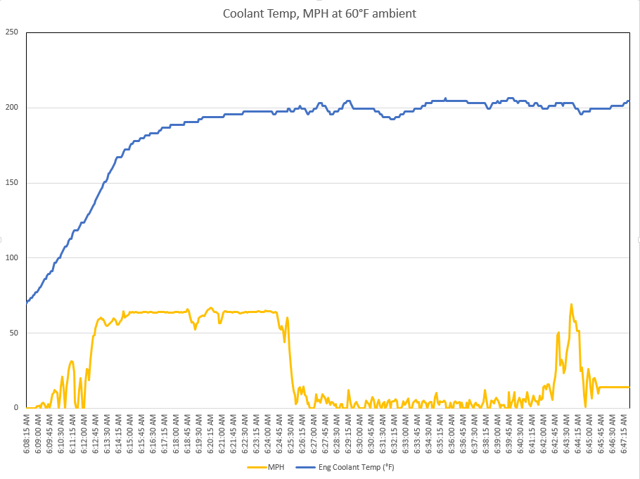

Does this coolant heat up chart look like it's from a car with a low temperature thermostat?
It looks slightly warm, but not by a lot.  I would expect a car with the 160 stat and an otherwise clean cooling system to run 175-185F on a stead state run (copious air flow over the radiators) in 68F ambient temperatures (you also did not mention your ambient during your test).  The same car with the factory stat would run 205-215F under similar conditions.
My ambient was about 65 deg F for yesterday's run.

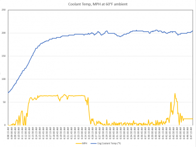

Here's this morning's chart (60 deg F ambient; same route; but one longer episode of stop-n-go traffic) with car speed (to suggest that there is sufficient radiator air flow).
I'm not convinced the tstat is the low temp variety or not defective. Of course, i'm trying to avoid cracking open the coolant system again to replace it - hence my dilemma. But I will because I want the added engine protection of the lower tstat set point.

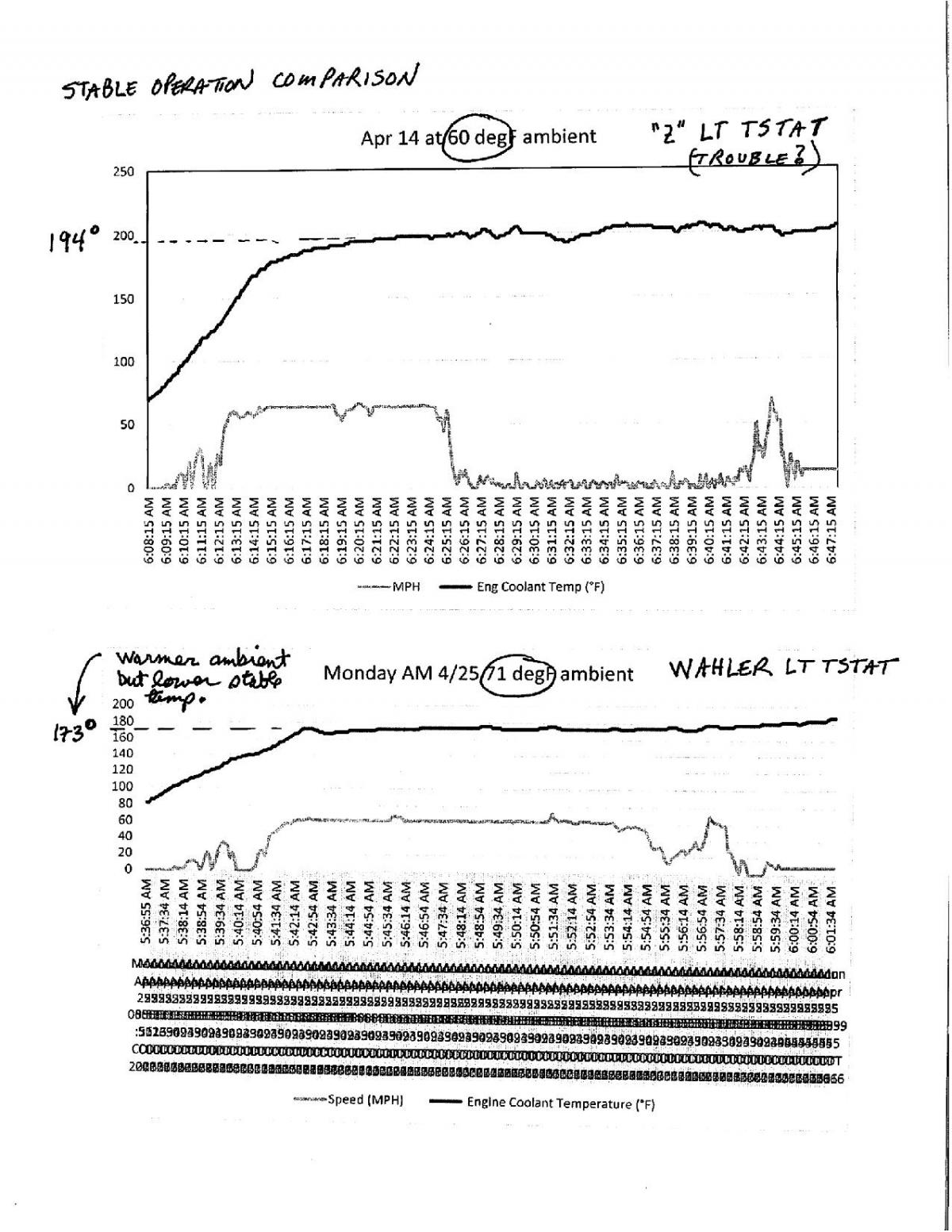

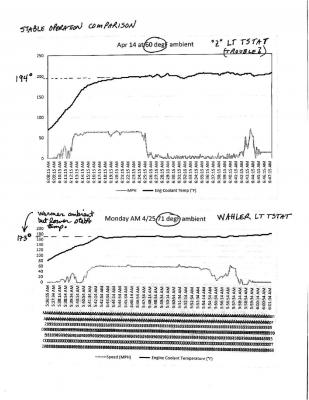

This past weekend I changed out the new thermostat that was giving me even warmer oil temperatures than the original regular temp thermostat.
The new low temperature thermostat acted like I expected to. It gave me oil temps about 8 deg F cooler than the original regular temp tstat. The first low temperature thermostat must have been a dud. Attached is an image of the old and new tstat coolant temp graphs clearly showing the approximate 20 degree difference in the temperature at the plateau (after warmup).
I did boil all the tstats - they did open pretty close to what I read should be expected.
I'm happy it's resolved. I hated to have to spend another half-day to change it out again. I'm hoping it does its job to protect the engine just that little bit more.
Thanks everyone for chiming in.
