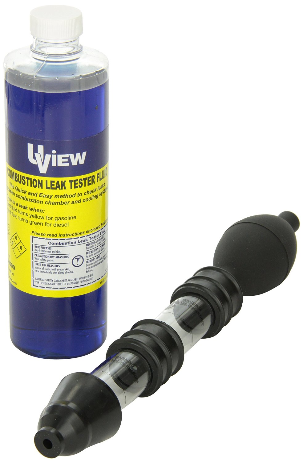

A quick test to either put your mind at ease about the possibility of a major mechanical problem would be to have your cooling system tested for the presence of combustion by products.  This is done by using a special system to extract the vapor above the coolant in the tank into a device that contains a liquid that changes color in the presence of combustion by products:
If you get the color change, something is given way inside the engine and you need to address that; no color change and the problem lies elsewhere.  The test takes about 5 min. to run and is very accurate.

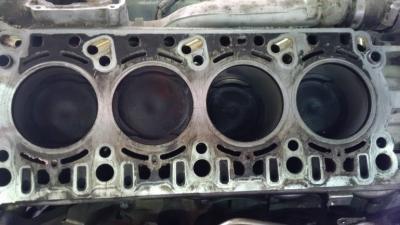

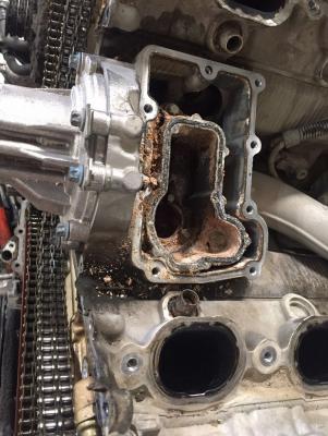

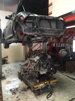

Update is head Gasket failure, I'm buying all the parts now from USA and having them shipped over to uae. Quote
is $6000 parts and labour but I can get that down to 3500 if I buy the parts.
Will also be doing some other PM tasks like transmission service and mountings including the auxiliary water pump. Should be like new after hopefully.
After spending about 5,500 USD I have now have a CTT 2006 (with E81 power kit from new) that has new head gasket, new valve stem seals, machined and skimmed head and newly ground valve seats, new gaskets, temp sensor, thermostat, a load of new pipes fittings vac etc, new aux belt, tensioner, idler rollers, water pump and pulley, cleaned alternator full of oil and sh*t...................I think your getting the picture, total nightmare
