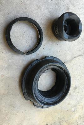

If you replace the rubber strut mounts (I did - one was in 3 pieces) you will want to replace the o-ring (PN N-910-956-01) between the shock and bracket on top of the shock that houses the shock mount. Removing the nut from the strut rod requires a specialized tool or air tools.

I recommend replacing the shock mounts while you have everything apart.
I have 118,000 miles on my 2005 CTT and the passenger side was in three pieces and drivers side was showing signs of wear.

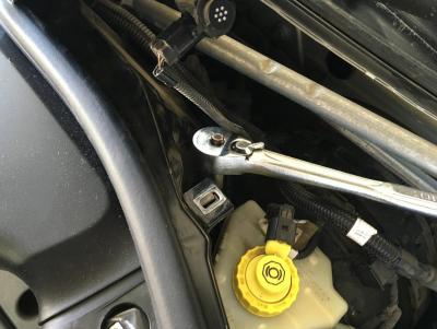

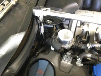

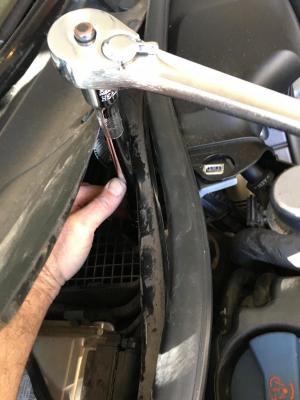

Here are some pictures of removing the hidden bolts in case they help.
Hidden driver's (left) side shock bolt.
post-102552-0-16016200-1456576307_thumb.
Hidden passenger side shock bolt.
post-102552-0-85344300-1456576346_thumb.
Tricky passenger side shock bolt.
post-102552-0-50992300-1456576383_thumb.

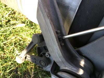

To remove the ride height sensor press this push pin
post-102552-0-60035900-1456576688_thumb.

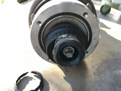

Picture below shows the shock rod nut that requires a special tool or air wrench and the o-ring
post-102552-0-68798600-1456576756_thumb.
