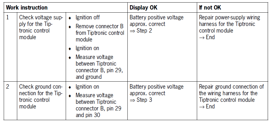

I have a 996 4S With tiptronic, i get error code P1702.
I know what it means, so i need tips on troubleshooting, possibly some wiering Charts?
Somone who has the same problem?
Knut

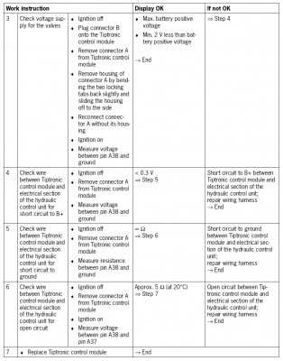

I checked all the wiers, nothing wrong there.
Nr 7 says replace tiptronic Control module.
