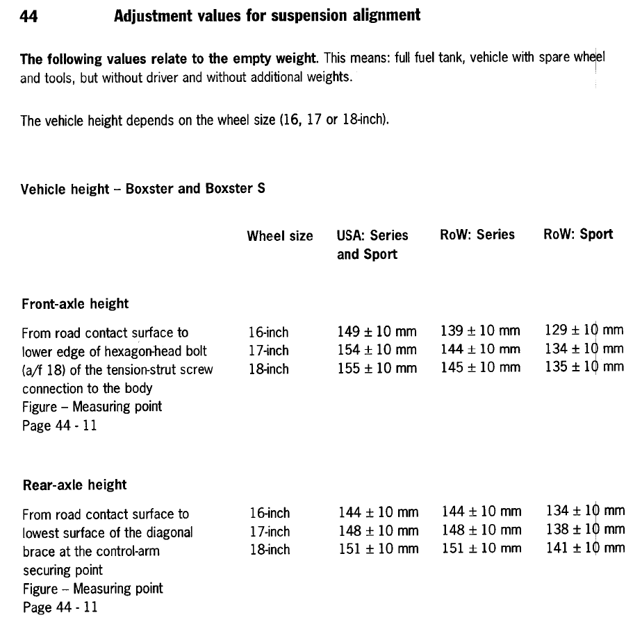

Yes, here is the ride height chart.
(click to enlarge)
The ROW suspension is 10 mm lower than ROW stock.
So on a USA/Canada car that would be 20 mm lower in front and 10 mm lower in the rear.
I guess the marketing info is wrong about being lowered 10mm for USA then
