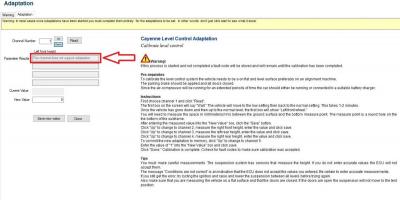

First off, I just want to say I'm a newbie with Porsche and purchased a 2005 CTT a few months ago.  I had to replaced my passenger upper control arm so I just jacked it up with the air suspension at the lowest loading level and took it apart removing the strut (no, I didn't put it in "Service Mode"... didn't realize that this was the proper procedure until after the fact I started search forums to help me with my issue... and in fact, still haven't figure out how to put it in this service mode.).  Anyway, when I put it back together again and drove it around, I get an error saying that my air suspension needs maintenance and notice the height levels on each wheel seem to be a bit off.  I read somewhere that I need to re-calibrate it with the Durametric scan tool.  So I hooked it up and started the procedure provided on the Durametric --> Level Control--> Adaptation window.... but when I click on the "Read" button on Channel 1, it automatically states, "This channel does not support adaptation."  If I try to read any of the channels, I get the same thing.  Is there any other way to just reset everything to just default?... anyone have any suggestions? Thanks in advance for any help anyone can offer.  -Jay

Thanks for you quick response, JFP, but I can't even get that far... when I click on the "Read" button on Channel 1, it automatically states, "This channel does not support adaptation."  If I try to read any of the channels, I get the same thing.  I have a ticket open with Durametric as well... I'm crossing my fingers that this is a Durametric program issue that they can help me resolve.
I used the attach files option as suggested instead.  :huh:
Did you attempt to read other channels as well?  Never mind, I see that you have already tried that.  I would say that the system controller is having issues or for some reason the Durametric system cannot communicate with it.
