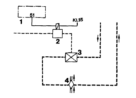

Here is how the tranmission cooling works...
Depending on the ATF and water temperature, the electric switch-over valve (2) is activated by the Tiptronic control unit (1) and allows a vacuum to enter the shut-off valve (3), The electric switch-over valve is activated at an ATF temperature > 85°C or water temperature >90°C. The switch-over valve is deactivated again if the ATF temperature falls below 75°C and the water temperature below 80°C.
1- Tiptronic control unit
2 - Electric switch-over valve
3 - Vacuum-controlled shut-off valve
4 - ATF-to-water heat exchanger
Wow, that´s what I call a quick respons Loren! Thank you.
Just to be sure…my interpretation of your answer is:
The vacuum filling process also require to pull out the fuse B-1 as the electric switch-over valve shall be off so the shut-off valve can be open, as the water temperature surely would be below 80°C when filling. The ignition shall simultaneously be switched off during filling.
Right!?
