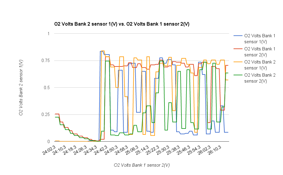

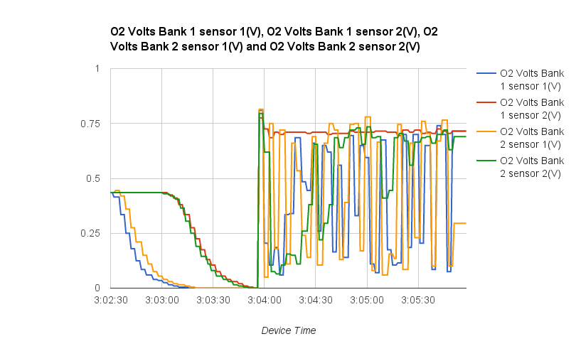

Here are the O2 voltage, fuel trim and RPM from a cold start this morning.
I did not get the chance to log after a warmed engine.
I saw that the Catalyst and EVAP monitor is already back at the "Ready" status after 2 drive cycles.
SAI remains incomplete.

The plots look fine to me. A log during drive would not add much info but Durametric read out of FRA and TRA will give us more clues about the 1128/1130 codes.

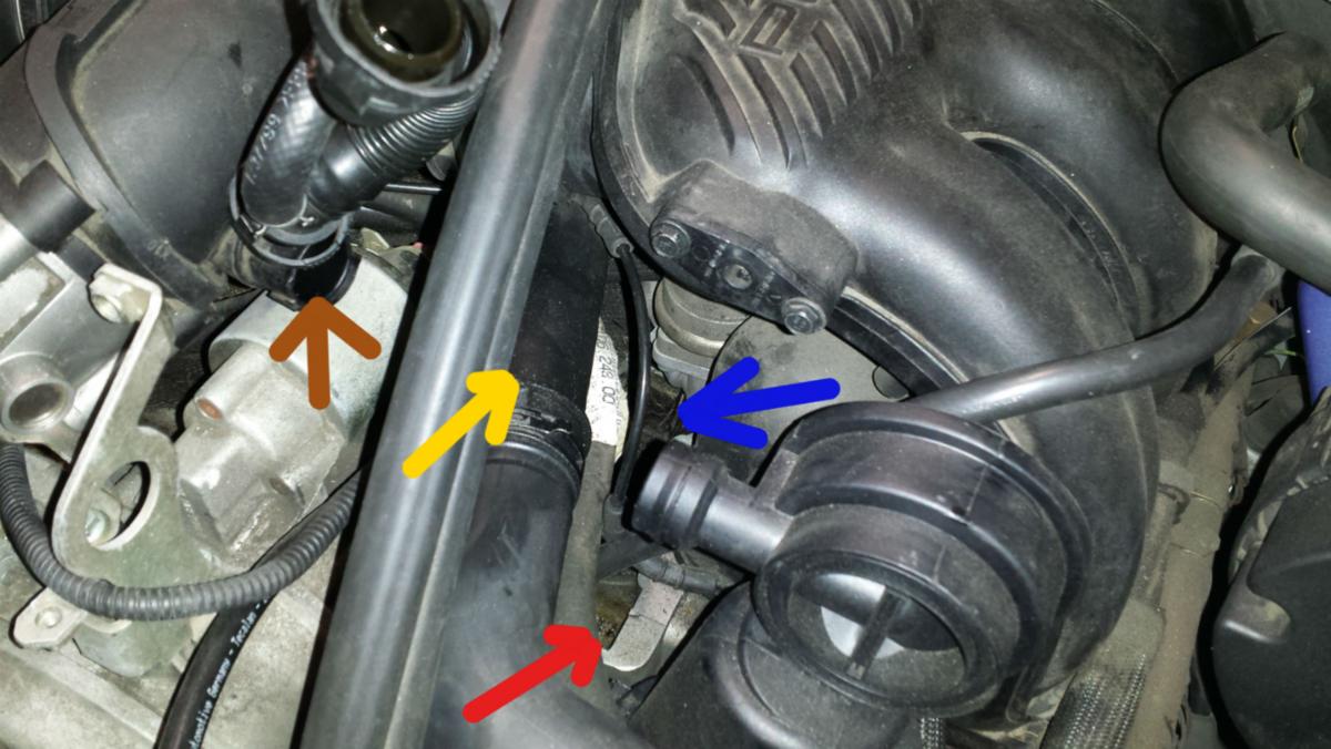

I popped off the AOS's j-pipe and found small amount of oil on the TB side.
Also I saw some oil mark on top of the oil filler pipe and some small area of oil on the top of the engine beneath the oil filler pipe.
On the left picture, you could see the red and blue arrow pointing to the oil on top of the engine.
Yellow arrow pointing to oil on top of the oil filler pipe. Brown arrow is just pointing out the oil found at J pipe
What is that part with the red arrow pointing to on the right side?
post-104899-0-88340000-1455257942_thumb.
post-104899-0-43585200-1455257945_thumb.
Edited by Rochan

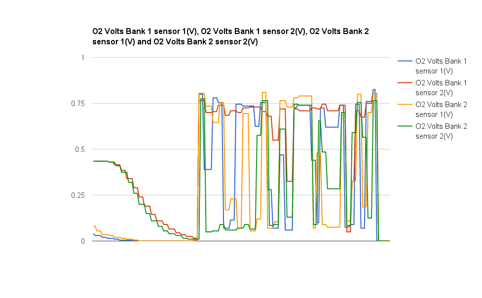

I am still experiencing the SAI still being in the incomplete status :huh:
Here are the O2 readings from three different cold start:
2 in the morning and 1 in the evening after work
post-104899-0-55549600-1457132305_thumb.
post-104899-0-46224900-1457132306_thumb.
post-104899-0-05470700-1457134361_thumb.
Edited by Rochan
Plots look good. I think it's time to visit a shop to force the tests.
