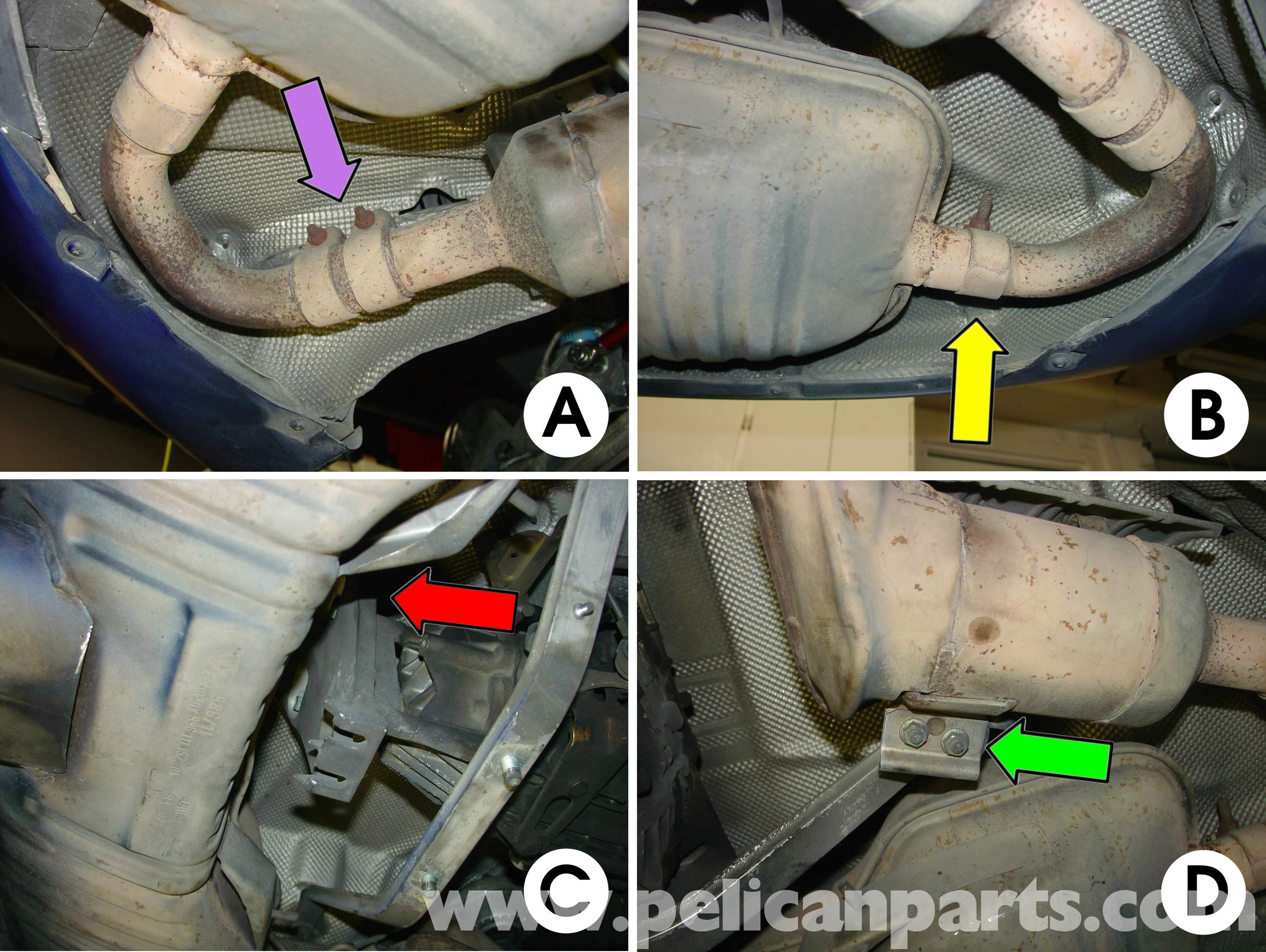

There should be heat shields above sections of the exhaust, which may not be entirely visible with out the car on a lift.  As these shields are relatively close to the exhaust system, a leak could be coming out and blasting against the shield, which can make a rattle like sound.  You can see several of them (quilted looking metal) in these photos:
Again, you need to get this car up in the air and have a detailed look.
