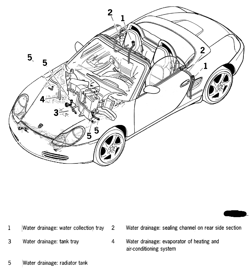

I've read a lot of vrry useful submissions on this topic. I've had my 1999 Boxster sjnce Oct 15, bought complete with interior swimming pool!
To date I've unblocked front drain tubes, repaired a tear in a rear drain tray and repaired leaking door vapour membranes, all of which have greatly improved the situation.
I'm now left with a wet floor at the front of thd driver side footwell.
I can't find the A/C drsin tube from the drawings and photos I've seen so far. Any furthrr info woild be great. Also not convinced it is caused by the A/C drain being blocked because I haven't been using the A/C much. Lots of rain here recently.

Welcome to RennTech :welcome:  The AC drain is accessed from beneath the car:

The AC drain tray is part of the heat and AC box assembly under the dash (this a US diagram, so yours would be reversed):
I believe the condensate tray is sealed to the heater box itself and not to the body.  You may need to get in there and have a look at where the moisture is getting out.
