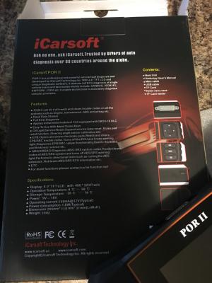

After many weeks of frustration with the durametric and paying shipping for their faulty product I returned it. Now several months later I figured why not try this icarsoft, the newest version that claims it resets oils reminders and service reminders too, both which I was never able to get the durametric to do even after multiple updates (this is mainly why I bought it). Low and behold I hooked it up today after getting it in the mail and it reset them perfectly first try. It also has a diagnostic mode unique to Porsche in addition to standard OBD II and it ran a Porsche unique DTC scan of all the different systems, my Cayenne responded accordingly on the dash each time the system was being tested (such as parking brake and many others) and I never got an error trying to connect. Quite honestly this is what I expected from durametric all along and it never delivered which did not give me hope for similar systems. I think the older version of the icarsoft did not do the oil and service reset which is why I previously did not give it a second look, but it does now. Here is a picture of the newer, larger unit.
Oh yeah, and the user interface is nice, you do not need a computer to make it work and it seems it can be used on as many makes and models that you want (no limit like durametric). This was not meant to bash durametric as I know many use and love it, but for those that have issue with it like me, or want in my opinion what is an easier to use cheaper alternative then give it a try. You can see from my earlier posts I have no ties to this brand and was truly just trying to find something that worked after multiple fails.
I bought from Amazon only because I had a gift card that covered most of the cost, but they seem to be a little cheaper on eBay, about $176.
The pictures are not showing at least on my end so I will try again. Also notice the nice case, connection cable to update and an adapter to if needed.
