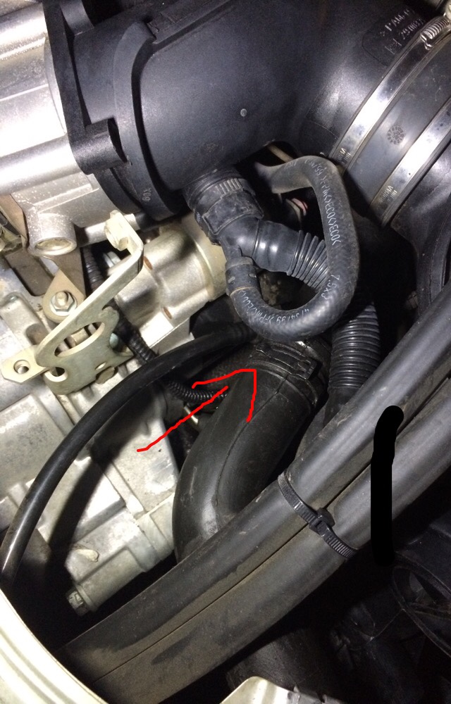

One is a leak I'm getting from the underside of this big plastic tube - not even sure what it is.

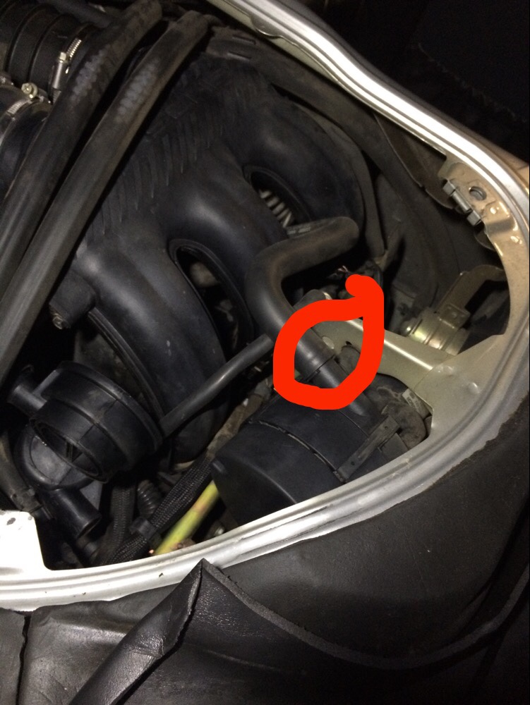

Also it sounds like I have an air leak coming from the circled spot as well. Is there supposed to be a clamp there or is that normal?
Glad to hear you found and fixed the loose connection.
The plastic tube looks like the oil filler tube? If it has vacuum leak, it needs to be replcaed.
The circled part is the SAI pump outlet. I'm not sure but per the parts diagram, there should be a clamp. It shouldn't have air leak though unless the pump is ON.
