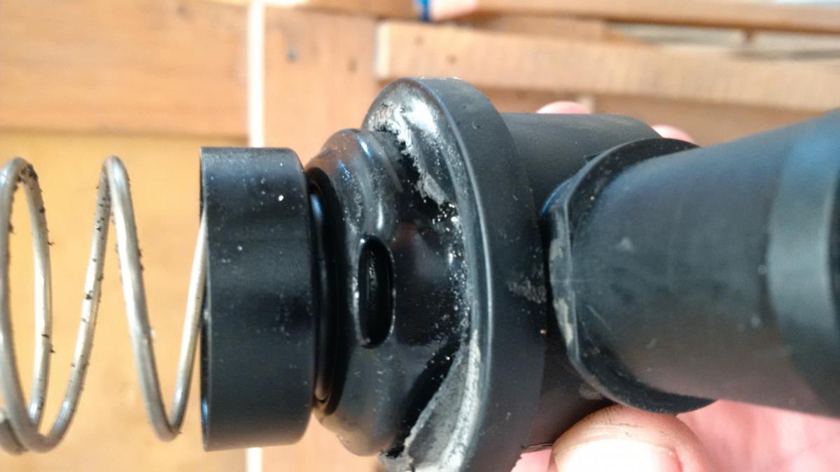

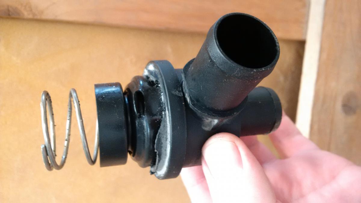

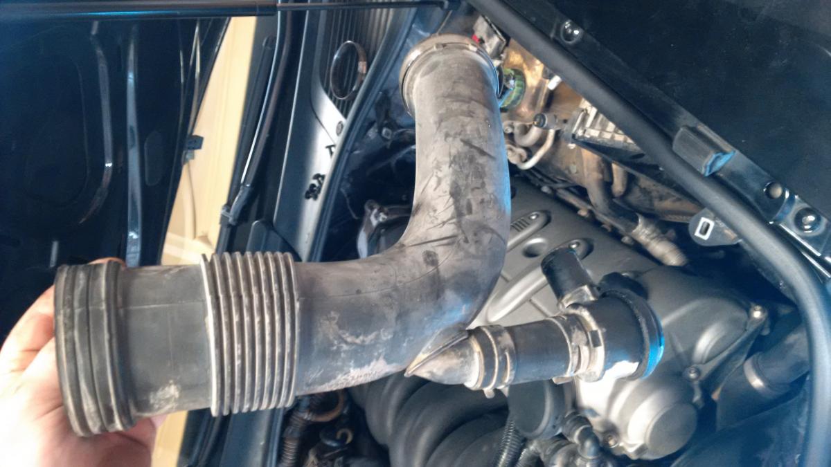

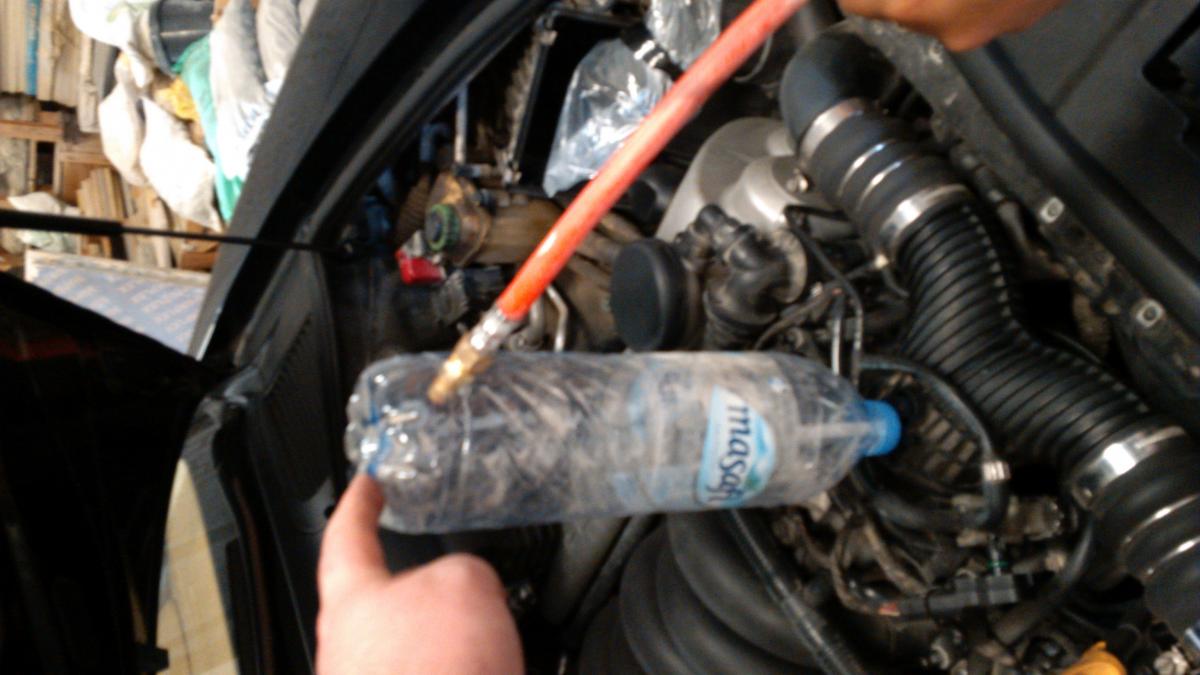

I think I have just cured the lean running misfire stutter and hesitation at varying low rims. Today I smoke tested the intake assembly by blocking off the intake pipes before the maf sensor and putting my hillbilly inspired plastic bottle and cigarette with compressed air injection placed into the MAP sensor hole. Worked a treat but didn't show any leaks.
Whilst I was there I thought to check the vacuum pipes again which I fixed before for the Divertor valves, I was suppressed to find the right side DV was leaking through the vac hose. I removed it and replaced with ne 710 P revision. (the left is I already new and doesn't leak).
So put it all back together and just the short drive home I could feel the car adapting the stutter misfire and smoothing the power out as you would expect it too normally.
Some more driving should learn the dme the right mixture and long fuel trims and hopefully end of the nightmare I been chasing for months.

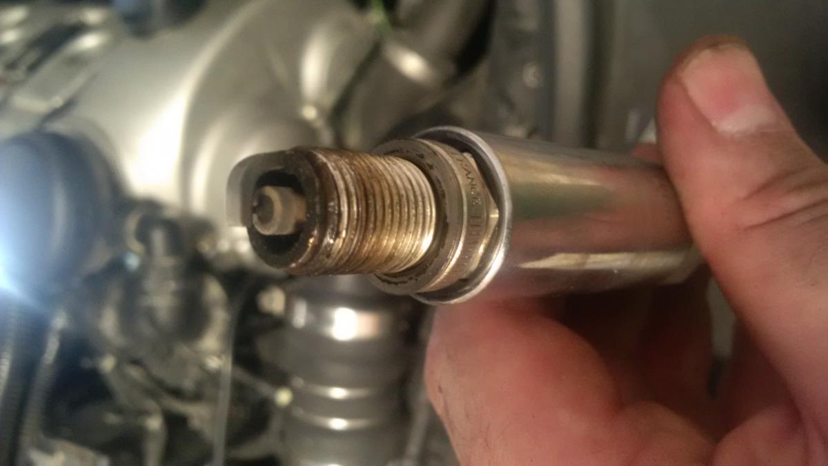

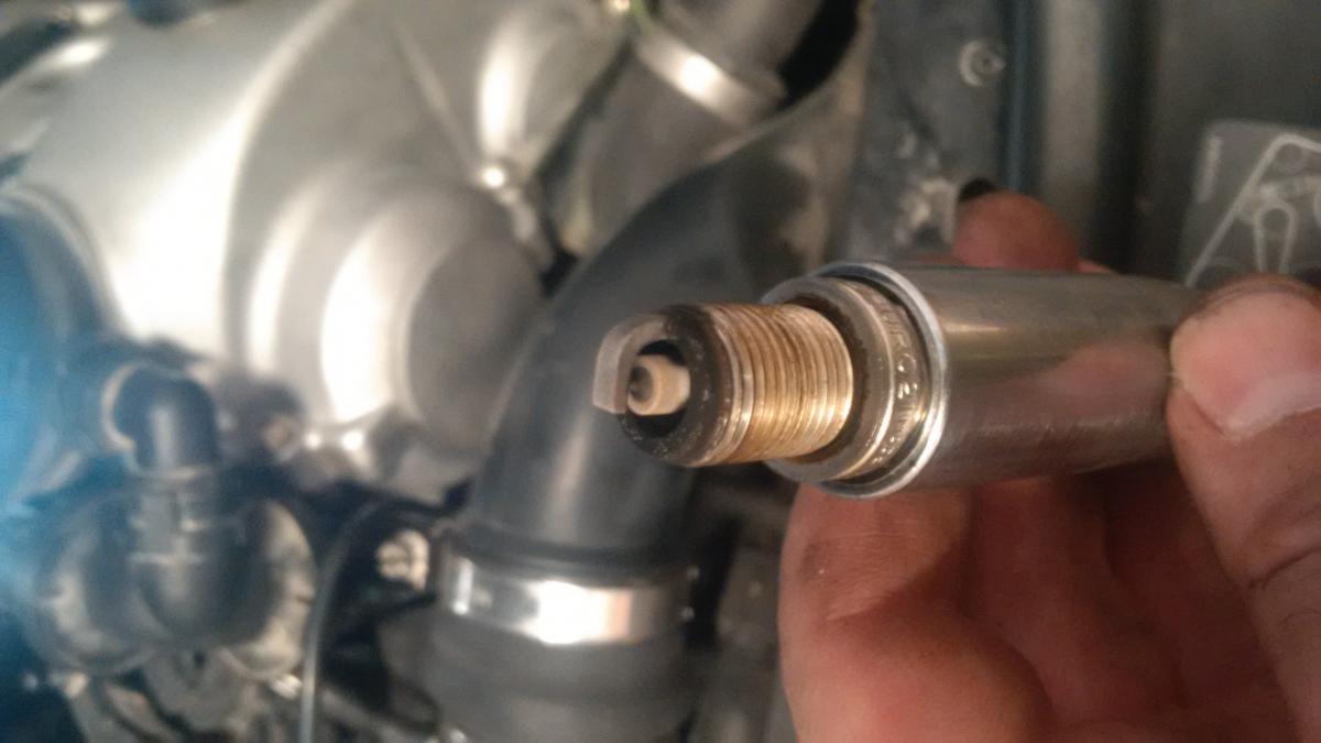

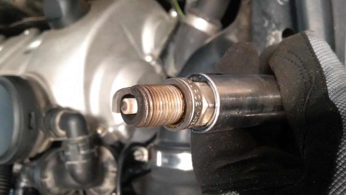

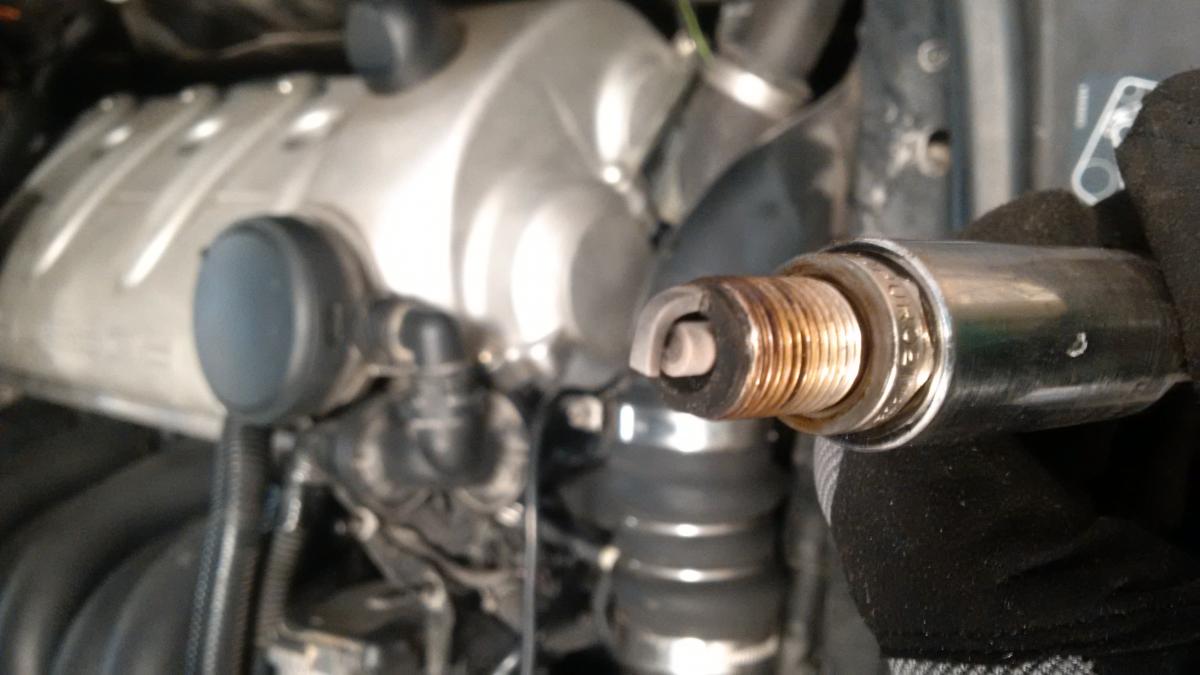

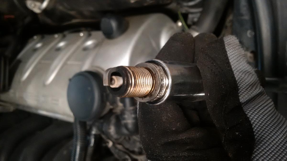

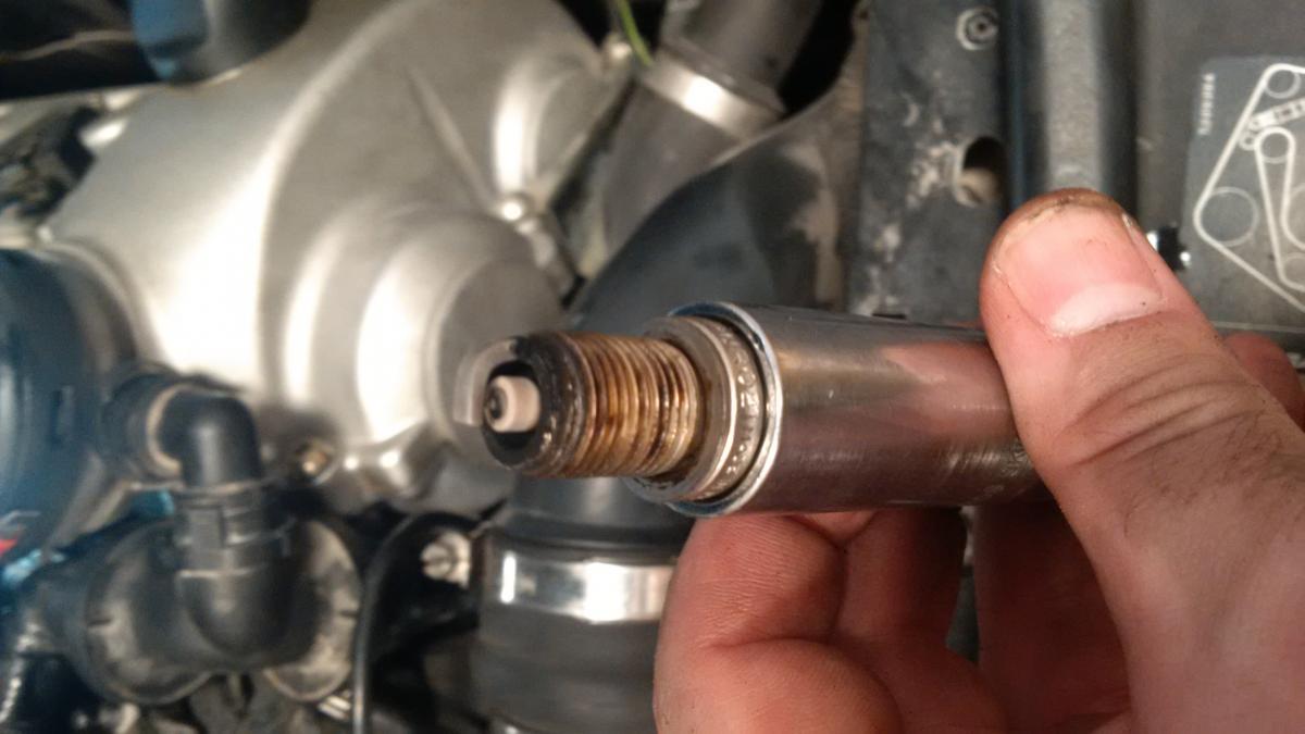

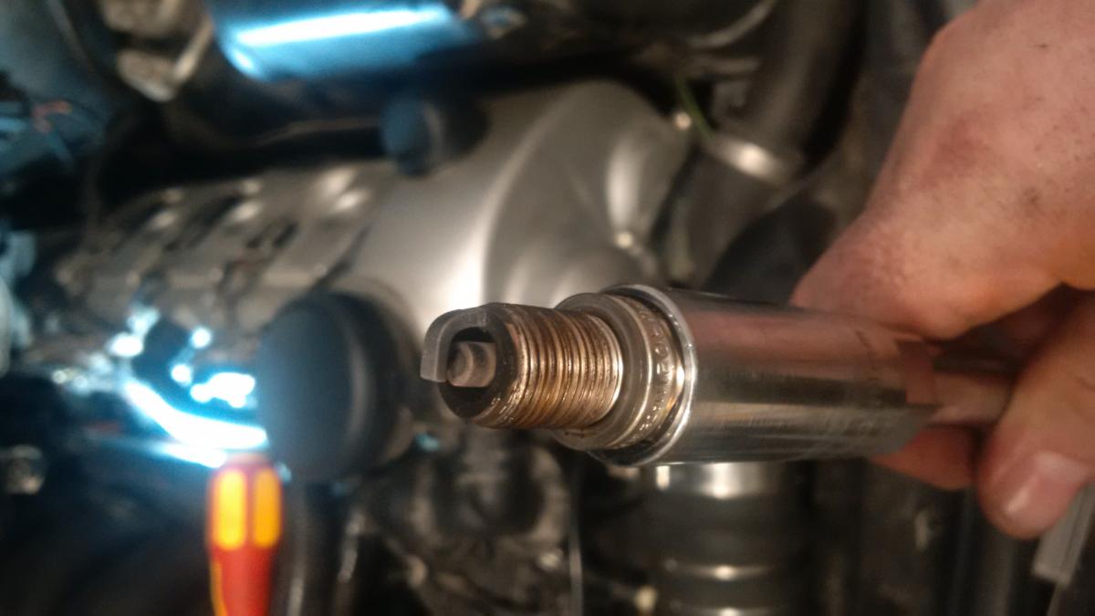

Well guys and gals im still at it. Last few days the car ran as normal stutter, today this morning it ran very smooth, typical! I already made a plan and went ahead today to pull the plugs and coils (both new 2k ago OEM Beru coils revision 21 and Beru 14F-6DRUP021 OEM from Porsche) to check for coil cracks and correct plug gapping using 0.8mm as specified, all in the hope to find something or read the plugs to shine a light on the stutter surge hesitation issues.
see attached the plugs 2-8 (forgot to snap plug 1 but was exactly like plug 2)
To me the plugs look good, black full turn around top thread is good A/F mix, the centre electrode is white/grey as normal, only thing I would say is the ground strap is not showing very obvious signs of timing either advanced or retarded. it look very uniform colour on most and the faintess change on a couple. some website say no colour sign on the strap means plug is too cold, being in the middle east im very reluctant to put a hotter plug in!
Plug 3 had a small browning around the ceramic insulator above the nut more than others did but again not a real issue.
Any spark plug reading experts please do jump in and give your 2 pennies worth. :)

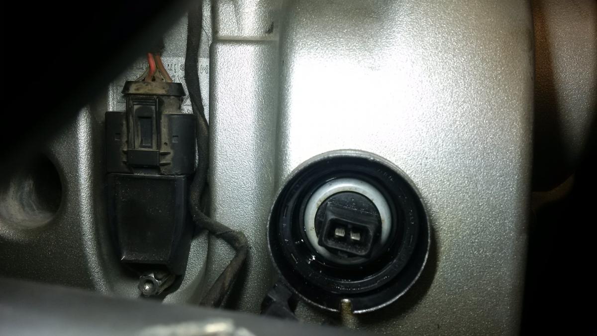

Also note one Picture of the connector of the Actuator Solenoid oring leaking a bit, anyone think this is real issue? Im thinking no, it doesn't drip or run, no fault codes at all!!!
