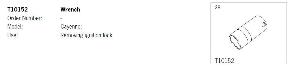

You will need a special tool to remove the outer ring on the ignition switch assembly.
It is VW tool T10152.

Thank you for the prompt reply, do you have any suggestion where to get the tool? I have googled a little and have found only in Europe.
I took the ring out without the tool, will make a tutorial in PDF and post.
